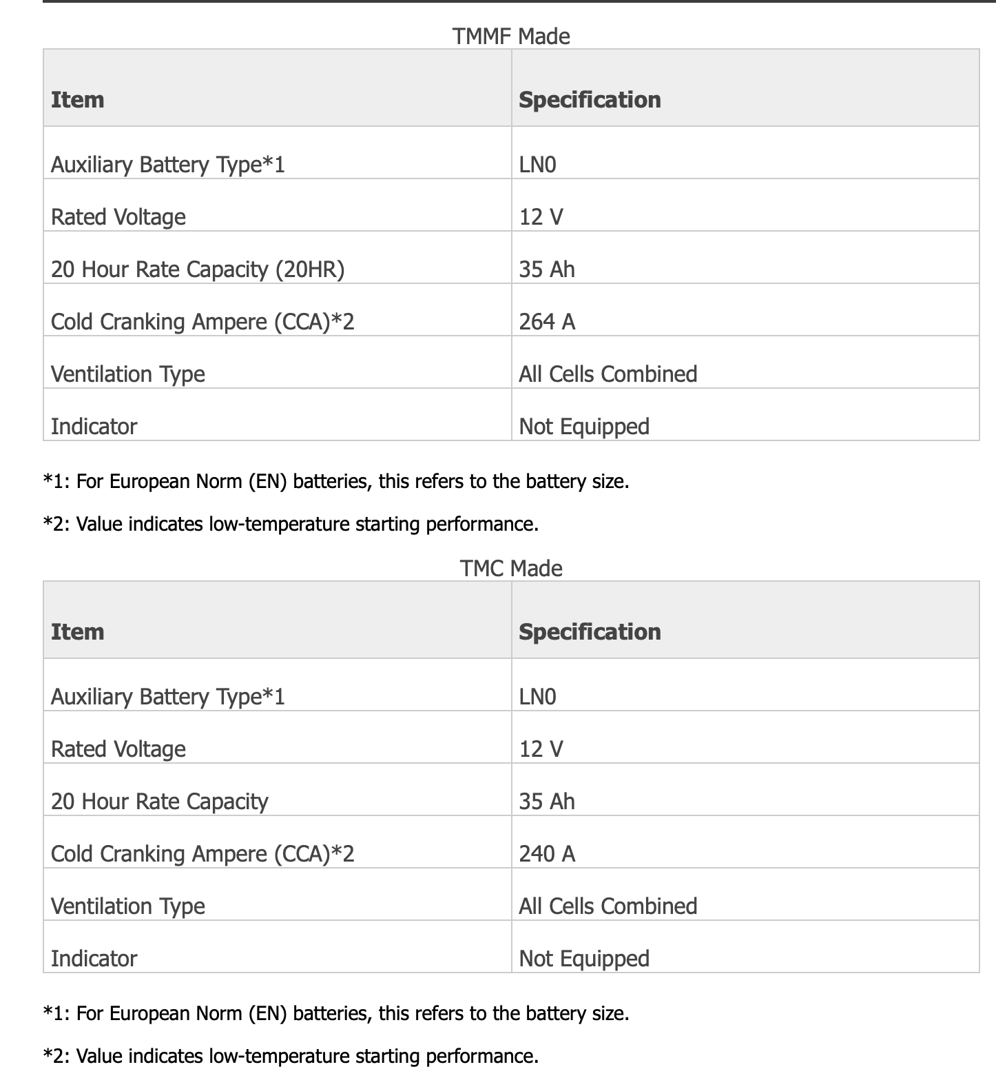

Assuming they’ve pro-rata’d the calcs for the size of the car and the expected draw on the Battery and now I’ve seen that the Battery is identical on an LBX to a Cross, I’m inclined to think Battery quality is as much to blame as parasitic draw.  I think these Mutlu batteries have a yield point where they don’t recover.

I agree
Turkish car Battery has CCA 264Ah. This Battery is supposed to have CCA 240Ah. This Battery is even weaker. Maybe made in Pakistan or Bangladesh. 😉

Turkish car battery has CCA 264Ah. This battery is supposed to have CCA 240Ah. T
You mixed up the unit. It's A, not Ah, as CCA doesn't describe capacity but the top current in amperes in cold weather. Which doesn't matter for a hybrid as they use less than 20 amps. Pure capacity does.
Sorry, I had to go do something!  This is the chart for the Cross which shows both batteries, so yes - Lexus

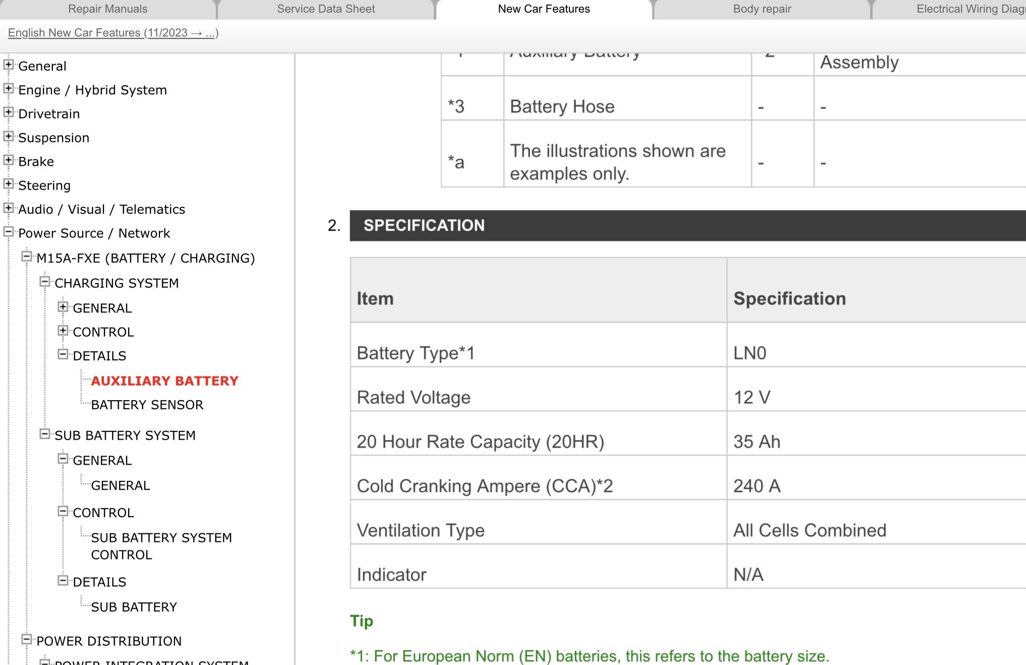

Fair point.  It seems that the specification for Toyotas made in Japan are different from the ones made in France.  A Japanese Cross has a 240Ah Battery just like the LBX and the French made one has a 264Ah battery.  The only distinction I can find is that the 240Ah battery is stated as “with LW package" but that isn’t defined in the terms chart.

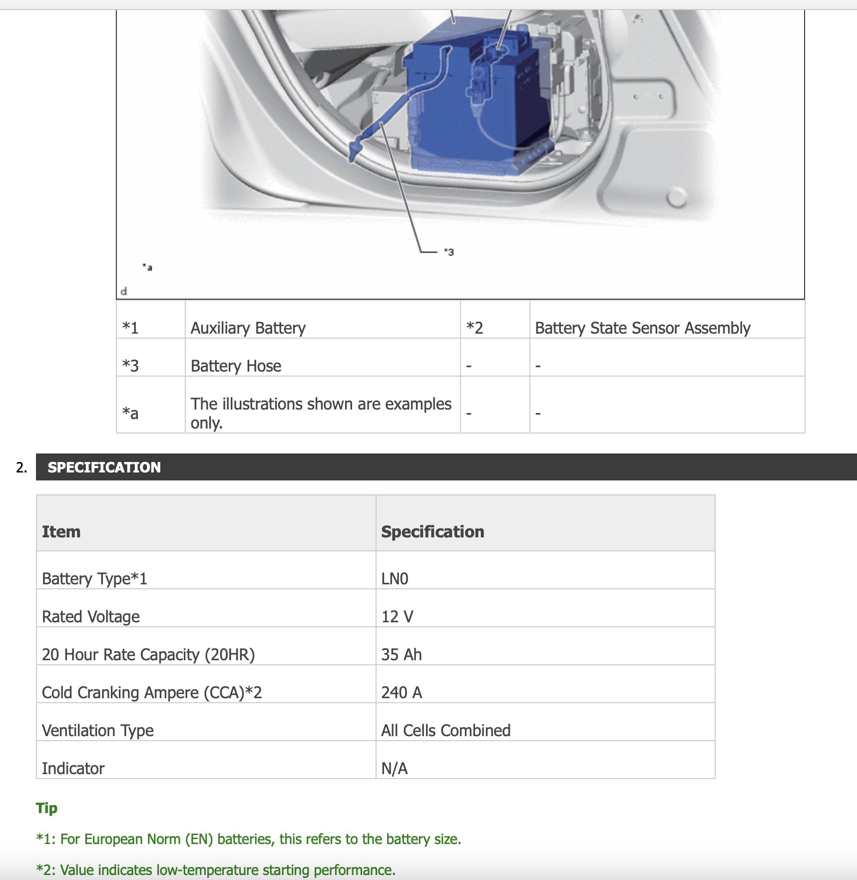

This is LBX
I’m not good at electronics (pretty good at auto electrics) but it seems the LBX system has a capacitor back up Battery.
