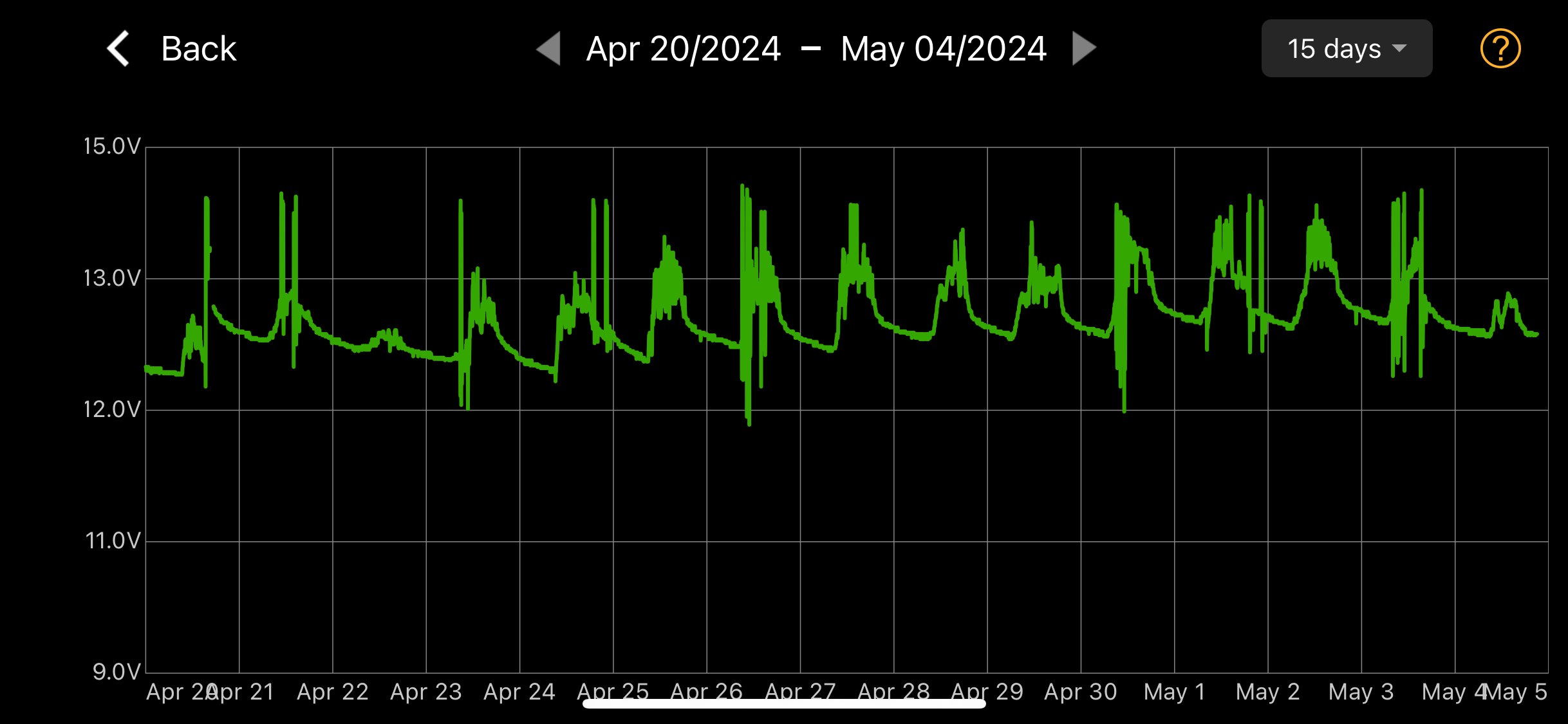

Paul, while we are told 60 minutes ready time is important rather than mileage  and the 60 minutes does not have to be continuous I think there is another factor.
I would term this the quality of the Ready time.
I have noted the there is a steady drop in voltage over time despute a sucession of. 2 mile trips in a week.  The short ready time sees an uptick but the subsequent voltage is lower than it was before the engine start.
I agree your premise the powered off load it to high.
Most of my trips are short so was using a mains charger sometimes twice a week then decided to move to solar charging trying 2x30 watt panels then added a extra 20 watt unit.
Just removed the extra 20 watt unit yesterday.
Todays voltage at 10 PM 12.58 volts
Yesterdays voltage at 10 PM 12.67 volts
All solar panels are going through the same MPPT solar charge controller then voltage monitered on a Battery Monitor.
