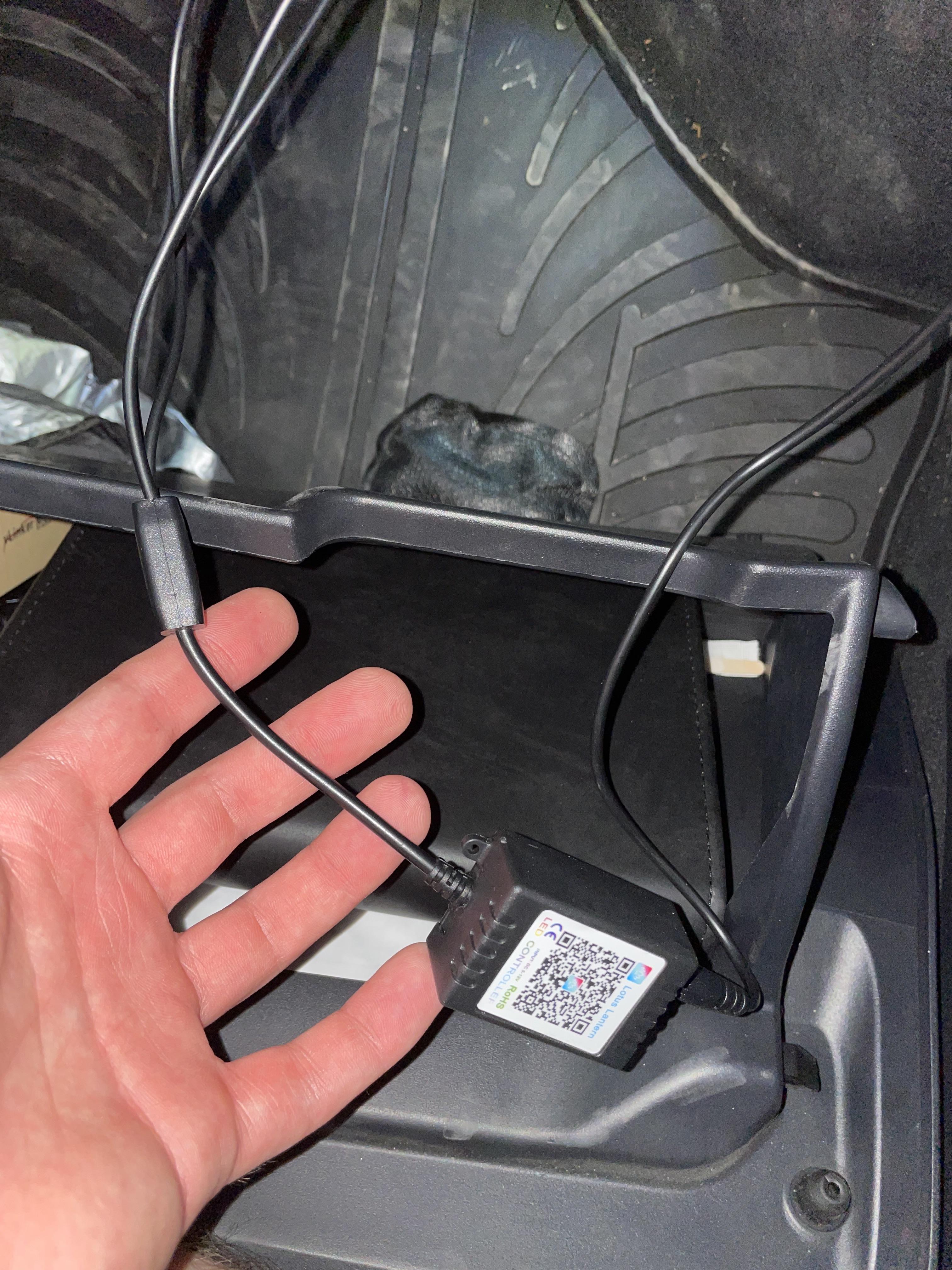

Hello, I have bought this kit https://www.amazon.it/gp/product/B08P4FWJC7/ref=ppx_yo_dt_b_search_asin_title?ie=UTF8&psc=1
and I have installed it from the USB port. Now I wanna to light on when I unlock the car or open doors, and I already found the +/- from the start/stop button (red and black wires).

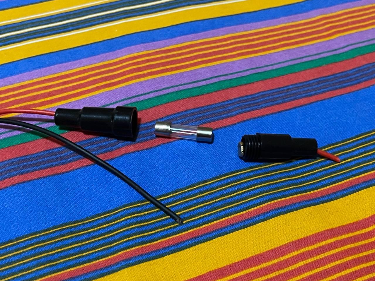

With the USB there are no problems, but now I connected it to the button and the lights (the strip led) are flickering...do I have to join the + without the little fuse (cut off)? Now I have disconnected from the button and reconnected to the USB, everything is fine

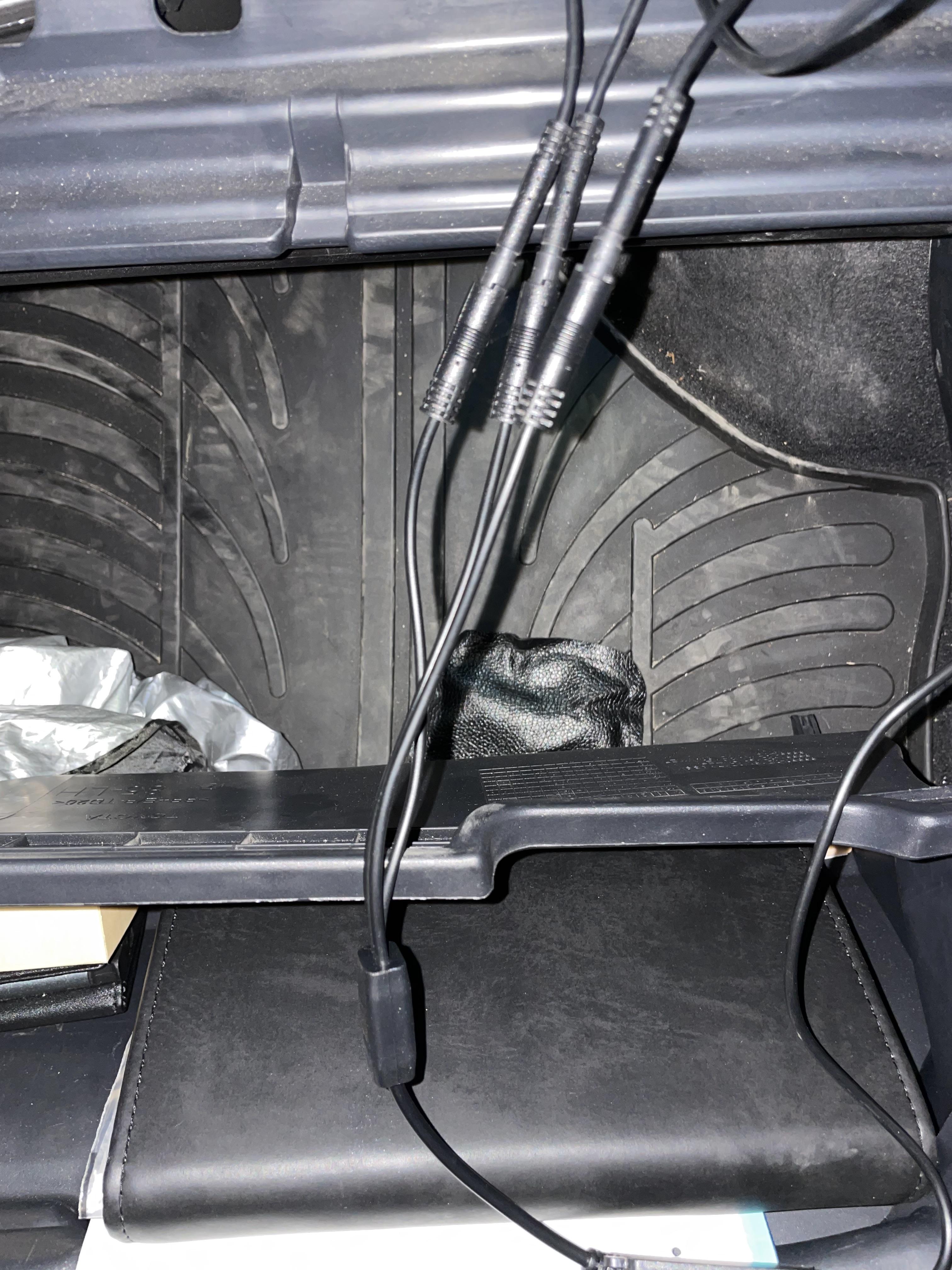

Thanks but not for me, I already have installed the footwell lights
the strips are on the doors panel, I know my wires from the button but the leds flicker...12v, I have to test from a backup Battery if the leds flicker

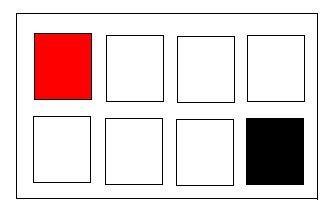

something like this LOL

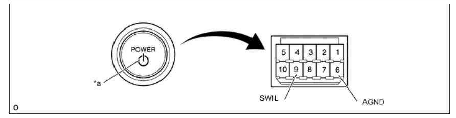

It's a 10 pin - you tapped the button supply from the ecu (red in your pic) instead of the  illumination
View - Socket or wire side of the plug
Socket or wire side of the plug view
uhm, honestly I don't remember perfectly the position of the wires, but with a tester I saw that (with lights on or door opened) those two were the only ones giving 12v, and 0v with the lights off (or door closed)
I'll check the 6 and 9 pin tonight, thanks Bob
