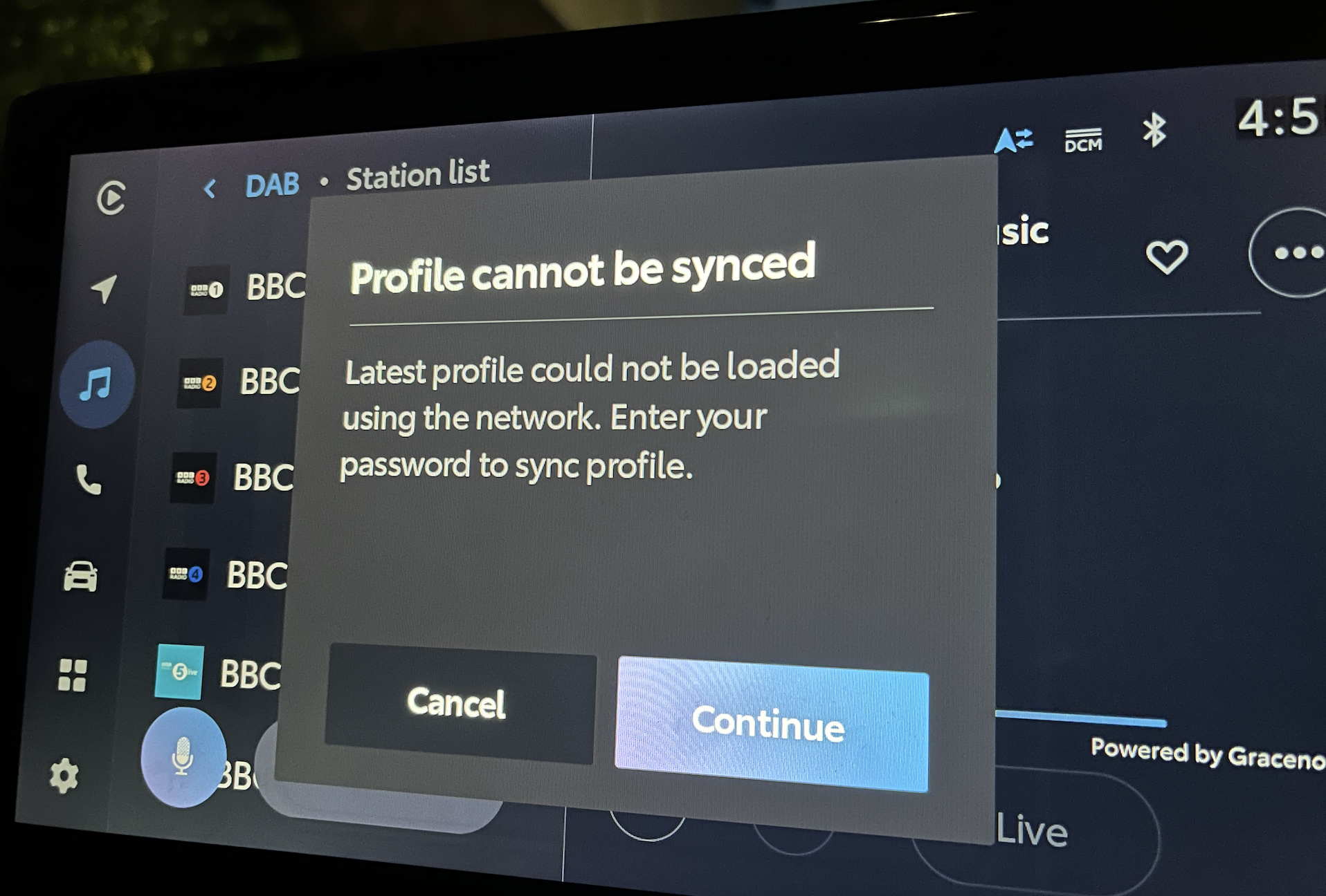

I'm now getting the 'Can't Sync profile' error almost every time l use the car and l don't understand what the problem is. I'm having to reenter my MyT password each time as pressing 'Cancel' only makes it go away for a few minutes then it nags constantly - distracting to say the least. What is really annoying is it always happens a few minutes after moving off so l have to pull over to enter my password. It happens with me (Android Phone) and my partner (Apple phone). I have a Carsifi but this was happening before l fitted it.
Additionally, another annoying issue is when entering a password the shift key is very difficult to get working - numerous pressings fail to make anything happen. All the other keys work exactly as expected. I've got round it by changing my password to have no uppercase letters.
I don't understand which bit is failing - is it Car<->Phone? Car(DCM) <-> Toyota? Something else?

Hello, has anyone else suffered from this screen pop-up and if so how on earth do you get rid of it! It repeats every five minutes (!!!!) and in the process kicks me out of Apple CarPlay.
It's utterly infuriating, especially when using sat nav.
The full message is "latest profile could not be loaded using the network" then asks to enter  a password. I enter my app password and it doesn't work, but my phone still connects to the car, so don't know what profile they mean?
