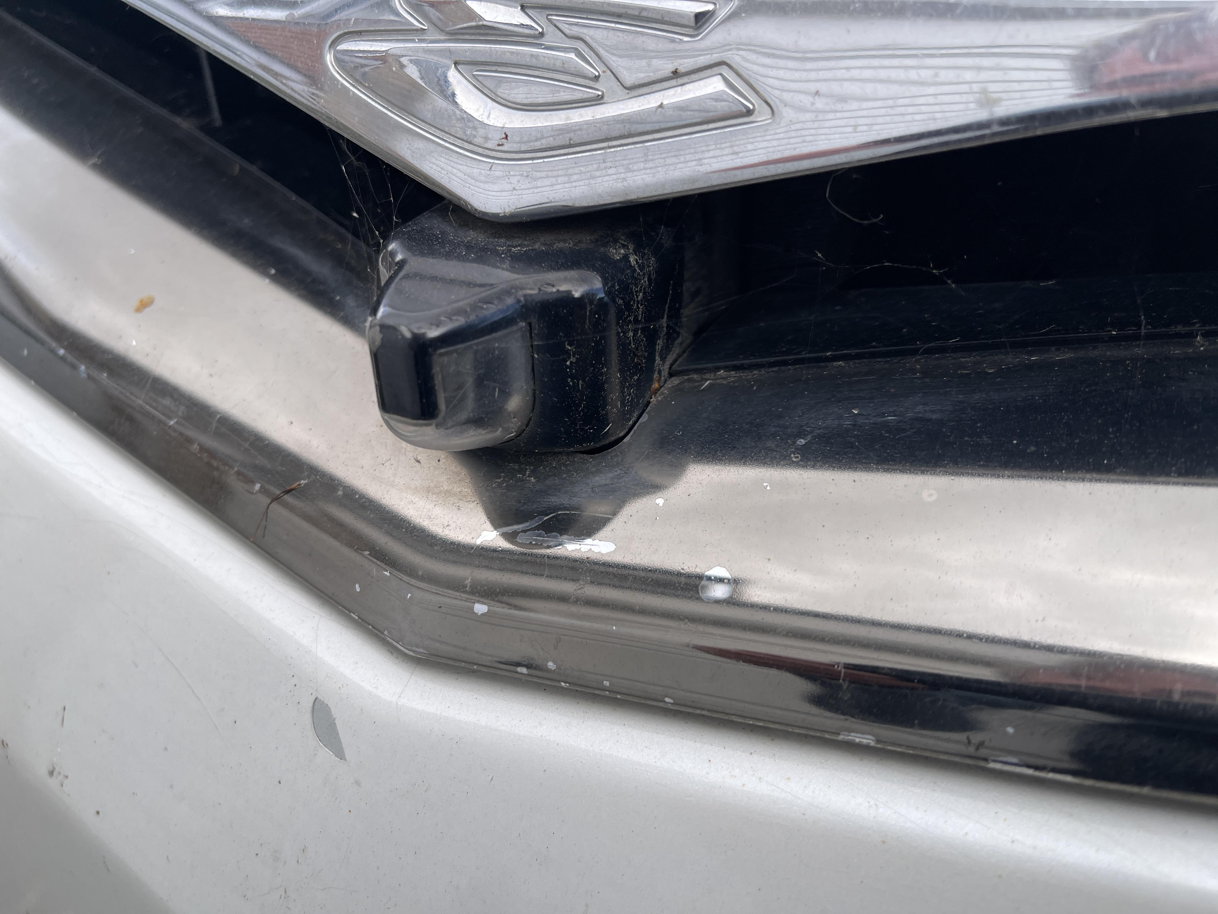

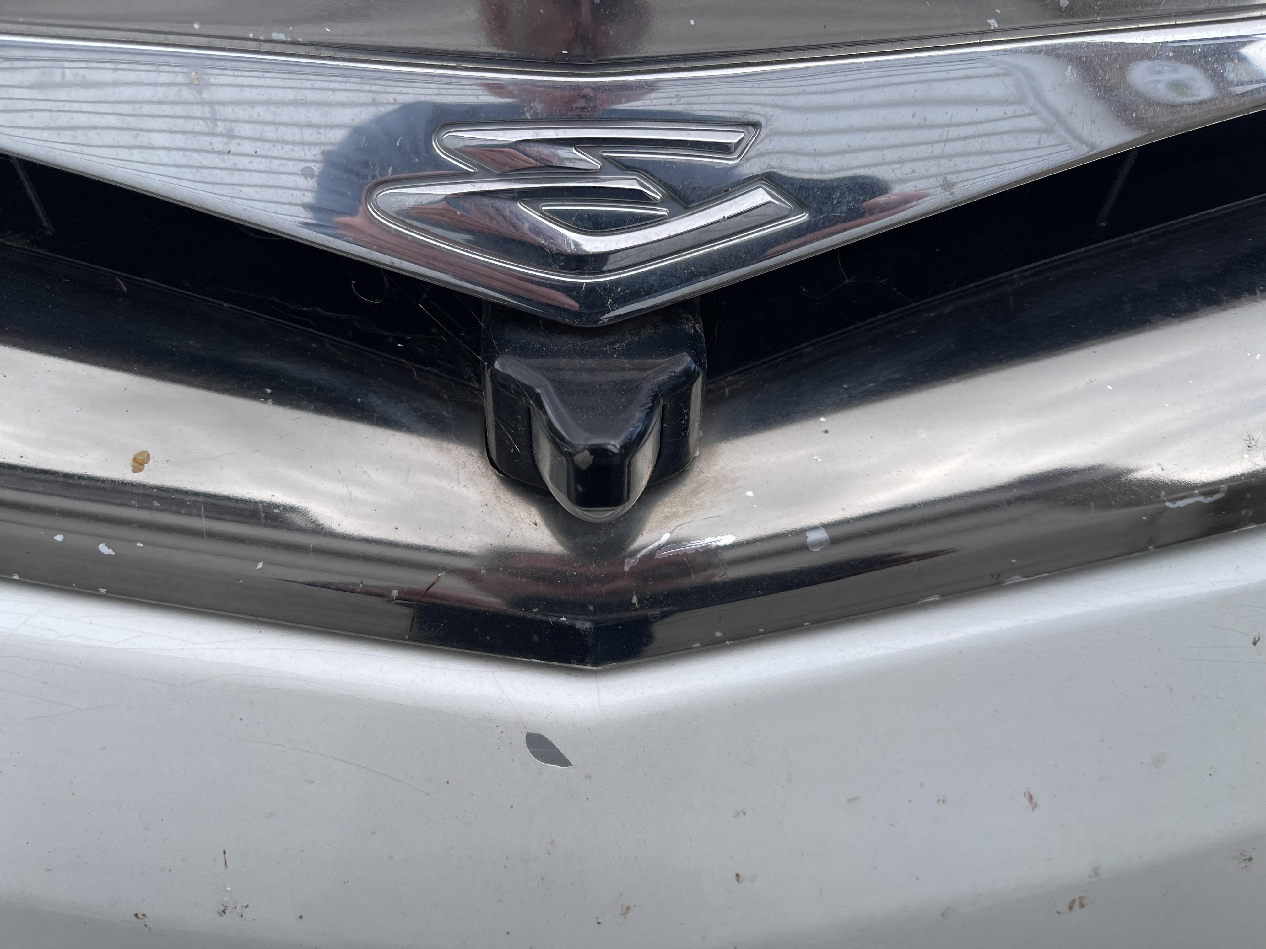

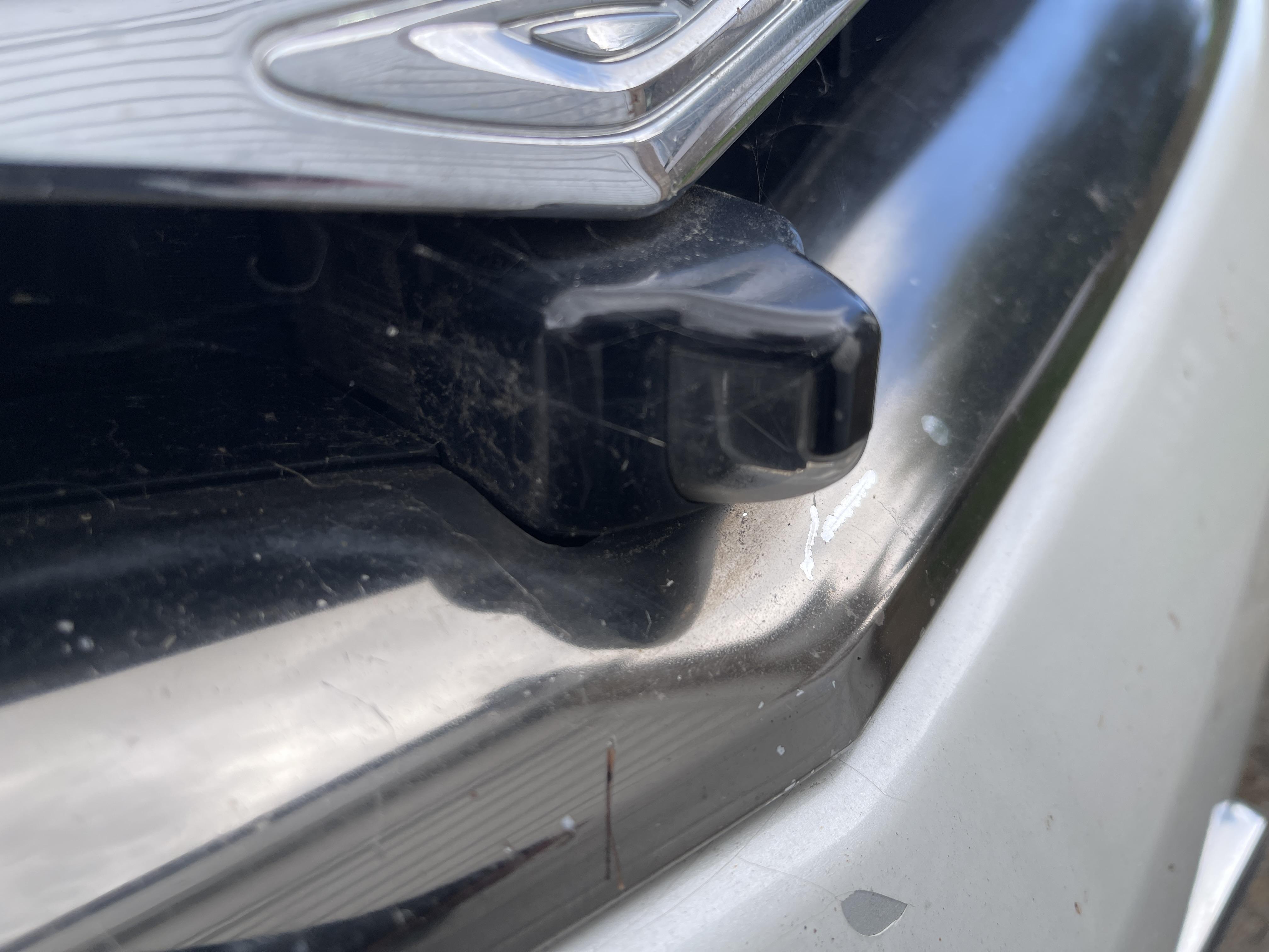

Can anyone help? I need to replace the front view camera on my Estima. It still works, but the lenses are totally glazed over. I'm saying replaced, as I cannot see how to remove the lenses to try and service them, but if there’s a way........
Appreciate any help guy’s
It will be a sealed unit if its on the outside it may polish out
is it a hybrid
86790-28160
bumper off, and its 2 screw and a plug
I think I would try a polish in situ first. That said, I haven't got round to doing my headlamps yet but the full kit is here ready to go.
is it a hybrid
86790-28160
Thanks Bob, I will give cleaning a try, yes, it's a hybrid
Thanks John, I'm going to try and clean them first I think, good luck with the headlights!
is it a hybrid
86790-28160
a mild rubbing compound should to the trick a dab of tooth past will do the job at a push
Cleaning would do very little. It needs to be polished with a fine rubbing compound, or very fine wet and dry paper (lots of water though).
Thanks Bob, I'll give it a go
Thanks Paul, I'm not brave enough to use wet & dry, but  will try a compound
Wet and dry is included in my headlamp kit. 240 and 3000 grit from memory plus compound of course.
Thanks John, I'm going to try the compound first at the weekend, if no joy I'll probably have to go down the wet & dry route 👍
So long as the plastic remains wet whilst sanding, you will be fine.
Thanks all, the headlight cleaning compound I used did the trick, bought the headlight / tail light lenses up great too!
