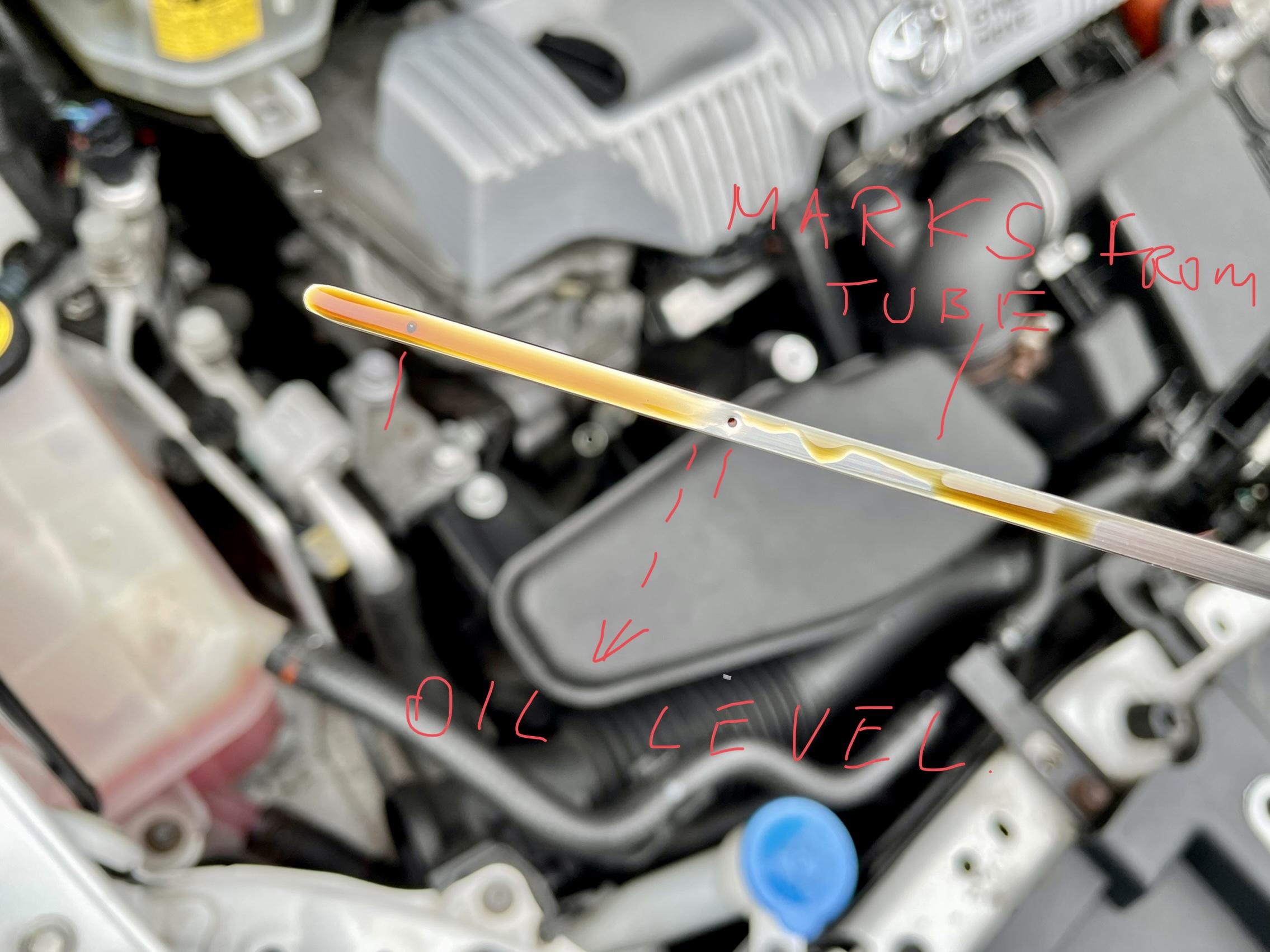

The best way to check your real oil level is in the morning on cold, pull out the dipstick and read without wiping it clean, if the oil level is at max or close by 5mm up or down you are good. You can wipe and re check again.
If you run the engine and then check oil on warm as per the book there is always a splash and marks left on the dipstick from the tube.
Here how to read correctly. 👍

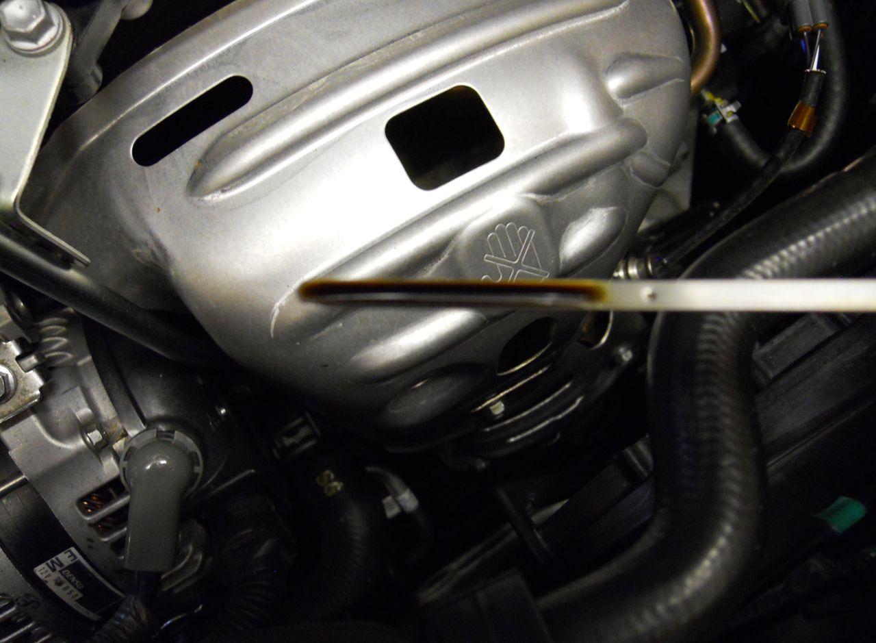

See Tony is using the new fangled transparent stuff. Mine is easier to see 🤣

(That nice looking oil I have is 10/40 grade and is cold and was changed back at end of Feb but up until this last three months had probably had 5 or 6 litres added to it. Following my discovery on engine braking the consumption is slashed. It runs so so well on 10/40, quiet and very smooth)

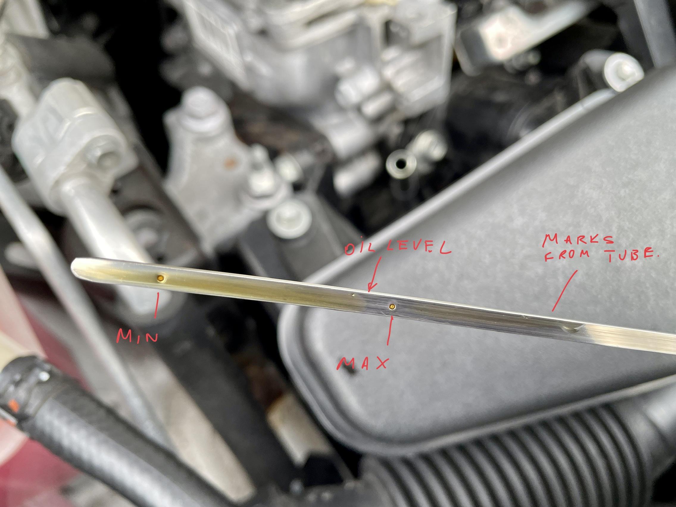

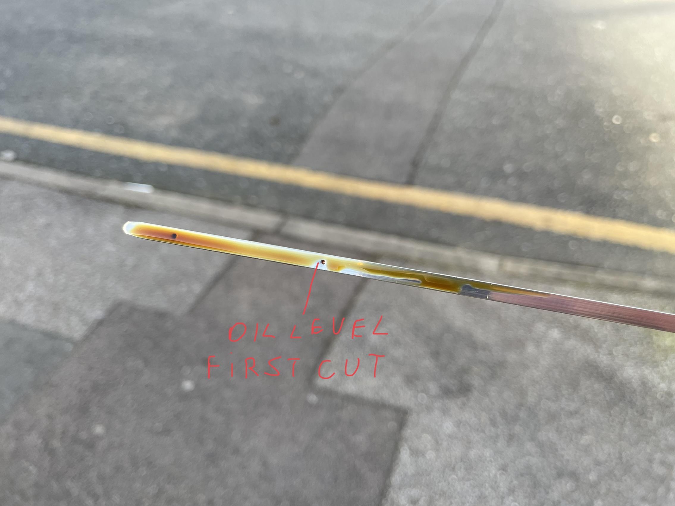

Ok, here with darker oil. The first cut is what we are looking for and this shows where the oil level is.
The rest above are just marks from the tube.
That's interesting as that's how my dipstick looked when I thought I'd overfilled it and not knowing at the time about tube marks. Still, the mechanic said he sucked some out, he reckoned half to 1 litre, so I obviously did overfill it a bit but not by as much as I thought.
This is the reason I do checks on cold without wipe clean the dipstick first and then re check on warm engine, it helps me avoid any misread and confusion. The difference between min and max on the dipstick readings is usually around a litre of oil on most cars.
