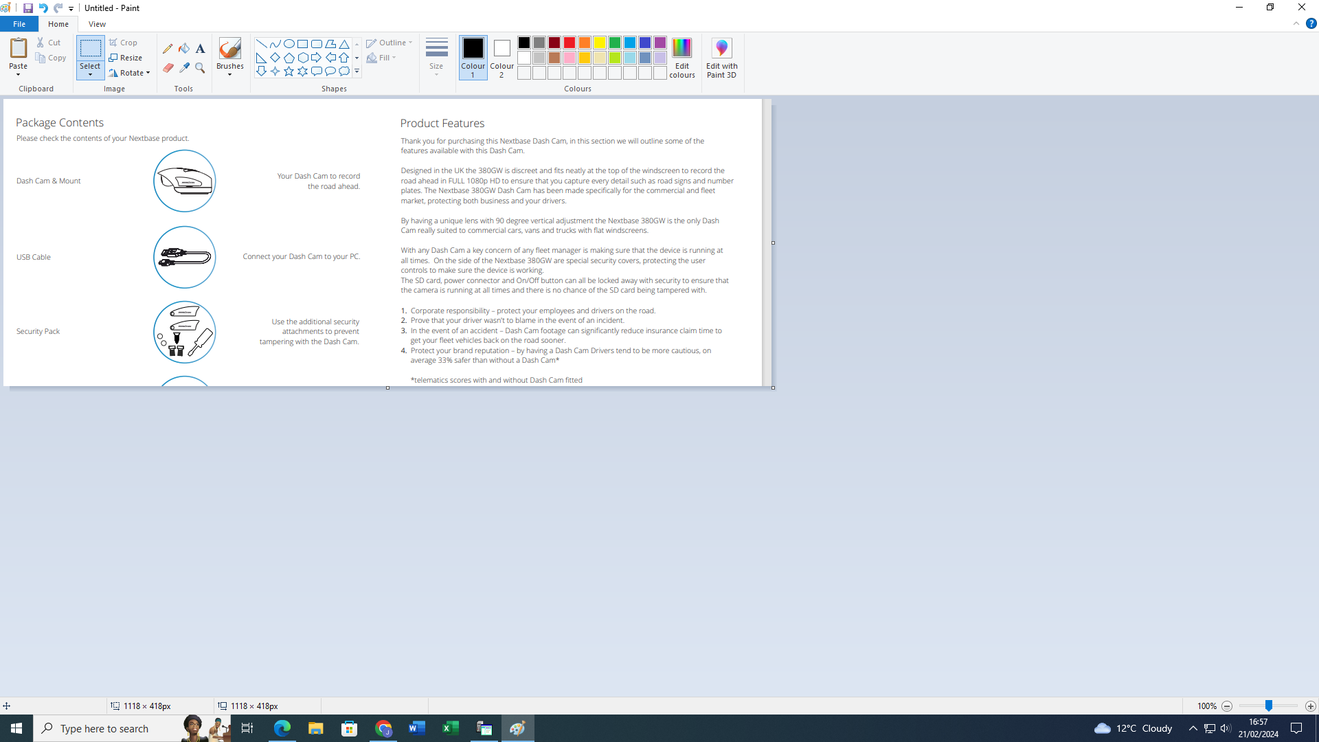

According to the manual at https://cdn.nextbase.co.uk/manuals/B4A2C8E8-1697-4A35-B921-2A86A99F6324/NBDVR380GWXRCB - Instruction Manual (English R12).pdf  there's a default password, but that's not accepted by the camera. A firmware update looks easy enough and can reset the password, but when my local dealer installed the camera they used the anti-tamper fittings so I can't get into it without breaking the casing. I'd like them to re-install it properly so I can access it but, meanwhile, if anyone has got one of these and has found a different default password from the one given in the user manual I'd be very interested to know.

I believe the lock function is for commercial use, hire car or company.  Password security should not be an issue, it's a pain to log in.  The WiFi range is short. You need access to the camera to start its wifi.   It is not easy to log on.  Finally, what benefit from hacking it?

Mine was default password and security screws etc in the box for me to use if I choose.

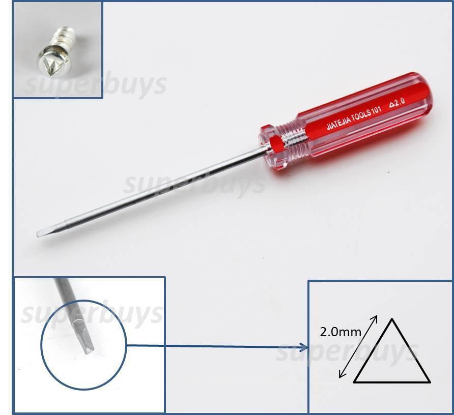

You can buy the anti tamper screwdriver online. Once you have this, you can remove the screws that hold the covers in place an access the SD card. If I remember correctly, the screws have a triangular "slot", rather then the pozi, phillips, or flat found on most screws.
