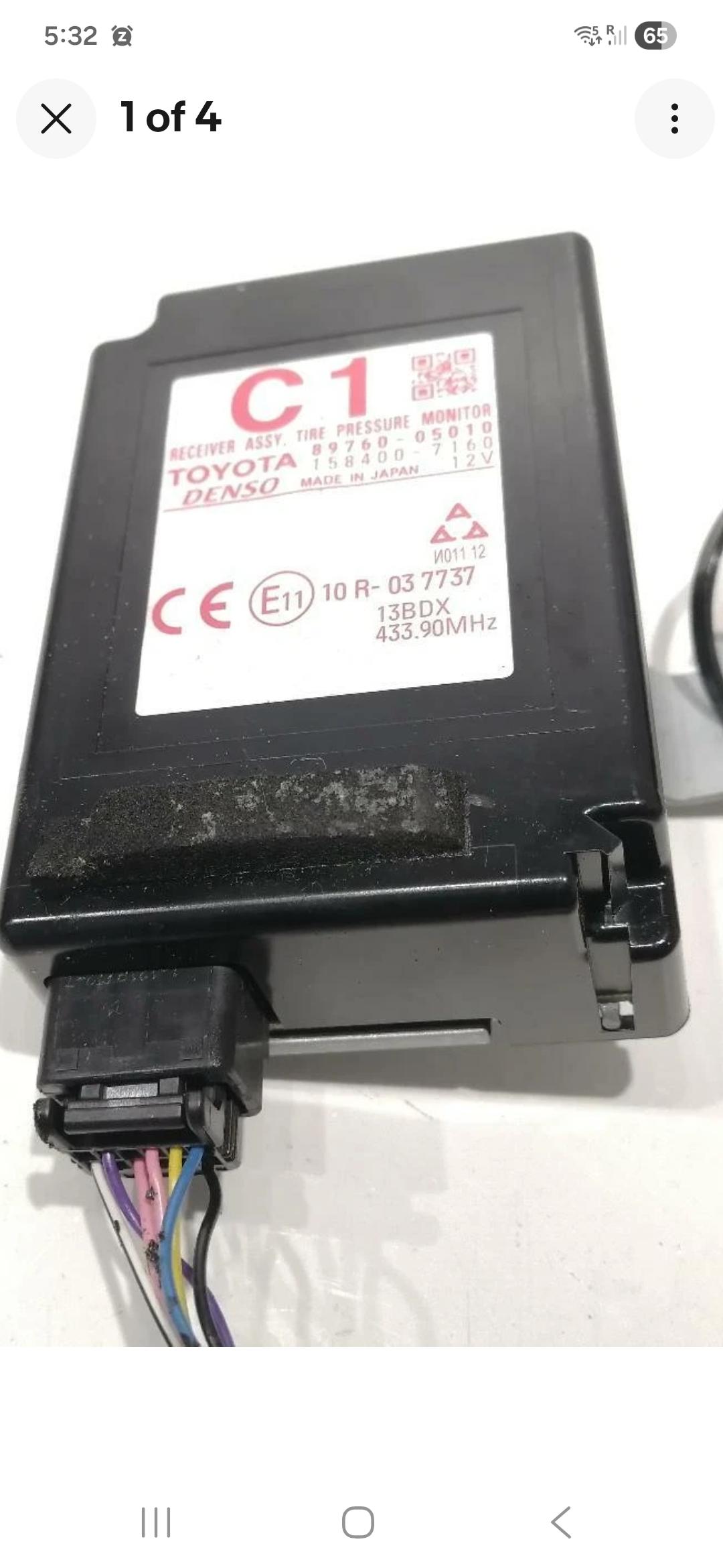

I seen a guy on YouTube taking them out wiring them up to a battery then putting them into plastic pvc pipe closed with a tyre valve on it so puts pressure in it and then puts them into boot will this work
It will work if you want to monitor sudden pressure drop of plastic PVC pipe 🙂
  • Haha 2
well sure then pay a fortune then for the toyota garage to fix them then mr know it all .tbh if those things start to give me bother il be doing the pvc pipe magic trick no big odds what you think
If you can't afford spending ~30€ for new sensor (or set of 4 from China ~40€) and don't afraid hard work you can replace Battery with ~3€.
u do what you want as i said i dont care what you do its no odds to me .i was just giving 1ofthe juicys a bit of info on as these are expensive and there are other options plus you are on about what i was talking about anyways of connecting them all together with a Battery and putting them into a pvc pipe .either way i was not telling you its none of your business anyways if you dont want to do it my way and as i said before i will be doing the pvc pipe method as i know for sur the post you put up is a temp fix and end of the day who could be bothered to take out the Battery and put in a new one .how long will that last at least the pvc pipe option is a fix for the life of the car .
