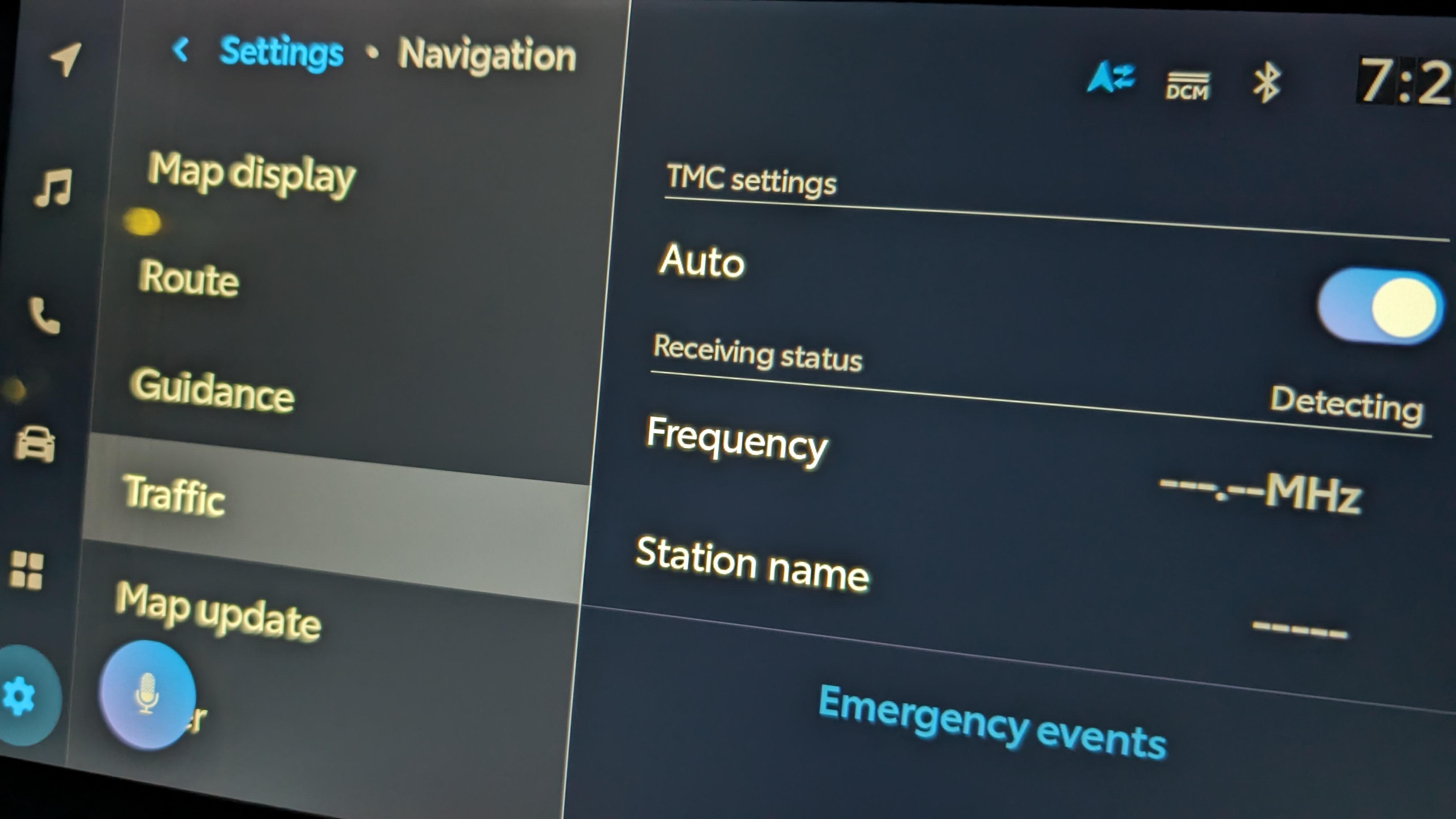

Hopefully my TMC will be fixed this month, image from Corolla MY23.
TMC never worked since new, first visit booked into a Toyota dealer gave the response, all software levels are upto date. Booked in again later this month. Other issue is the poor DAB/FM reception compared to my previous Corolla MY21. Hopefully both fixed then.
Everything else on the car is great.

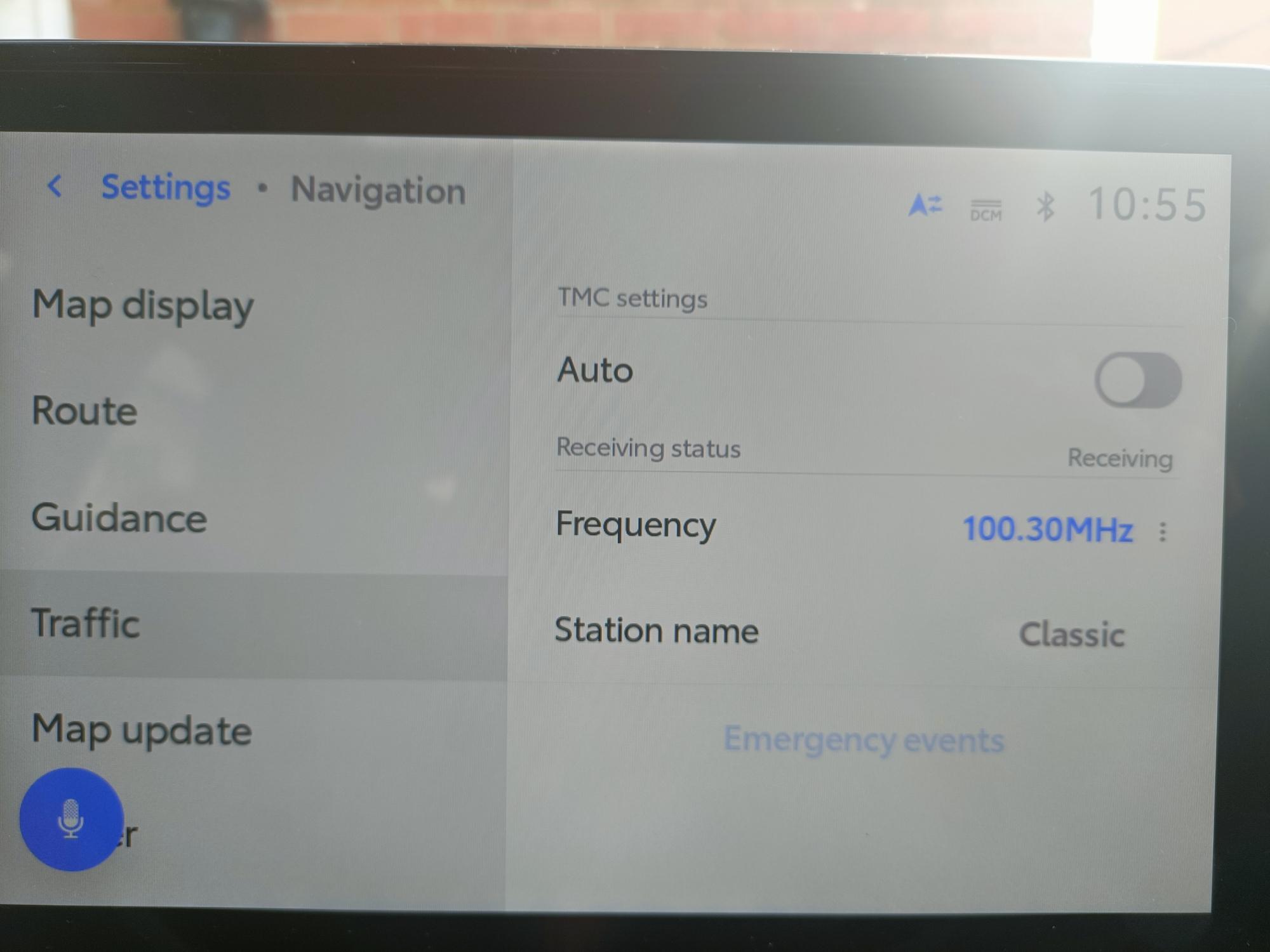

Hey after reading your post I realised mine wasn't working either so I decided to investigate.
In the UK, TMC is broadcast using the Classic FM network. So I switched to FM on the radio and scanned for Classic FM, which is broadcast between 99.9 and 101.9 FM.
I found Classic on 100.3 FM and manually entered that on the TMC frequency.
Now connected.
