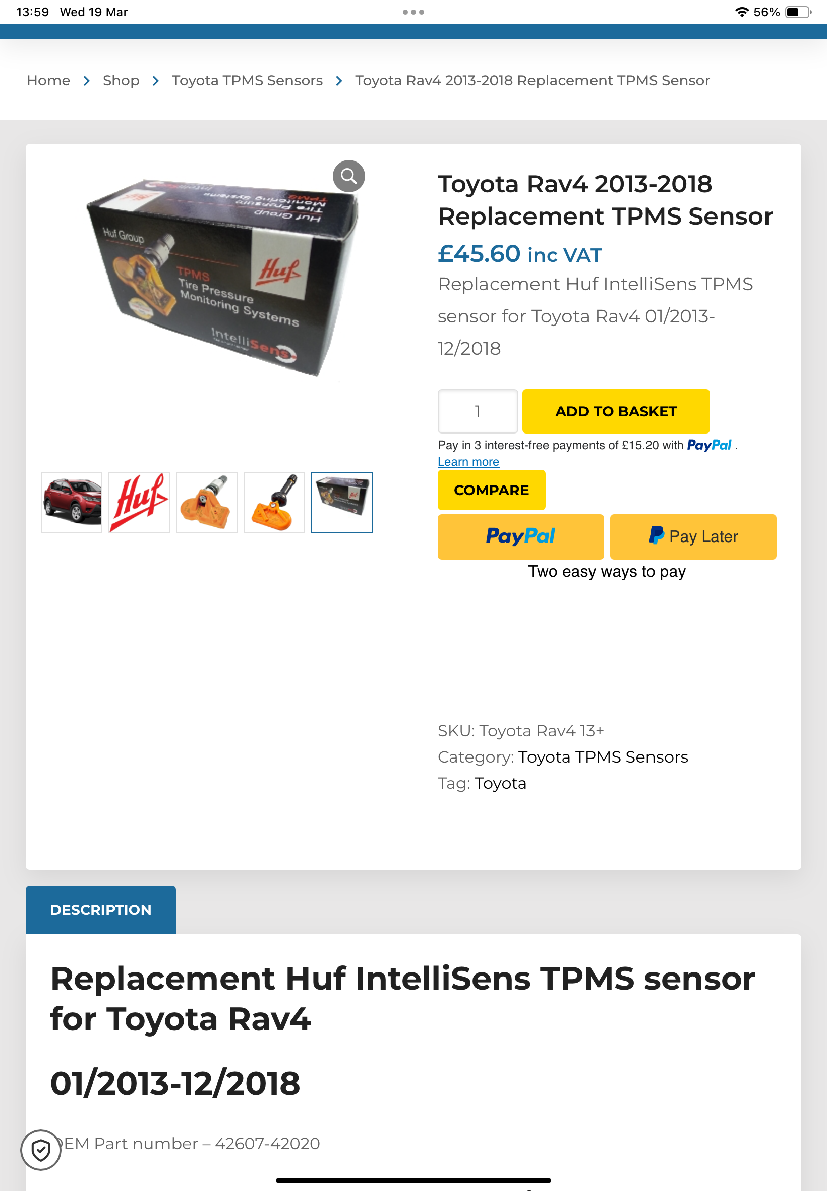

Genuine Toyota parts are £142.28 a set - I'm assuming that is a set of 4 but you'd need to check.
Third-party replacements come at £45.60 each (just an example)
"Programming" is a rather grandiose term for what needs to be done - the ECU in the car simply needs to know the identity of the TMPS valves fitted to the car. There are two approaches - updating the ECU via the OBD port with the new TPMS identities or cloning the original values into the new TPMS valves. Either approach requires an appropriate tool and I'm a little surprised that the national tyre chains aren't able to offer the service.

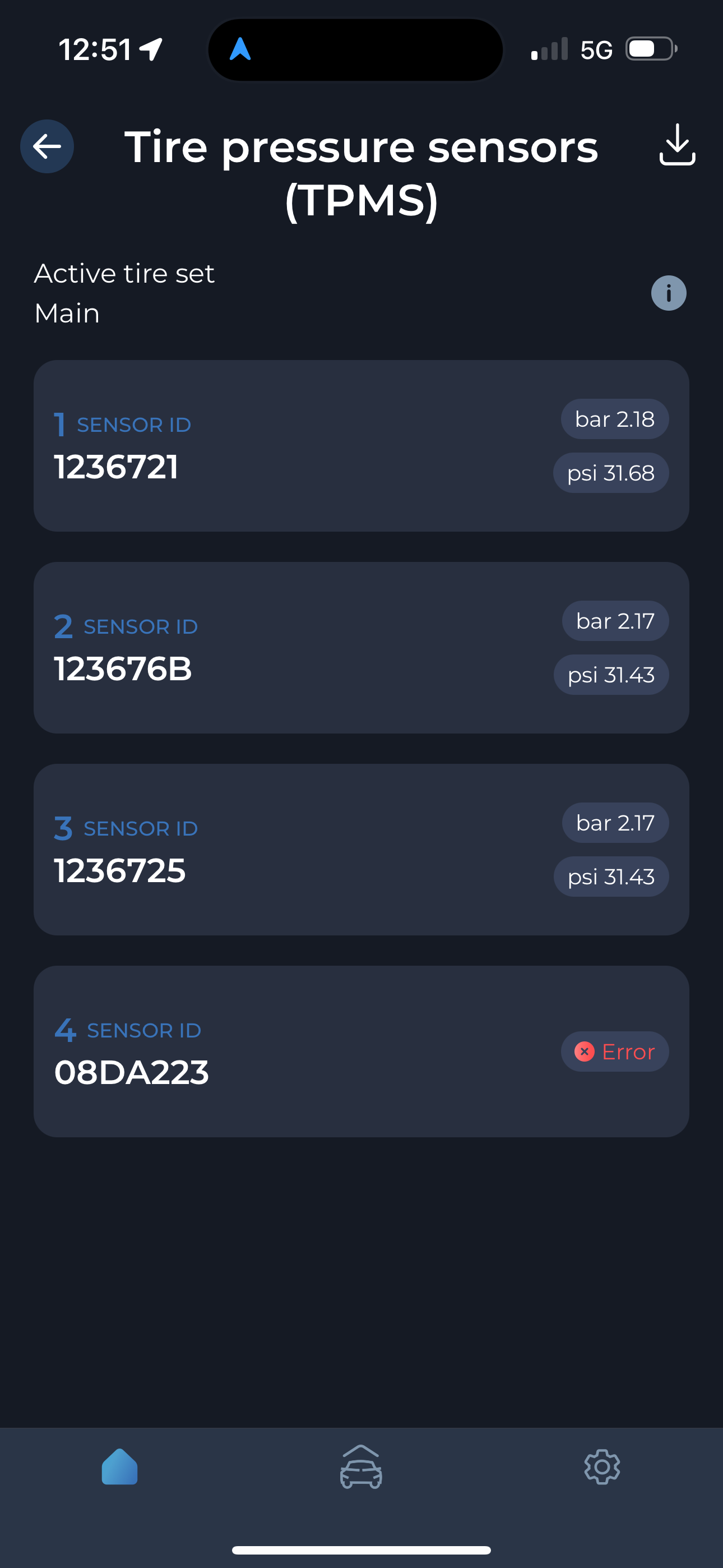

Well found an easy solution. My partner just reminded me about a year ago I bought an OBD reader to check for a fault. Just plugged into the OBD reader na dots showing an error on one of them and you can reprogram a new sensor into it. Only paid £30 for it so not complaining. Just need to find out which valve it is now and can do that by releasing the air in each tyre one by one. So chuffed as it would’ve worked out very expensive to replace all of them. Attached a screenshot of what the OBD was showing IMG_0194.thumb.png.0a3317d5dabe1096585306c4fb548192.png
Yeah that's why I was surprised the OP said no local places could do it - Any half-descent ODB2 tool can do it!
