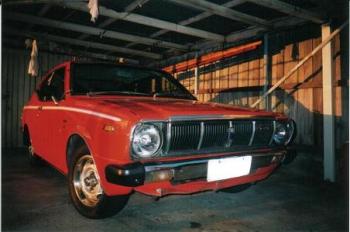

Ideas For 79 Corolla

To get only some more Power, you could Install the two Carburator-Bridge from the 3K-B Engine on your 4K-Block. If you want to get more Power, you can do some Double Weber or Solex Carburators (therefore you need a special intake manifold) on it und tune it with a special camshaft, and Exhaust Manifold....
Look on a friend´s KP60 Starlet with about 100HP....it goooooooooeeees!!!!
Oooooooo.....!!!!
2TG (uses same gear box)
3T-GTE (uses same gear box)
Might be able to fit an 18RG in their
4AG-ZE
1G-errr and the rest of the code!!!
2JZ-err and the rest of it (with a lot of chopping and messing around)
Must be others u can fit in.... whats ur budget??

:thumbsup:Hey thanks,
I was looking at a 4a-ge or 4a-gze. My car only has a four speed gearbox and its week as it needs that extra gear. I know in some cases that you can buy an engine with gearbox as a combo.
Well thanks for ya suggestions. It has been a big help.
At the moment i am looking for a job :ffs: to pay for the conversion!
