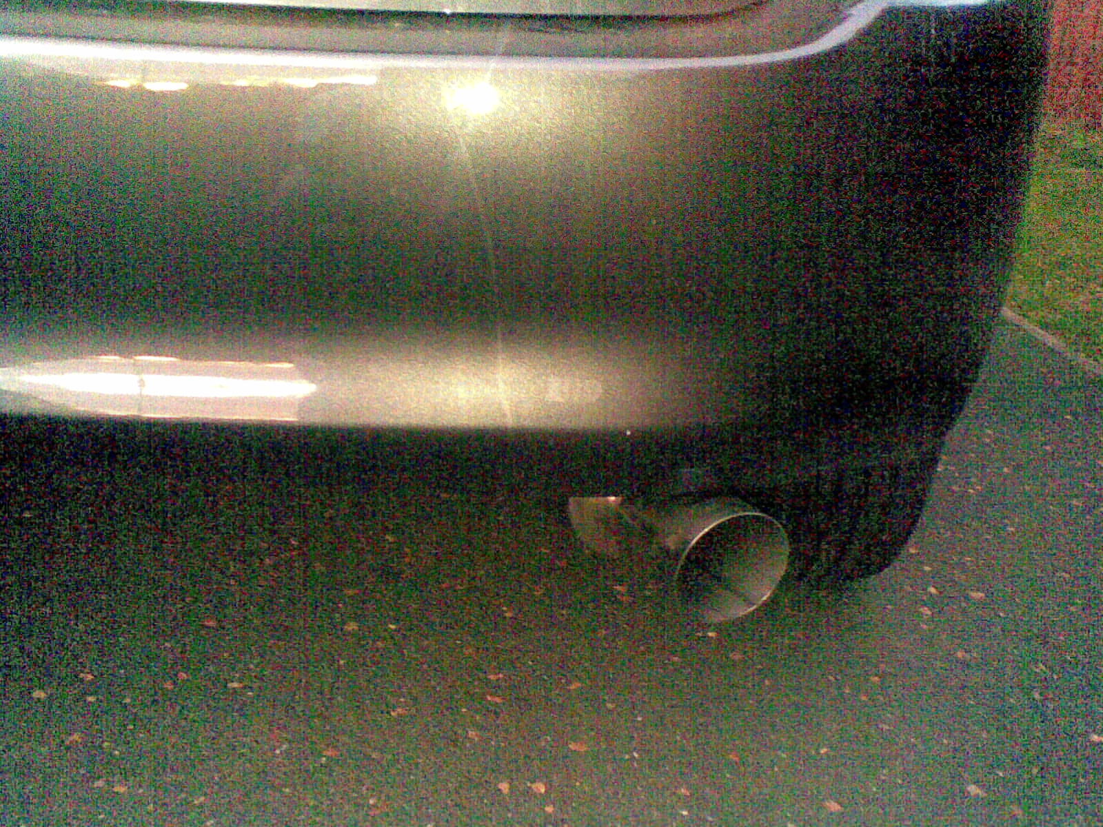

got my new back box fitted.. its got a nice low rumbling sound, but i wanna know why its bent to the side..it bends towards the right when looking at it from the back

I had the same problem.
1. The height was not equal on both sides
2. The horizontal space of the exchaust tip between the rearskirt was not equal & different on both sides.
3. the left muffler was hitting the towing hook on bumps
My dealer told me the could not do anything about it.
So , to solve it, I service centre centered my TMS pipes by:
A. Bended the rubber suspensionhooks of the rearmufflers so the hight becam equal.
B. The left muffler as fitted with a clamb. they used this fitting to get the exchaust tip horizontal equal between the rearskirt.
C. Removed 2 cm of the towing hook plate.
cost: 95 €
Hope this helps you
Greetz,
hmm that explains alot. thanks. i just thought that the new back box was bigger than the standard, so means that there was no room for it to be place..thanks again.
