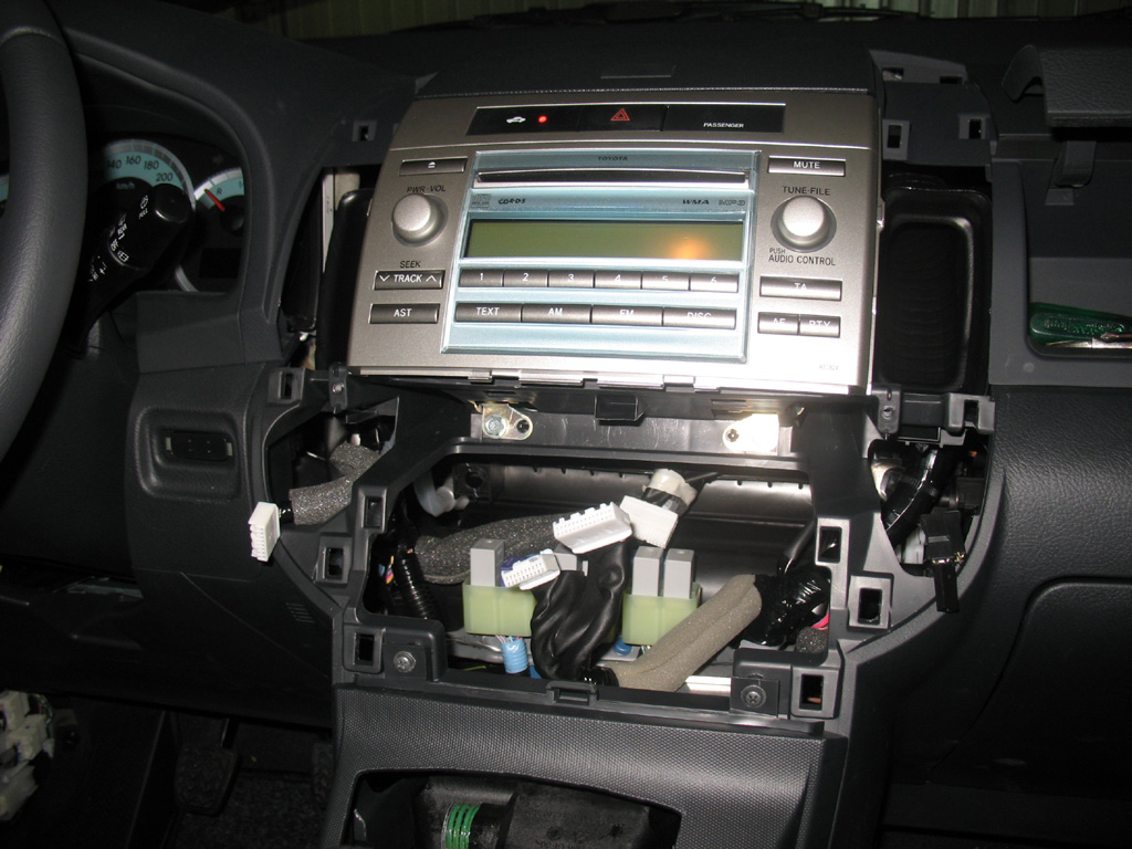

It is rubbisch You got the same as me (see picture) ?
What it actually does is incresing the bass at low volume en reducing the bass on high volume all automatic. And I didn't find a way to shut it down yet. Hopefully somone here knows some way to solve the problem. No, its not the asl setting.
It's behavior isn't so obvious with it's orriginal Speakers.
Those Speakers aren't disigned to give much bass.
I build in an amp with a subwoofer who is verry capable of producing low sound.
A plain carstereo don't give these problems.

It's not so hard, you only need a device that converts high output (the speaker leads) into low line-in signal for your amplifier. My device also has a remote+ to switch on the amp whenever there is sound.
But for us, there is no solution yet because of the bad signal comming out of the orriginal stereo.
Friday I'm gonna visit my toyota dealer and see what comes out.
The only thing I can do for sure is replace the orriginal audio system with a standard one.
You can do it yourself to. You need a replacement silver front (about 50€) designed for standard audio systems, a standard audio system and a converter cable Toyota->ISO, that way you even don't have to solder anything, just plug it in. The only downside is the disabling of the audio controls on the steeringwheel (but some audio brands, like Alpine, are already working on it).
