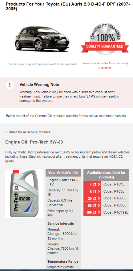

I’d like to add that when I put my reg number in, it lists the same oil as in the link from Frostyballs.
However, Toyota recommend that I use a C2 oil, which XTECH 5W30 isn’t.
When I search the Comma Oils website for a C2 5W30 oil, it lists their Pro-Tech range.
2 hours ago, Stivino said:
Put your reg no here and it will tell you.
For my Auris 2.0 d4d 08year it says that Pro-tech is the righ oil for me.

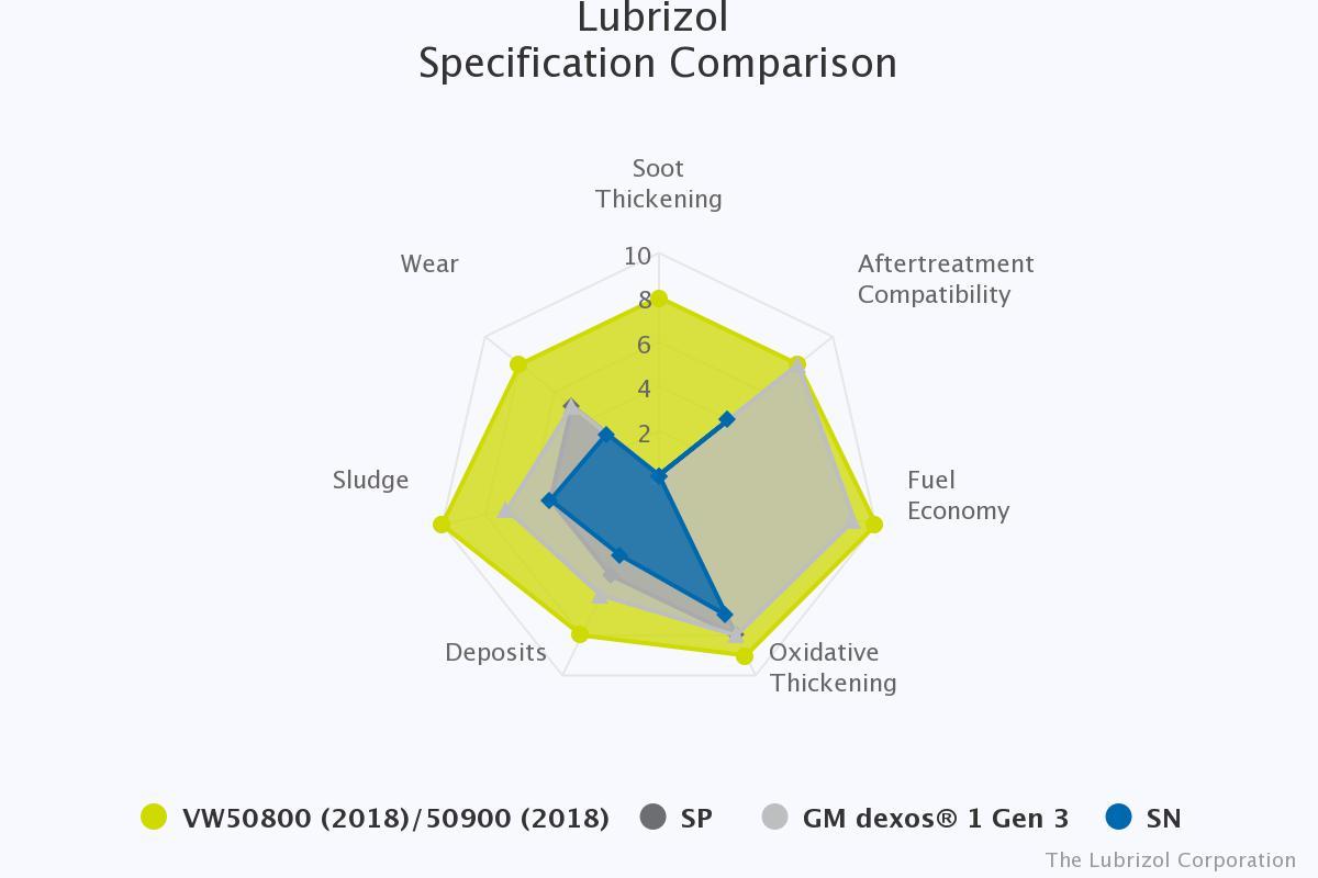

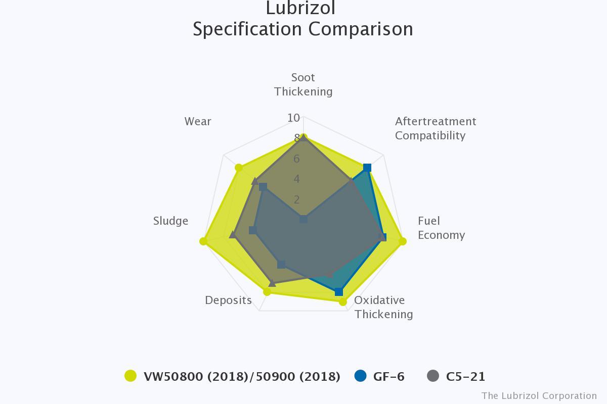

0w-20 oil is easy to find these days. Any brands are ok as long as they indeed meet the API ILSAC 6A or minimum API SN.
Manufacturer standards such as Dexos 1 gen 3 or VW 508/509, BMW 2017FE, etc have more stringent additives and base oil requirements.
Toyota 2ZR-FXE engine is very mild to oil wear, so don’t worry too much about  which brands as long as change the oil on time.
5w-30 is also not bad but may not the best for cold starts but they are usually much cheaper from larger market distributors.
SN_SP_Dexos1g3_508.thumb.jpeg.d56e5f130a943756093866e1f94927ea.jpegC5_GF6_508.thumb.jpeg.1d5d2b80f5da73ce7bfc8575f7539cae.jpeg
