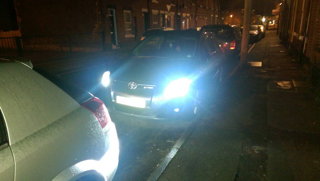

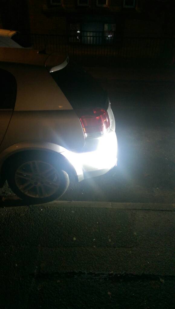

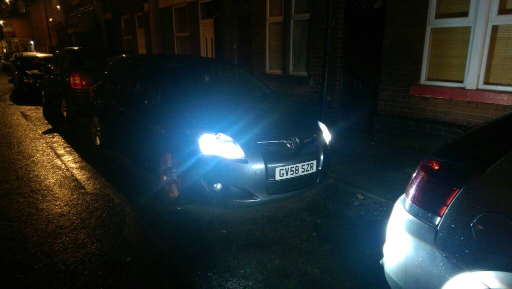

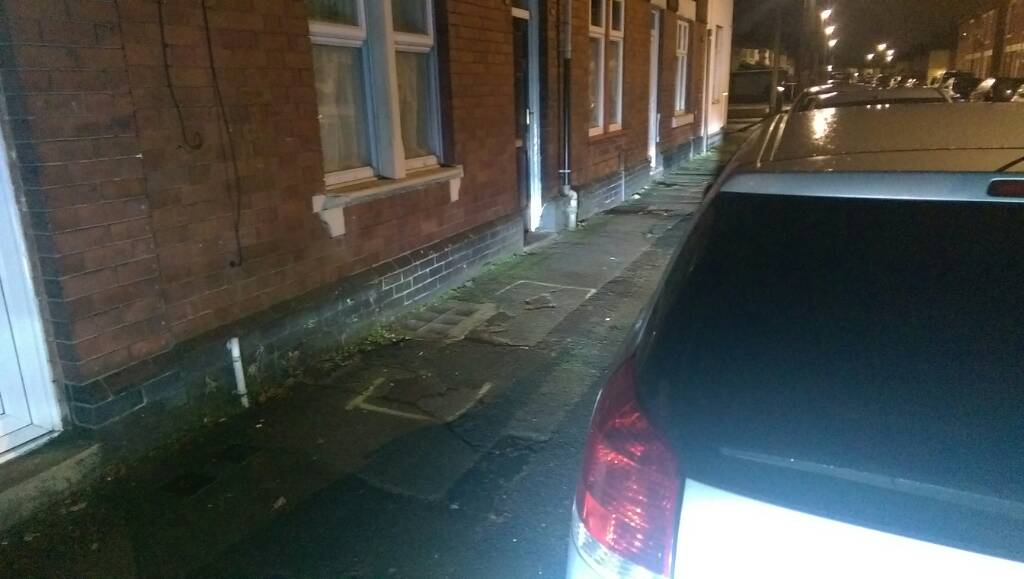

As you can see a hid upgrade has worked wonders these pictures where taken on a very well lit street as well
