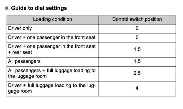

On 10/11/2017 at 8:47 AM, Mick F said:
Yesterday evening in the dark, I switched to main beam and I'm fairly sure that the aim is too high.  I altered the load leveller control and I could swear that the aim is wrong.
Yet to experiment further, but I think that the control should be at zero when the car is unloaded with just a driver and front passenger.  It seems to be better at 3 or 4 (of 5).  Also, the control bottoms out below zero.
It seems that the aim is fine in dipped, and the brightness is fine in dipped too.
So, not only are the lights not bright enough in main beam, they appear to be poorly aimed in main beam too.
Diving along the A30 dual carriageway late last night, and the road was very quiet for mile after mile.  I was able to change the aim height by the control and find the best setting.
The handbook says that with just the two of us in the car, the dial should be at zero, but I found the best position to be at 2.  This gave the correct spread at dipped, and nice and far on main beam without lighting high up in the trees.
Yes, No2 was the best position, and zero was way too high and in danger of dazzling oncoming drivers when on dipped.
Still can't see why ours will go BELOW zero.  Maybe it goes to -1 or so.  Could be that the thumb wheel needs removing somehow and re-setting.
Mick.
Sounds like the alignment is out.  It's adjustable at the headlights, then the thumwheel is used to lower the alignment in stages, depending on how heavy your load is.
Yes, it does seem the alignment is out.  It passed the MOT in late August, so they mustn't have thought there was an issue at all, but it's not right.  Now I know that position two is the best setting, I'll leave it there and when it goes for the next service and MOT in August 2018, I'll get them to sort it.
The knob goes down below zero, and by fiddling with it, there appears to be a "minus one" setting.  That seems to me to be a "mechanical" issue of the knob itself and I'll get them to sort that too.  The car is still under Toyota warranty, so I'm not doing anything to it.  It's fine at Two, so that's where it'll stay until they check it out.  It's ok for now, and fine where it is.
I don't ever expect to be carrying extra loads - or having a car full of people - during the hours of darkness.
Mick.
Mick.
I'm led to believe that the MOT tester will set the adjuster to it's mid setting (3) to do the test.
