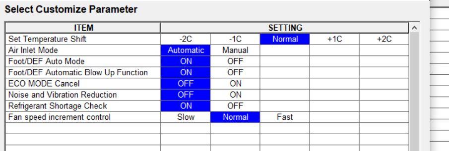

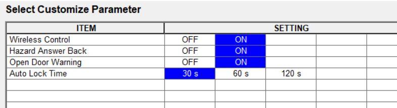

Here's an example of some options i can change on the yaris
Click to enlarge
ac.thumb.JPG.6a9c86d861af5f69ad91b4d137e499f0.JPG581240442_doorchime.thumb.JPG.b64389731745f0c78d118b8cc27c1d4e.JPGwarning.thumb.JPG.0558ef373fb38ddf72b2d22b92a26695.JPG

Glad to hear I've went for the better option then. Thanks for that!
Nice to see it has some of the 'questionable' phrasing I'm used to from using VCDS on the Audi, I predict google will be my friend on that front. Thanks for showing me the examples!
