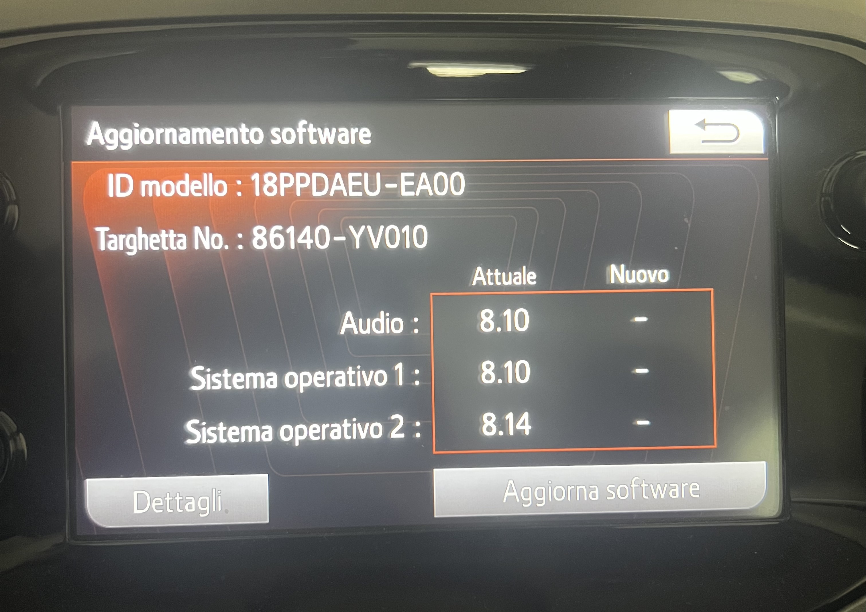

I just got a Toyota Aygo X w/ the radio that supports CarPlay. The radio keeps turning itself off when trying to connect to CarPlay. Are there any update files that I can be sent to update the system or at least someone let me know what the latest system is?
could someone PM me the link to the update please, on 705 621. many thanks
It's a 2 stage update for anything below 0810
will pm you shortly

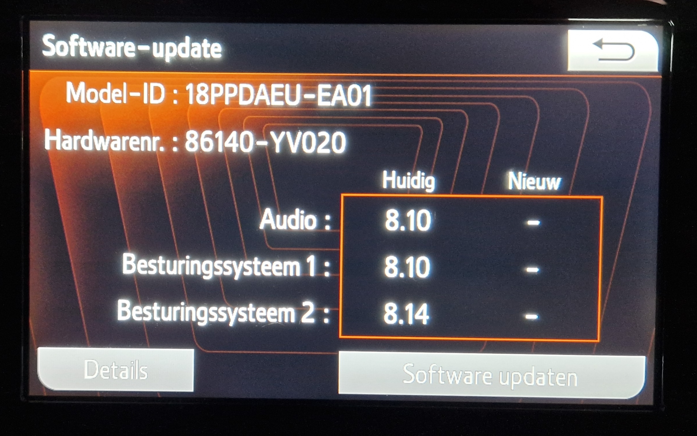

I also have an Aygo from 2019 with bluetooth / Android Auto problems. When there is an incoming phone call to the Aygo when Android Auto is active, there is no audio from the incoming phone in the Aygo. However, the calling person can hear everything just perfectly. The only solution I've found thus far is to just not connect a phone to Android Auto; but that's insane. It's driving my wife insane to be honest.
I'd really like to try if a software update will fix this problem before going to the Toyota dealer and trying to get them to do it (which would be costly). I've attached a screenshot of the current software versions (Dutch language):
Kind regards,
Marcel
The Netherlands
5 minutes ago, MarcelB said:
Hey Flash22,
Kind regards,
Marcel
The Netherlands
Hi Marcel,
I had exactly the same problem! The update that Flash sent to me fixed it 100% while Toyota assistance asked to replace the whole infotainment unit....
Just wait for Flash to PM you

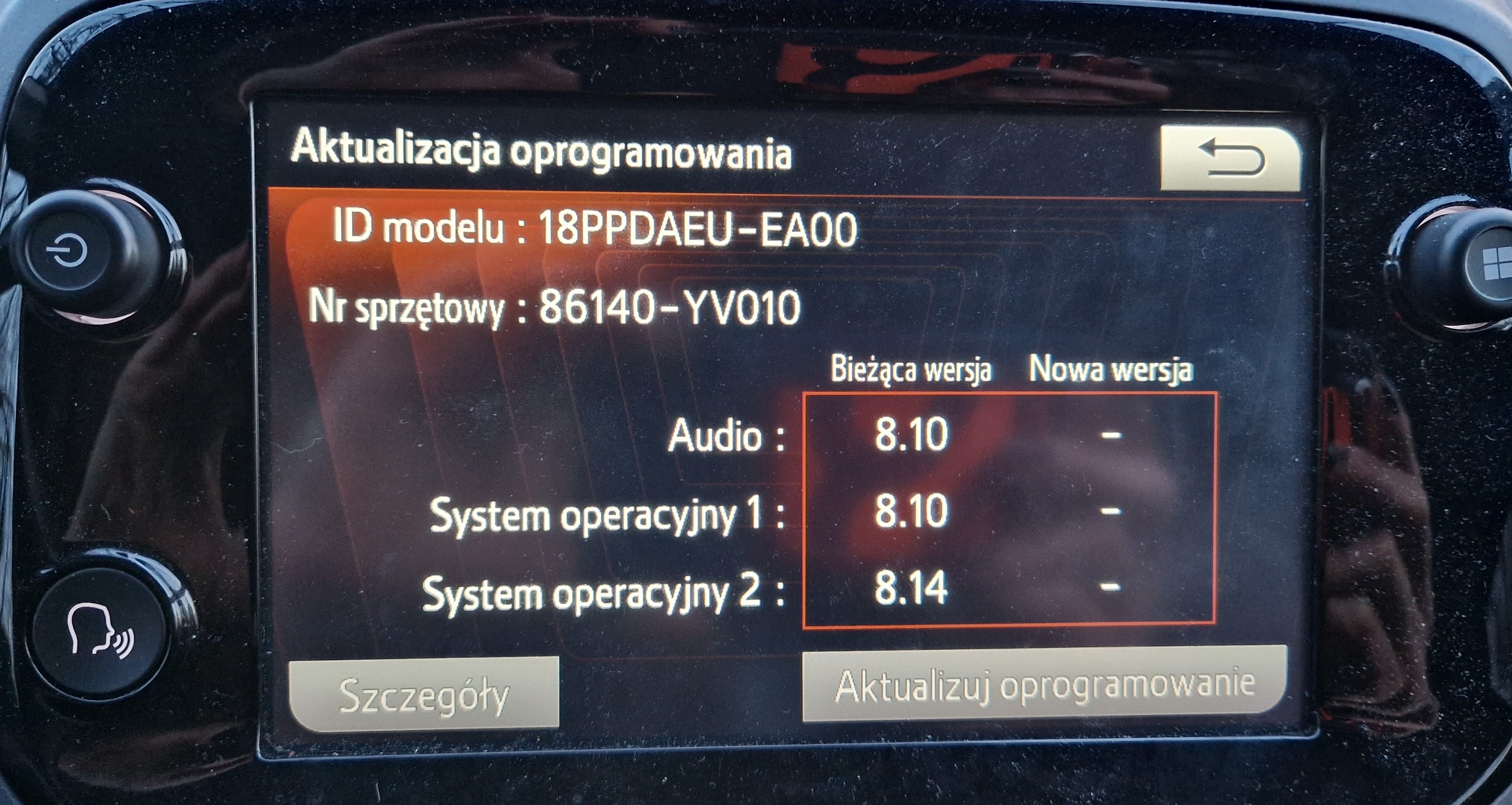

I have the same problem 😞 It's driving me nuts!
I would appreciate receiving the update file too
19 hours ago, flash22 said:
What is your model and current versions
2019 Toyota Aygo. Thanks!
Hi,
I've updated the system (8.12/8.15/8.17 after the update). I didn't have a lot of time to test it yet but it seems to fix the audio problem 🙂
Thanks a lot flash22!

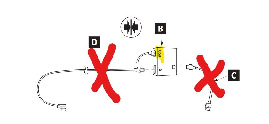

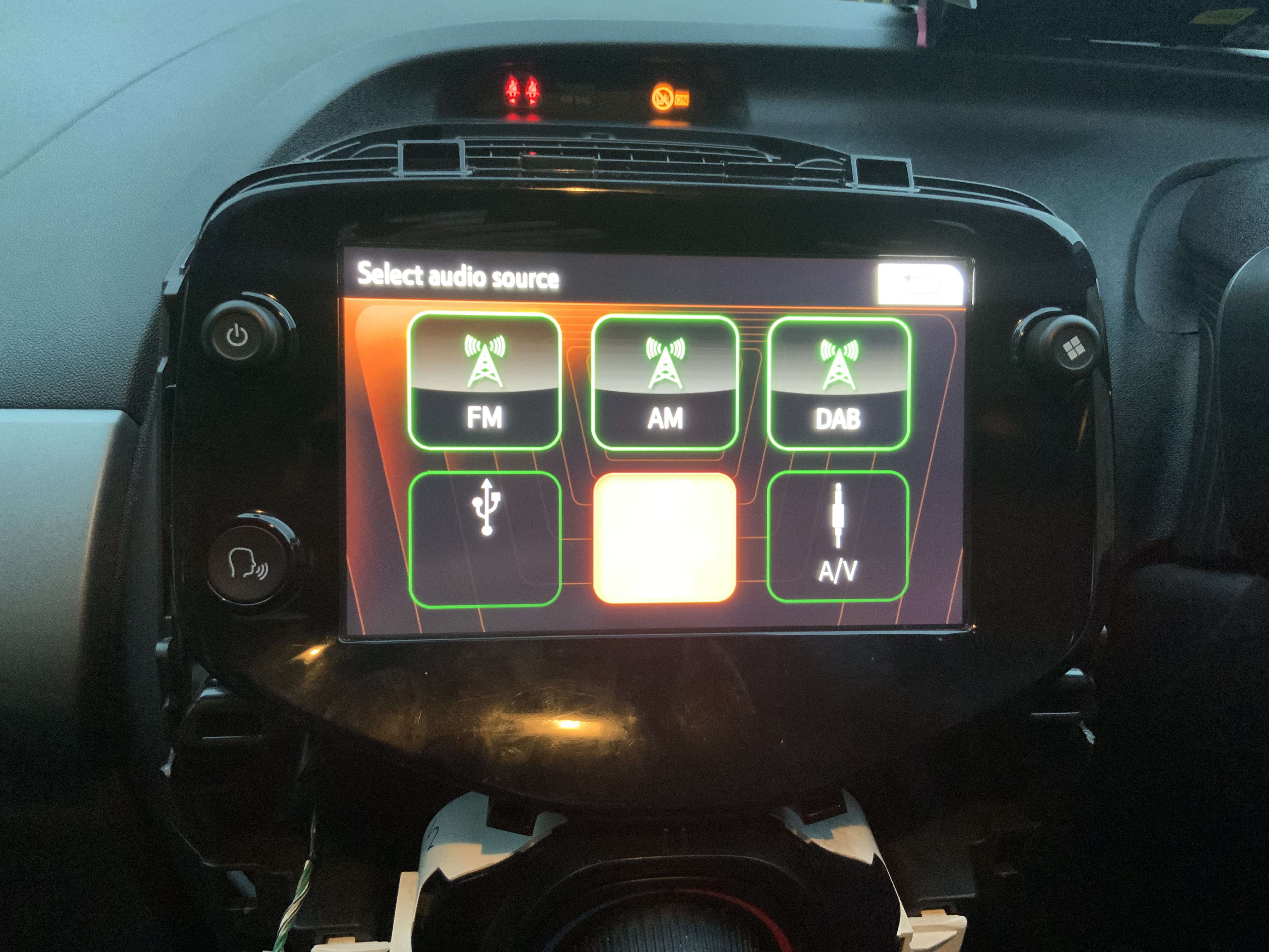

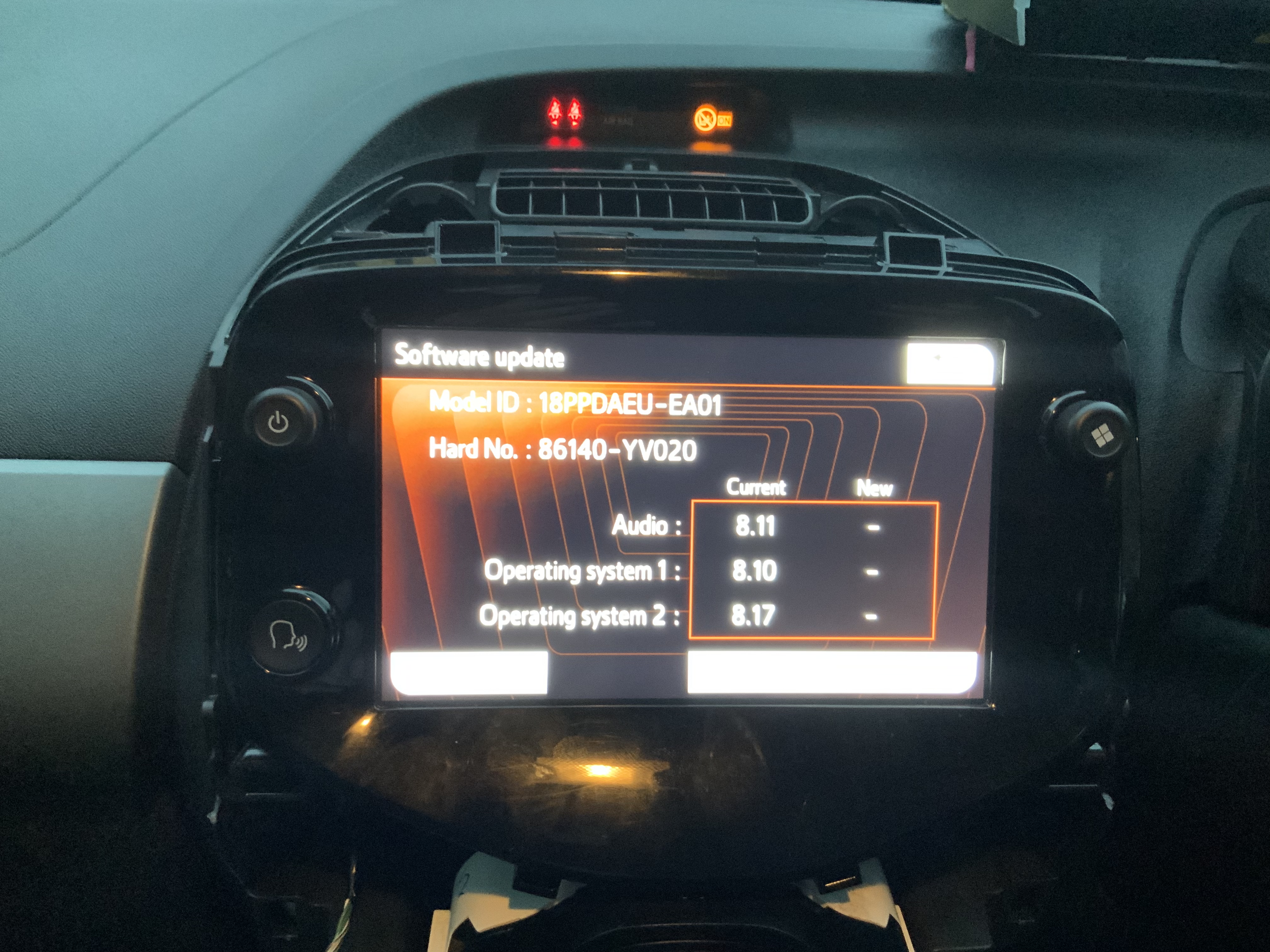

Hi can anyone help. Just installed the 86140-YV020 upgrading from the 2 button version. All works apart from the usb connection So no Apple CarPlay and i cant charge my phone. I reconnected the old radio and usb works fine.  Tried an Apple cable and a couple of others with no joy. Any ideas? Many thanks.
Here is the current software version. The unit came out of a Citroen C1. You can see the usb option is greyed out. The iPhone is connected to the usb socket at the time. As i already said, everything else works fine apart from the main reason for me upgrading the unit, Apple CarPlay.
Did you have sat nav, if so you need to unplug it as it's not compatible, unplug the USB from the splitter and plug it into the Tripleplay
Thanks for the reply. No, there is no sat nav in the previous version as far as i can tell. Only bought the car a week ago from a Toyota dealership. I can’t see that box behind the radio unit or any SD card slot in the glove box. There was only one usb cable i could see.
