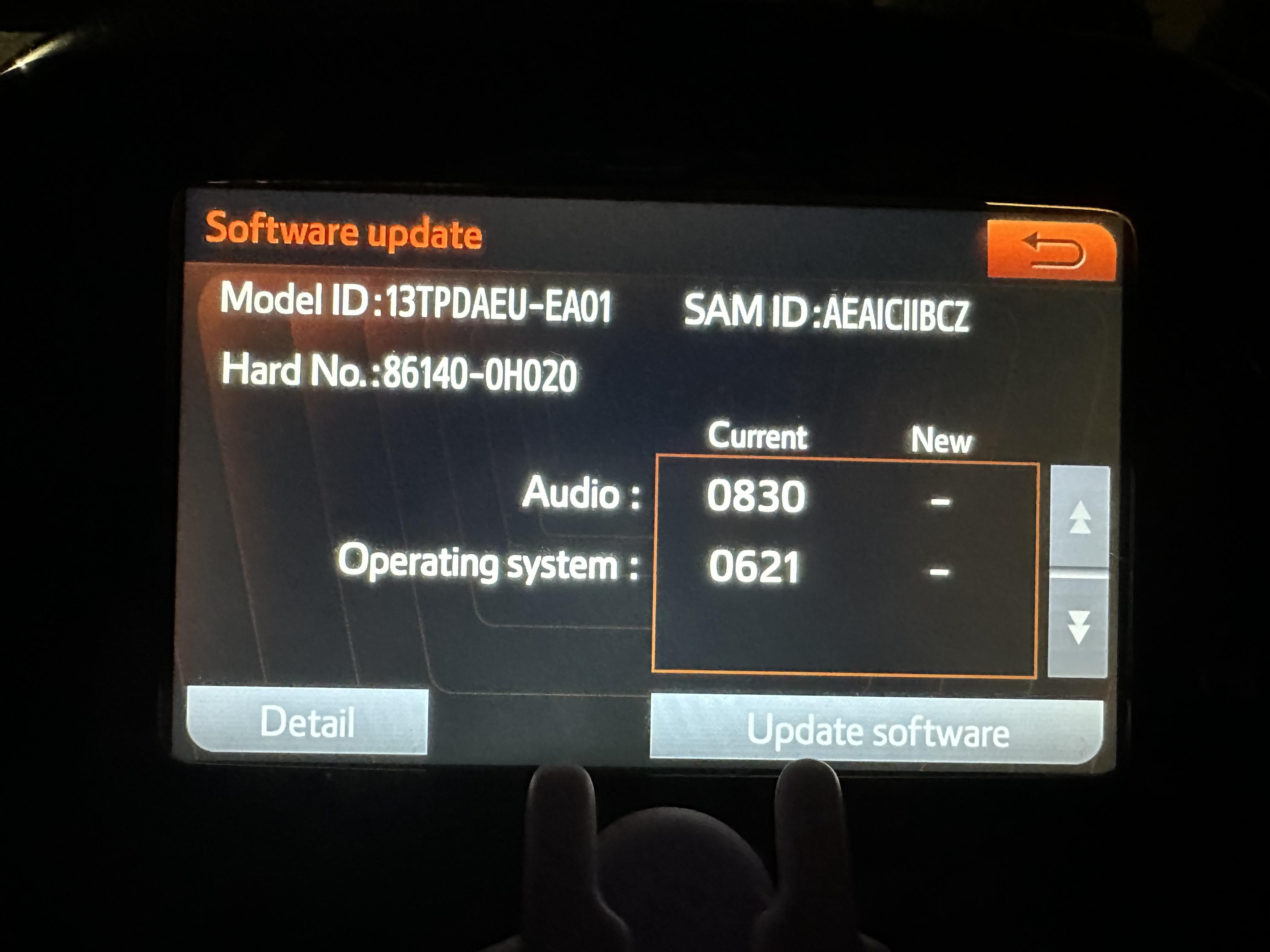

Hi. New guy here. Have just purchased an Aygo 64 plate with Audio version 705 and audio system 0621. Appreciate any updates you guys might have.
thanks
You will need the 810 rc1 update first, then you can update to 840 or 850, be aware these updates do not upgrade you to Android auto/Apple Carplay

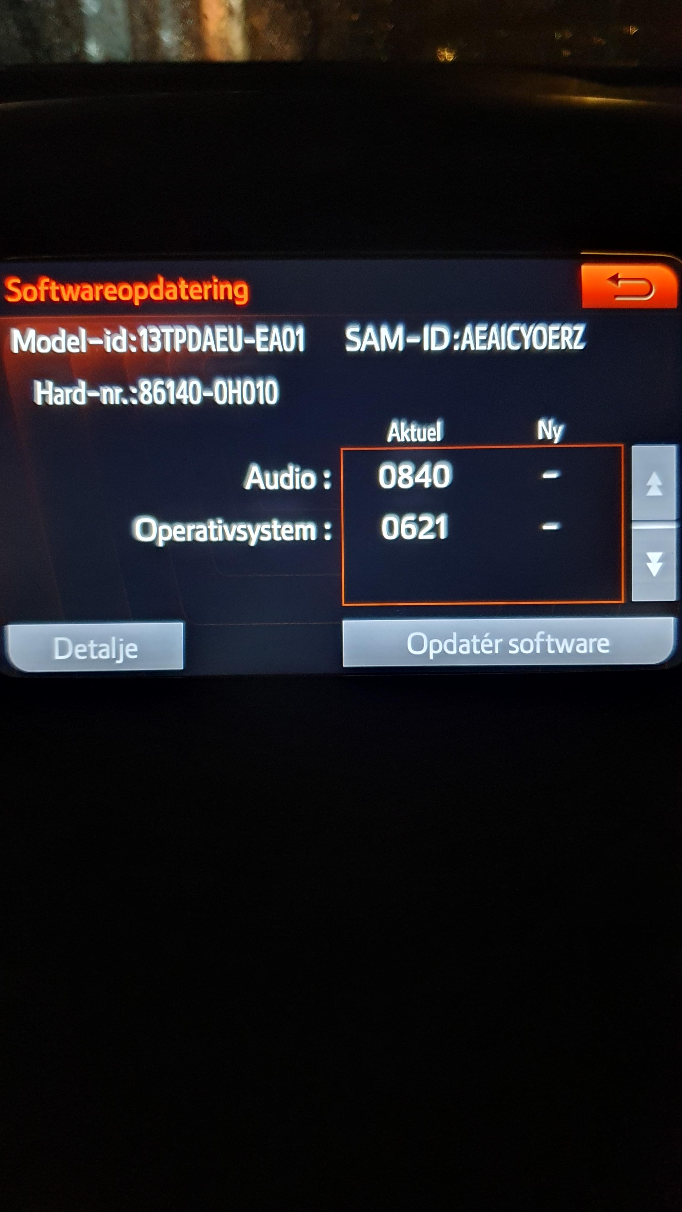

Hey @flash22
I have the 840 version installed and I would like to upgrade to 850.
Can you please send me the update file?

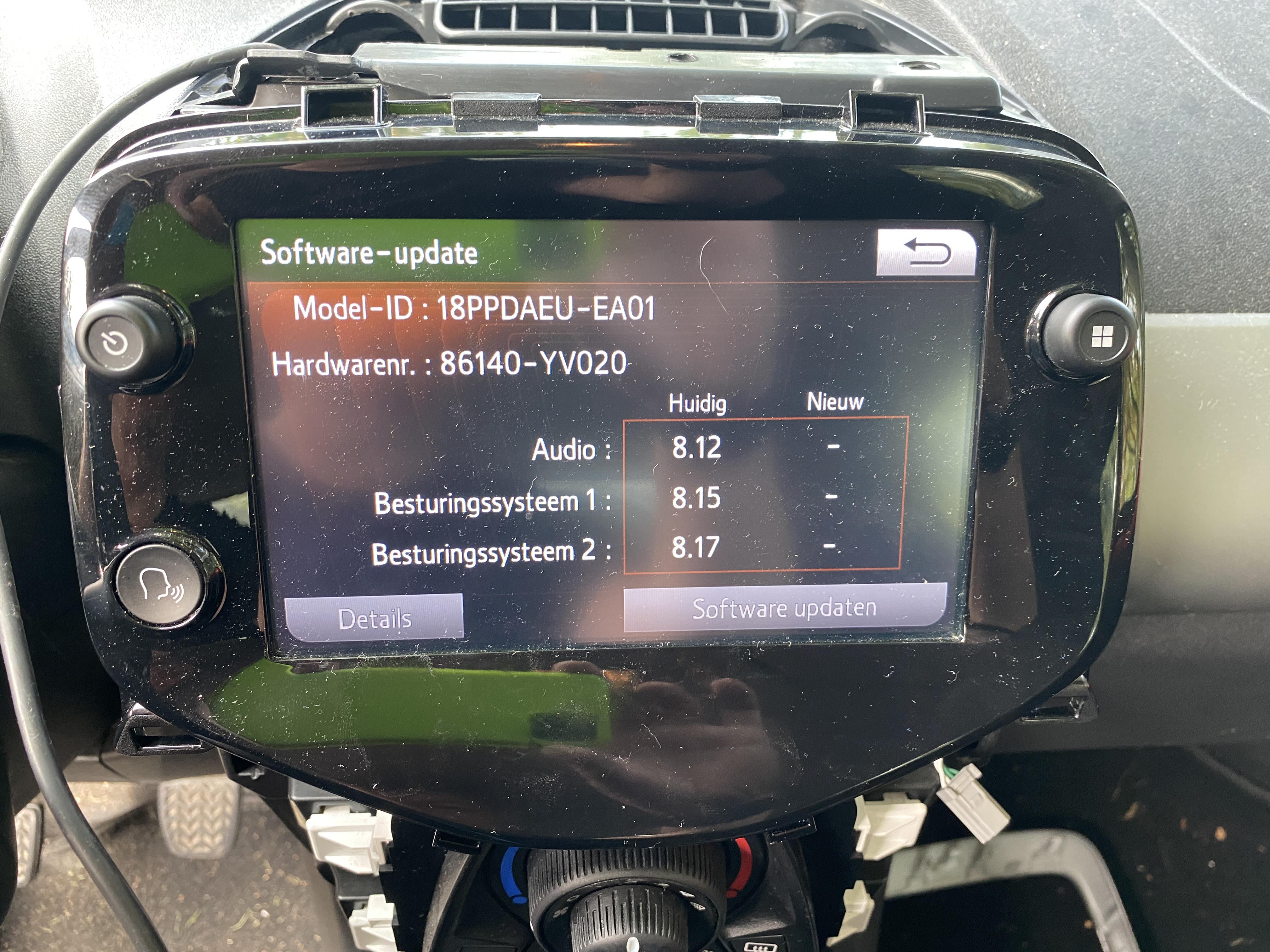

Hi to all,
I am experiencing a problem with my 86140-YV020 (the DAB version) which I have bought to replace the existing more basic radio. The radio is working, car information is working too. Siri is working but I can't get the radio working with Apple CarPlay.
Took the car to the garage for a software update but there they told me that the usb port isn't working (but how can siri be working then?). I ordered another usb cable + port, but this seems still not to be working(?).
I can't ad the radio on my iPhone when connected though the 'new' usb cable. (all iPhone setting have been checked)
Is there something wrong in my approach; do I need a software update? Can anyone help me out?
Model ID 18PPDAEU-EA01
Softwareversions: audio: 8.12, os1: 8.15, os2: 8.17

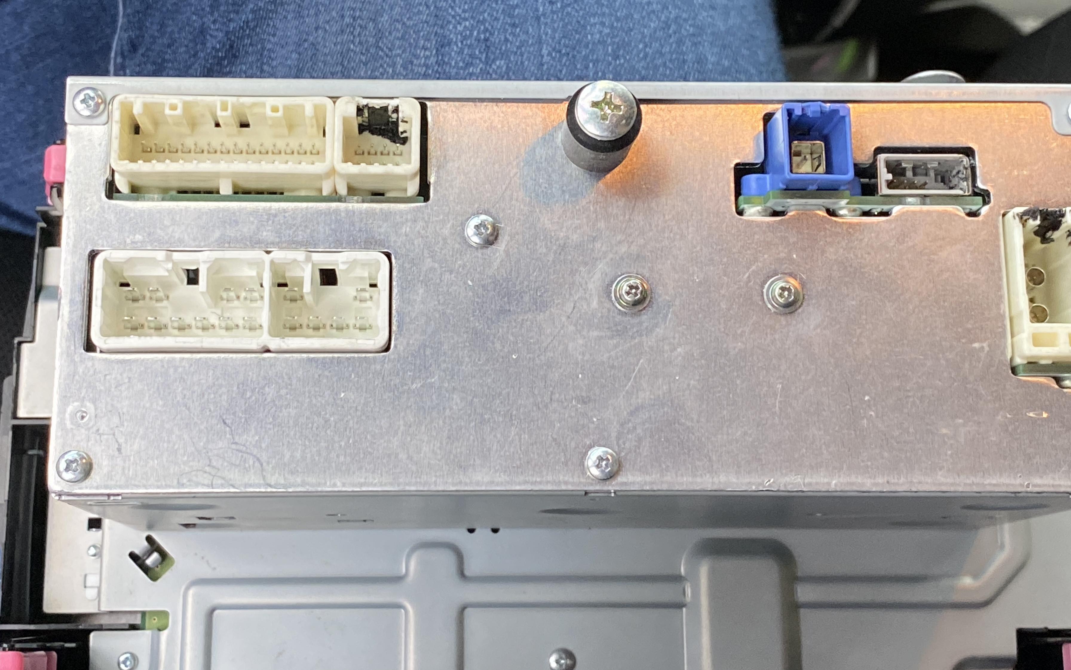

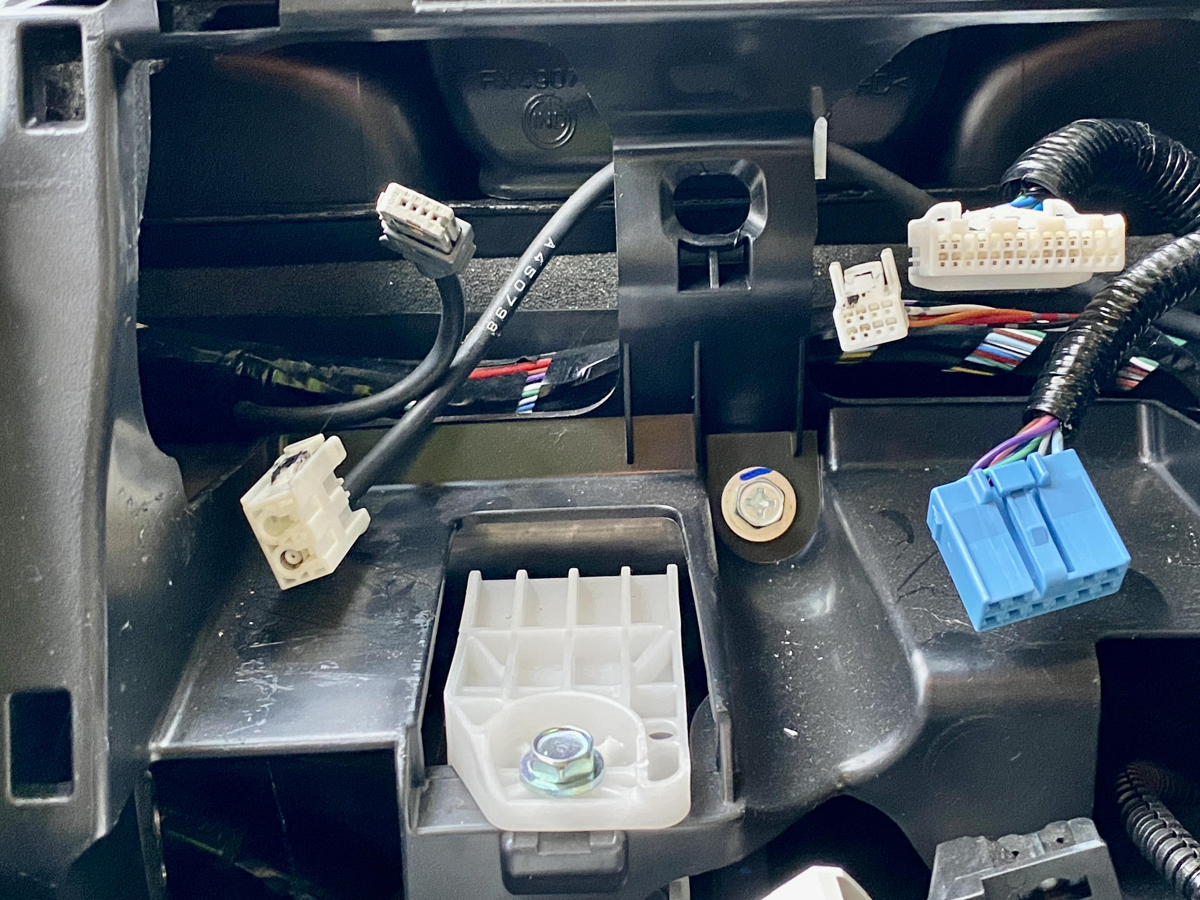

You have a current version, did you have the x-nav before you fitted this unit ? take a pic of the wiring behind the radio
Hi flash22, I had the 2 button version of the radio before, all connectors seem to be the same; I will take a picture later today (it still dark outside now).
I don't have x-nav because I am cheating a little; my car is an Aygo in disguise (C1). I could't find a fix at the Dutch forums where I live and found this forum so I posted my problem here too.
Will a phone charge from the usb ? Will it read a USB stick with MP3s on it ?

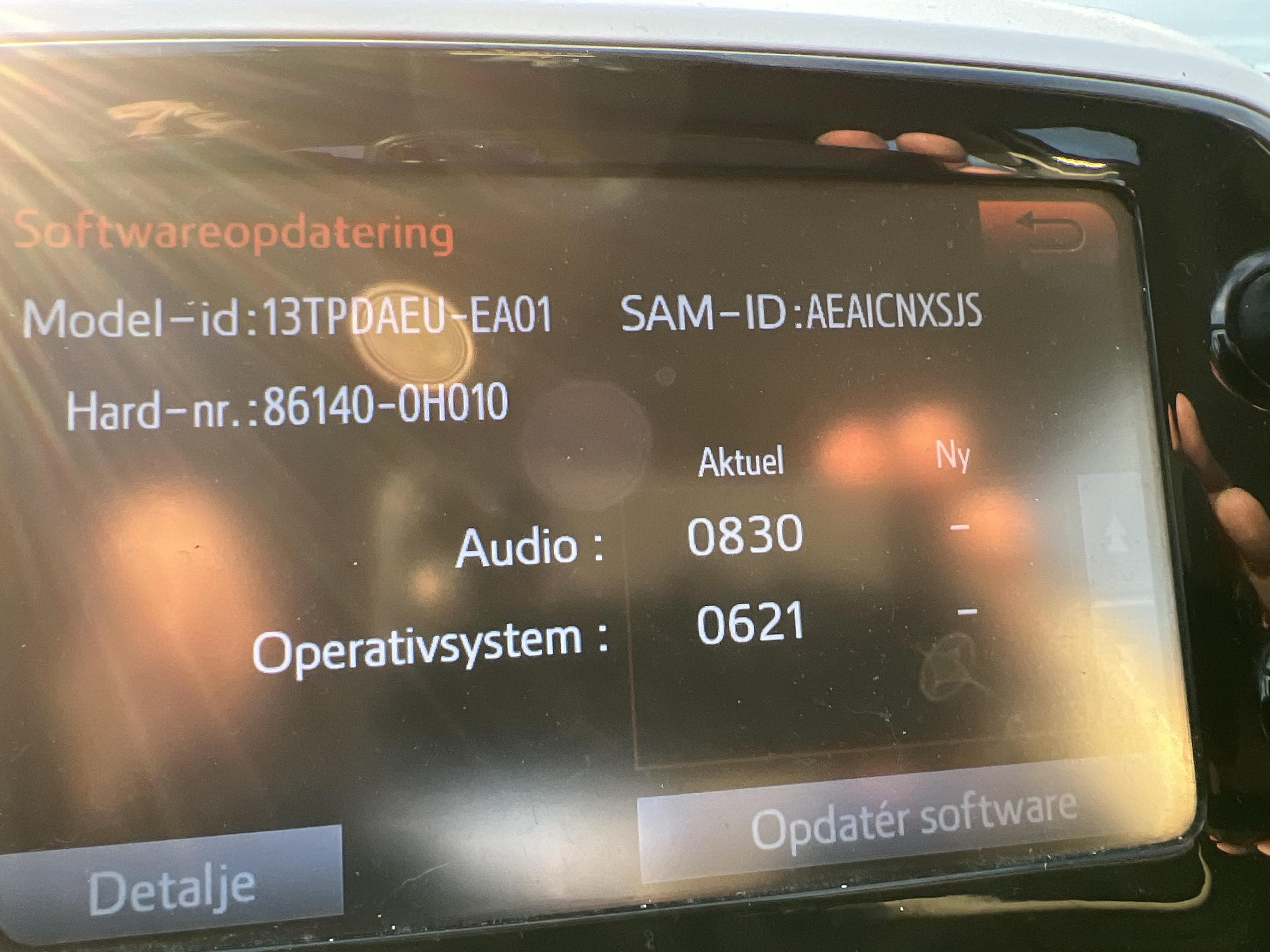

I picked up an Aygo 2015 a couple of months ago. I tried looking when I first got it for any software updates but couldn’t find anything but tried again recently and came by this post. Would you be able to provide me with the newer software and some instructions on how to install. Any help is appreciated!

7 minutes ago, flash22 said:
You have a current version, try a better quality cable
It's an Apple-cable (in effect, certified Apple) from the AMAC Apple store in Zwolle (NL), how much more "quality" does one need? Also using an Apple 14 Pro.
Apple cables, are inferior quality for what they cost, and they fatigue with use very quickly - cost to manufacture is less than €1
try an Anker cable that are Apple MFi certified, Apple's implementation of BT can be flaky at best, a single update can break it

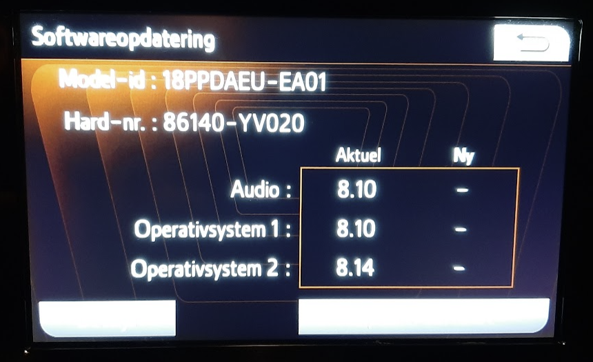

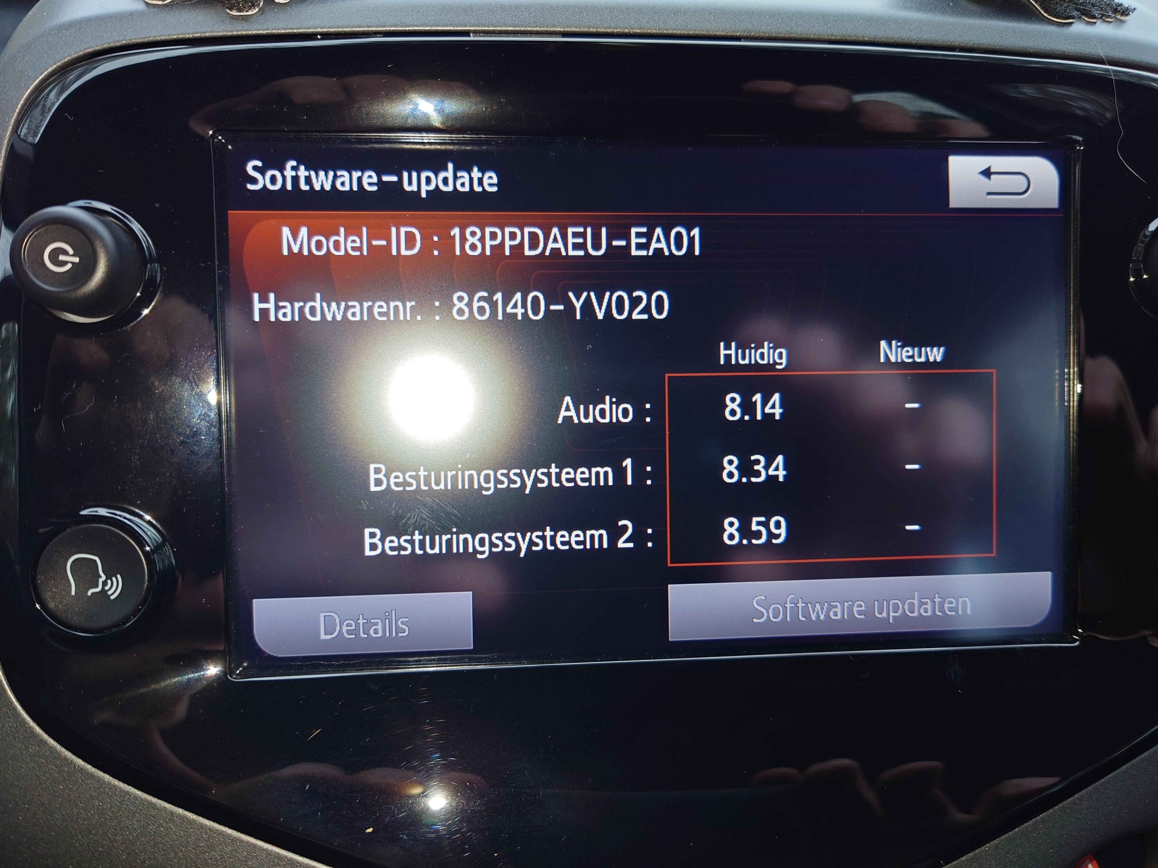

Hi, man
Do you have 8.14 / 8.34 / 8.59 software? If so, may you send it?
I am running  8.12 / 8.15 / 8.17 on DAB radio...
Thanks in advance
