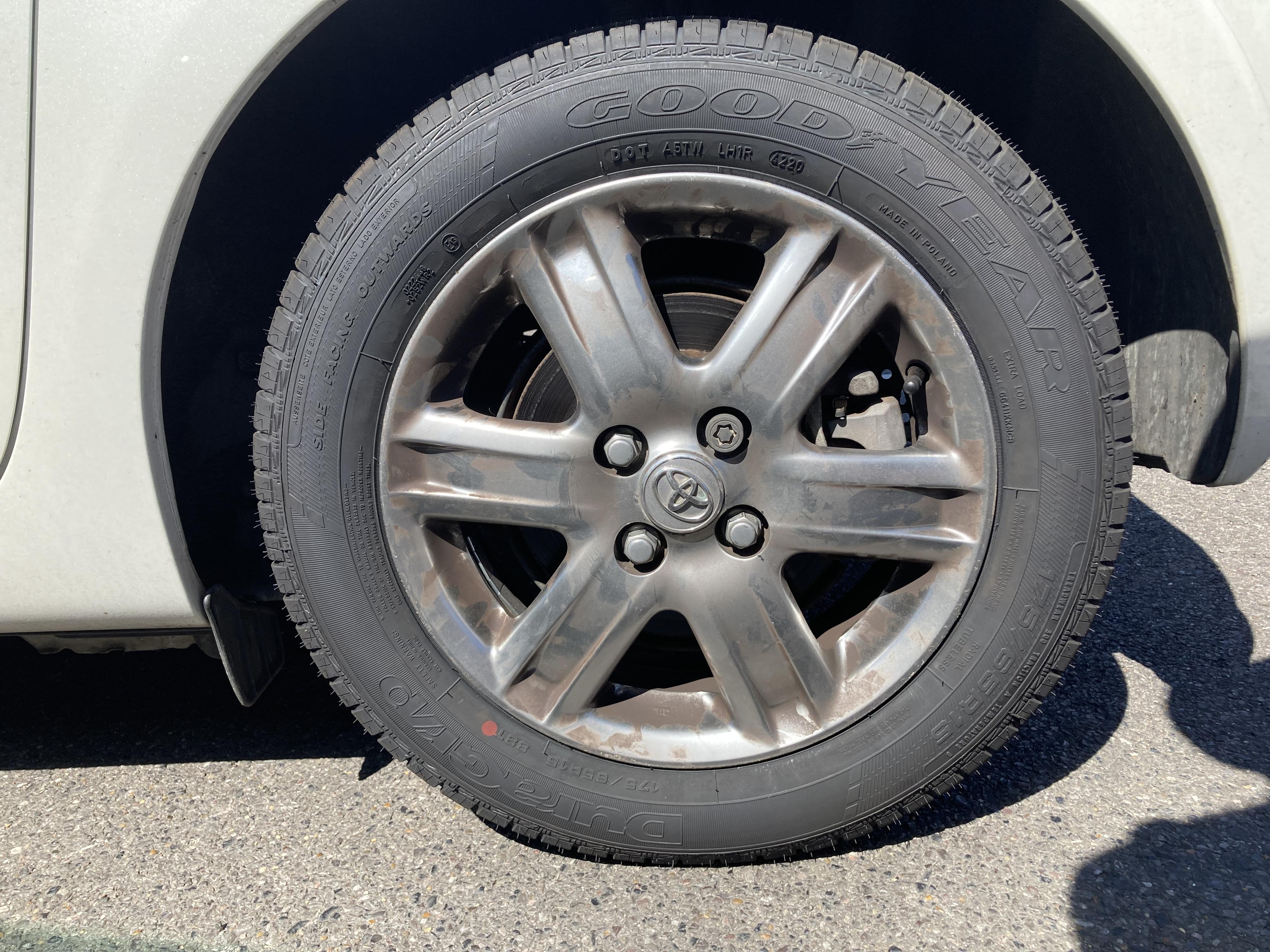

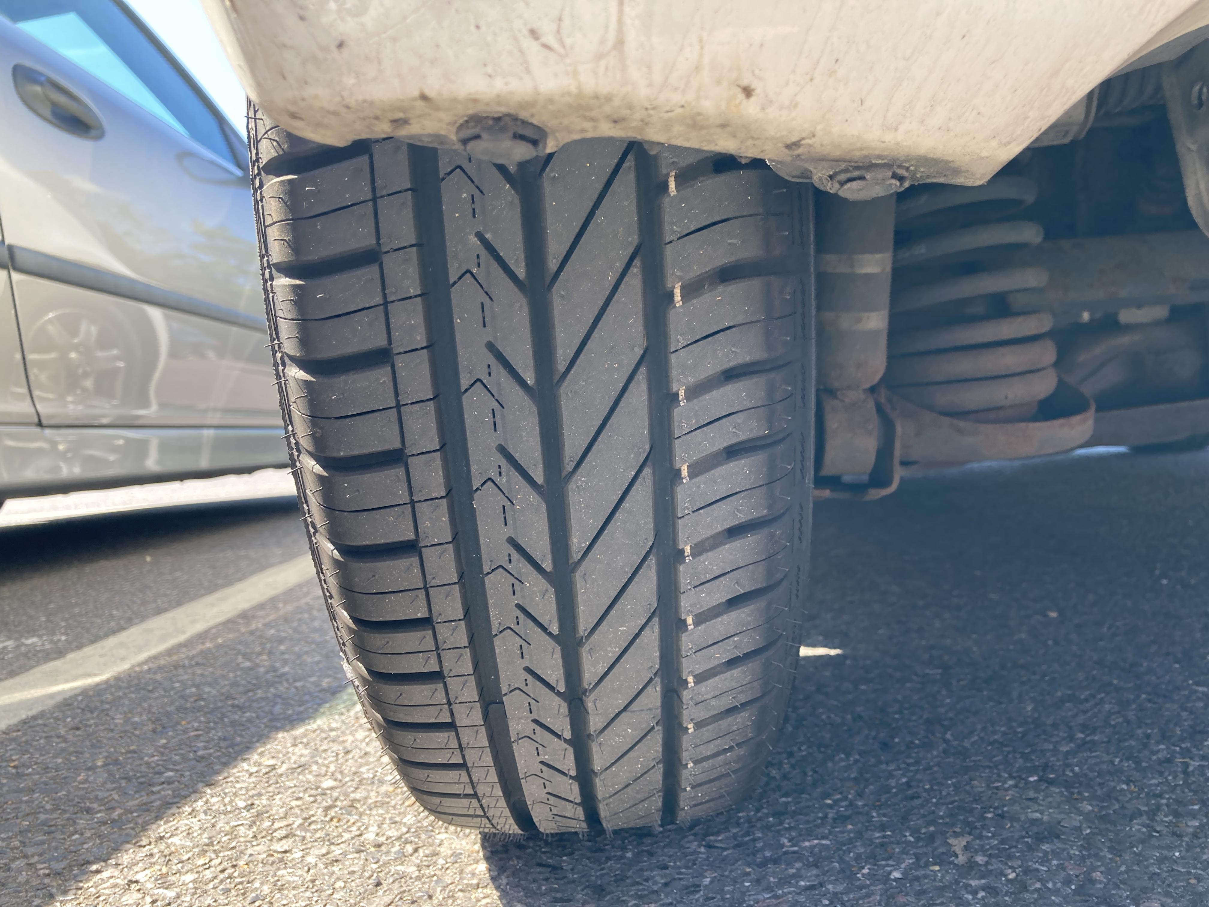

Hi,
I've just had budget ditch finders removed off my daughter's iQ and replaced them with Goodyear 637E4B50-3FD9-406F-BF73-725D2C95A9EA.thumb.jpeg.92eec4c622472cce7fb5638cd25e5f39.jpeg Duragrip tyre, £300 for all four, fitted, new valves, balanced and alignment checked (and adjusted).
Does it ride like a limo, of course not BUT it certainly rides AND steers better.
From previous experience (on other cars Michelin Cross Climate 2 give the best performance spread of comfort / grip / noise etc and have the advantage of M+S rating with snowflake symbol. I just didn't feel the use of the iQ warranted such a good all-season tyre hence why the Duragrips were chosen, you might decide differently and I wouldn't knock you for that.
Whatever you buy, make sure the tyre pressure is checked / adjusted to manufacturer guidelines.
Good luck with your choice 👍
