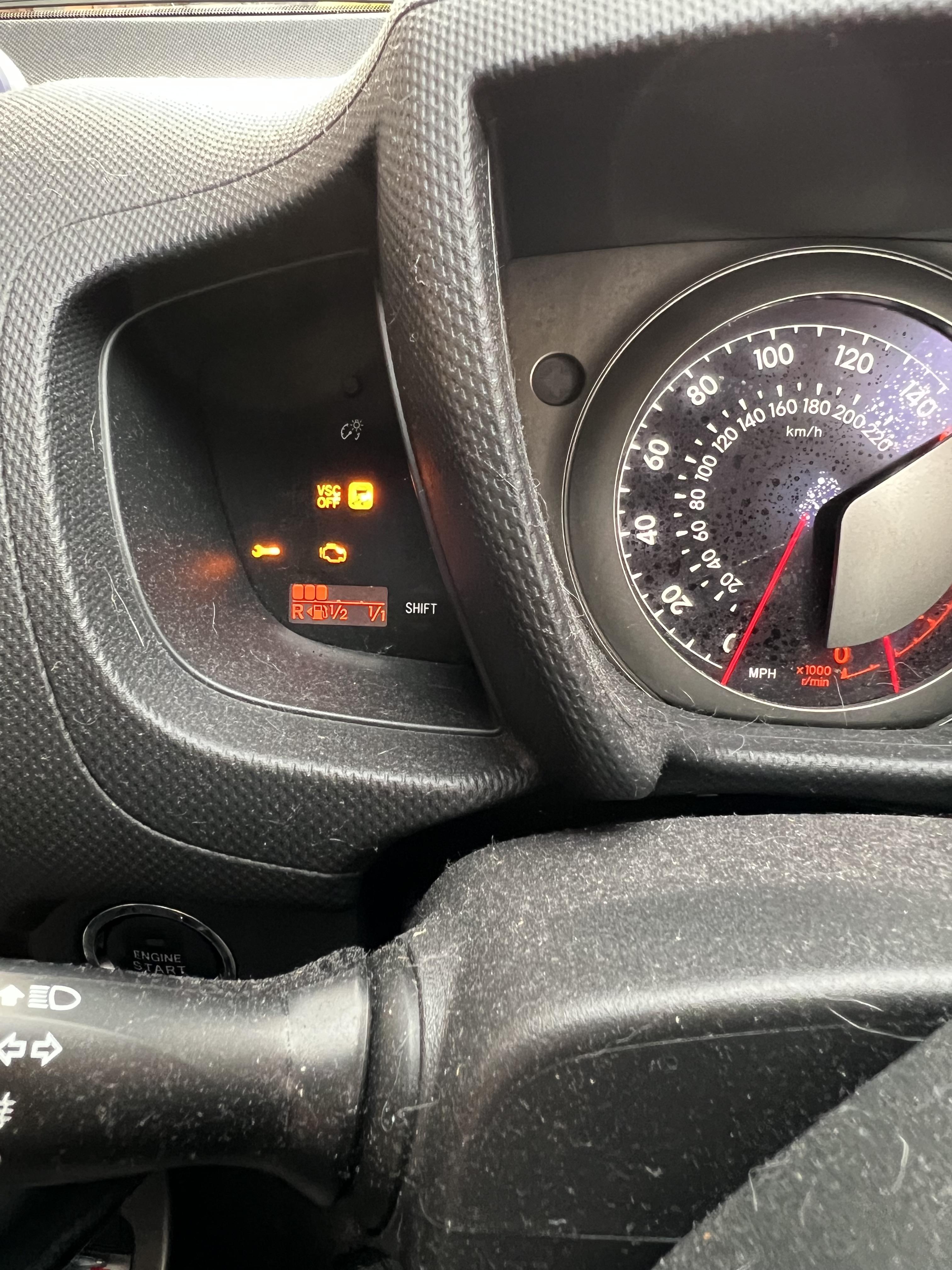

Hi everyone, had a load of lights come on photos added. 4wd, engine light .vsc flashing and the one with the skid lines  help please , some loss of power
Hi,  I have a very same problem.with my car, did you mange to get them lights sorted ?
Get the codes read, Toyota's light up the dash like a Christmas tree to say hay look at me, i have problem
