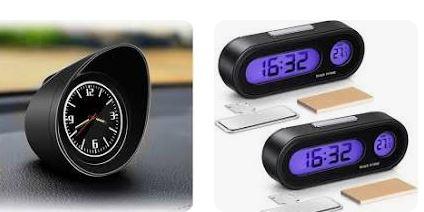

Expect you can find a s/h part from the online breakers if needed or fit one of the many aftermarket clock modules if seeing the time is important to your good lady.
