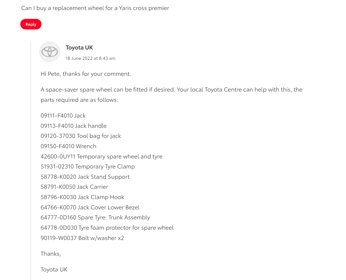

Hello fellow Yaris Cross owners - since owning my 2022 Yaris Cross Excel, I have been researching why I have a tyre repair kit and not a spare wheel as standard? My extensive research to now has revealed that the UK version of the Yaris Cross has a repair kit included simply to keep the vehicle weight within a defined taxation class, a space saver wheel is supplied as standard in non-European models. The good news is that there is a space saver spare wheel complete kit available in the UK. It comprises of space saver wheel and tyre, jack and necessary tools, support former to fit onto the wheel in the boot and the wheel/tyre clamp for the boot. I have ordered, received and installed the kit, absolutely perfect. It is available from toyotadirectparts.co.uk at a total cost of £230.99, including VAT and shipping. Toyota Direct Parts are absolutely fabulous to deal with - they are a main Toyota dealer located in Swindon (Fish Brothers) and they come highly recommended for efficiency and service.

The parts list has been shared before, but it is good to know that this is available as a kit. I ordered the rubber mat set from the same website/dealer.
It is a shame the wheel kit won’t fit in AWD models.

The kit will fit any 2wd Yaris Cross, spare wheel is not possible in 4wd

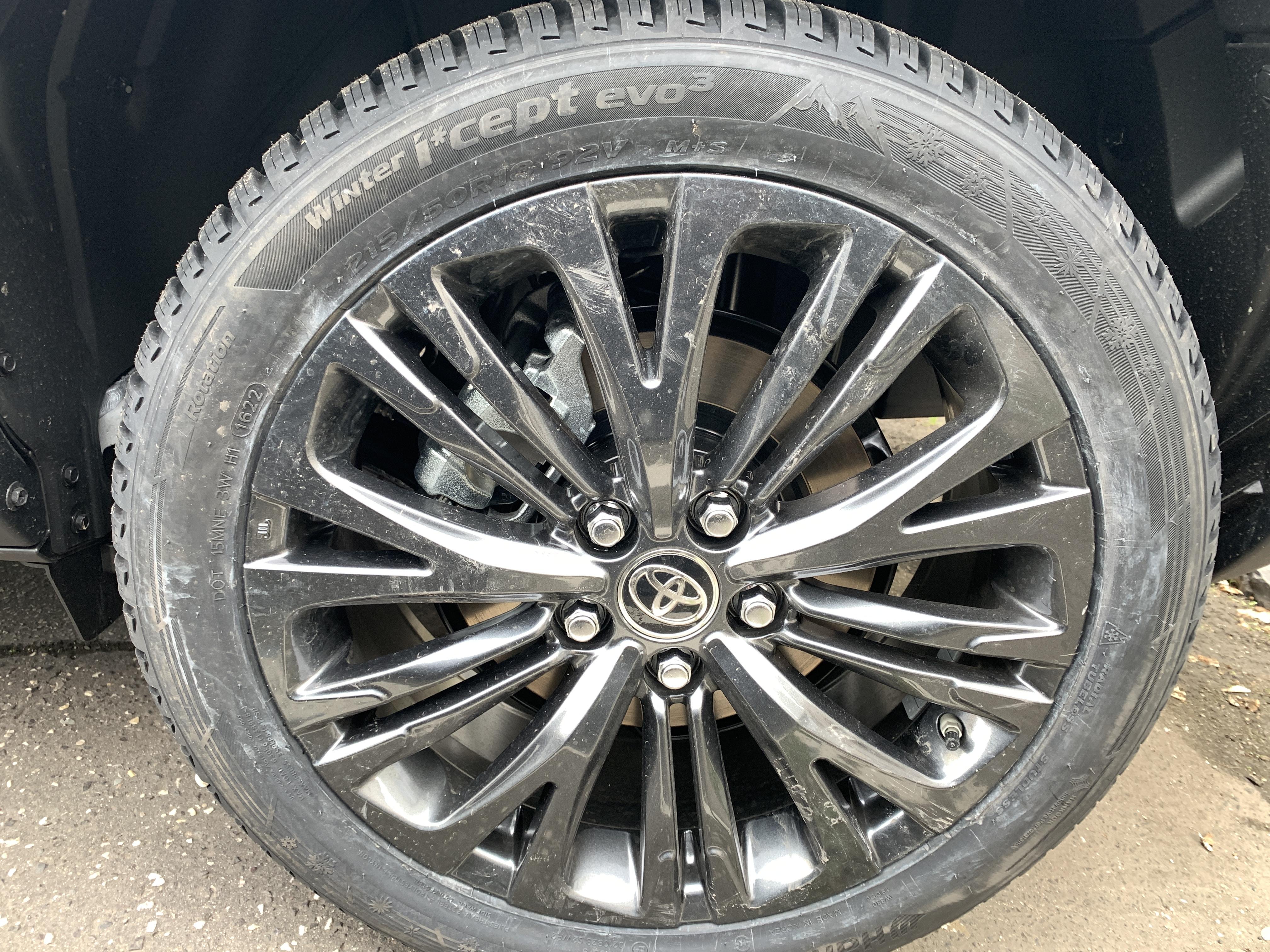

Nice winter tyres I can see here ❄️🛞👌
How do you find them in comparison with the summer ones? What were the summer ones fitted to the car ? Goodyear or something else?

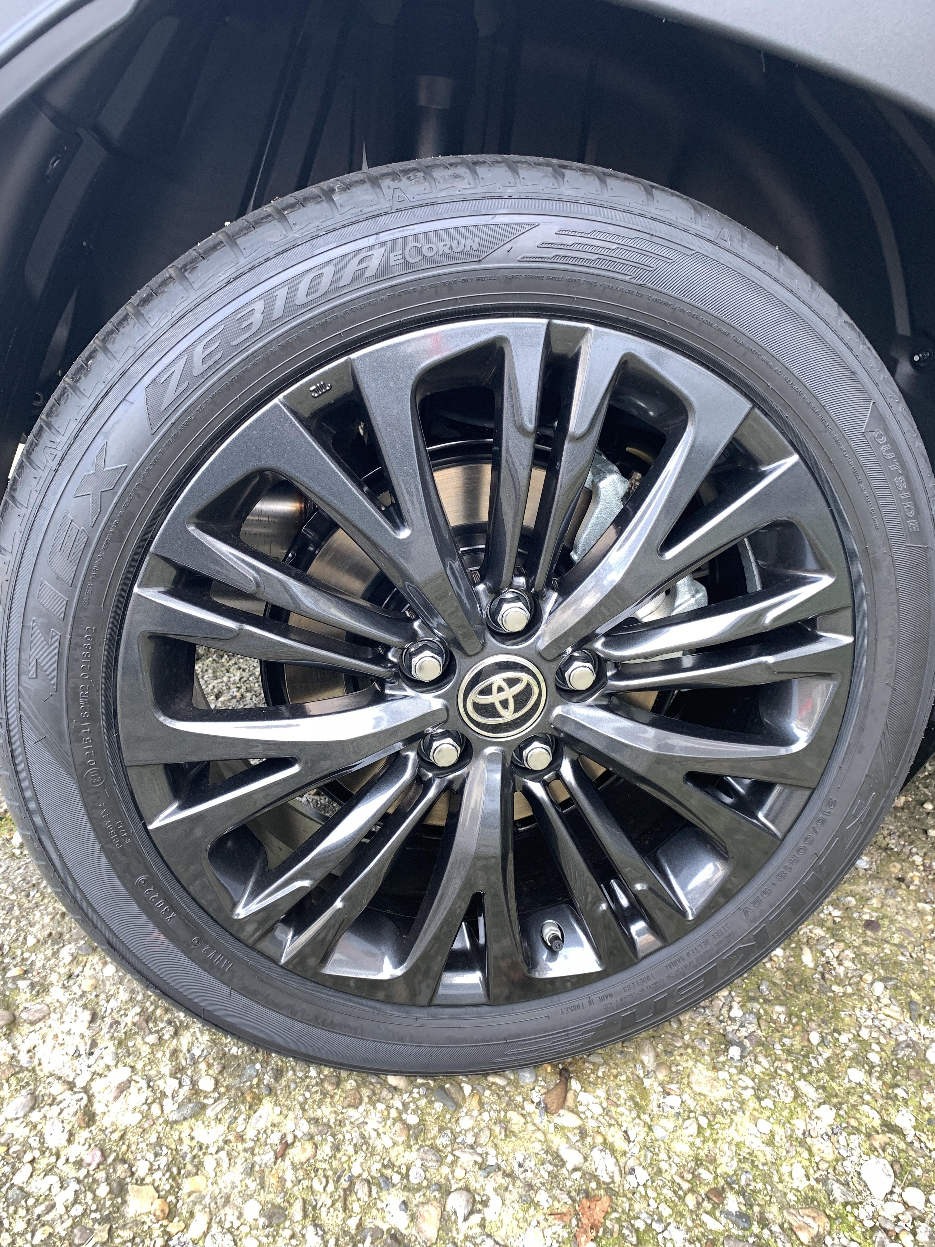

Thanks 🙂 Honestly haven’t been able to do much of a comparison since the car arrived a couple of weeks ago and the temps here were already dipping below 7 deg so did only one trip about 400km in total on the summer tyres (Falken Ziex ZE310A) I feel like the winter tyres have a firmer ride but I could just be imagining it 😅816F31AE-61E6-4AAF-8EE9-901A57443656.thumb.jpeg.b146a3bfddd88327765399a0692f34d0.jpeg

Usually winter tyres are softer than summer ones but sometimes can be the other way around. Interesting here is that those Falkens are made in Turkey as the wheels too. Turkish people seems to be a leaders in car and car parts manufacturing in Europe. 👍

Hah! see it’s probably just my imagination or maybe coz it’s the missus driving now and I’m just getting used to being a passanger again 😅 Yeah, I noticed that they’re made in Turkey, that’s great!

Toyota offer an accessory kit to allow fitment of a space saver, see HERE it will NOT fit a 4wd model as there is no room for any wheel on the 4wd

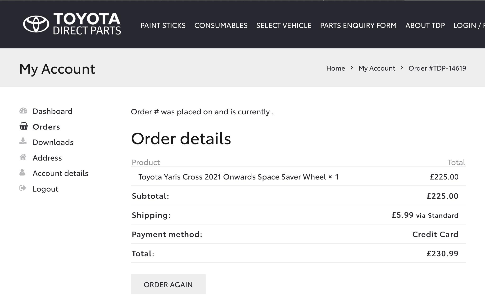

I finally ended up ordering a space saver from the dealer, now just need to buy a jack and it should be all done 🙂 The full kit was quite pricy so I just got the tyre and the foam insert to place on the tyre.

Have been looking for a space saver wheel.And I found the wheel shop and gave them a ring.
spoke to a very nice helpful lady gave her my reg number.
She told me 17in 149.95 plus wheel retaining bolt 12.95.
Okay so I ordered then I asked can I be little a bit cheeky is there any discount yes and gave me 5% very nice ordered Wednesday arrived Friday 28C845BB-C15D-4816-ADD5-65C359509680.thumb.jpeg.ecec0962e272b473705d31cfdd8bd04c.jpeg
