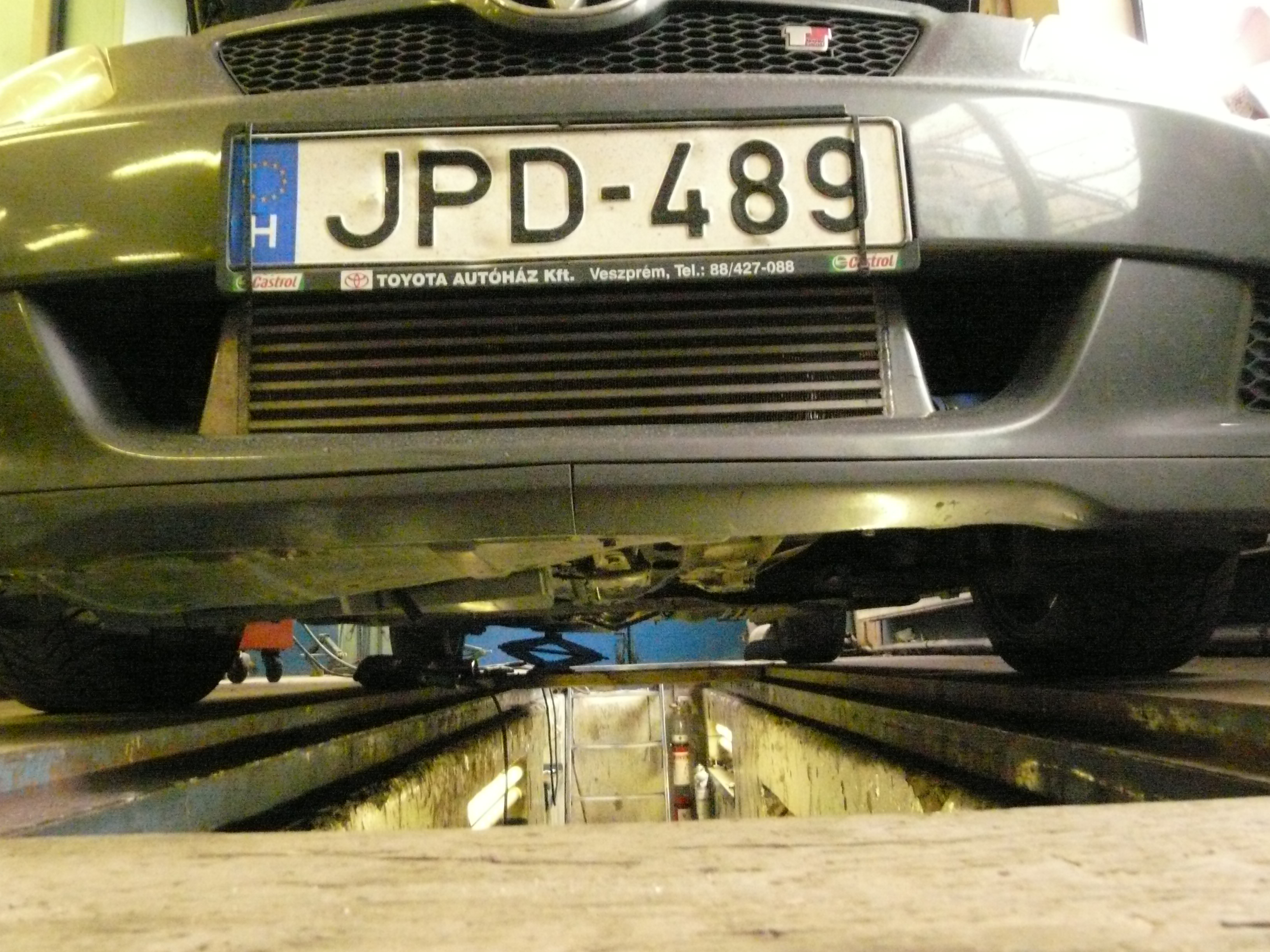

hoping pressure drop isn,t to great as have raised boost anyway .intercooler should be ok size wise as its for up 300bhp and got car booked in for piggy back ecu and remap .no wot u mean regarding heat on a turbo engine but from having it running its amazing how much heat comes from supercharger which is passed straight into engine so should be improved once its cooled .

Looks hench mate. I love the look of inter-coolers. :drool:
Using a cooling matrix in the I.M. works wonders for forced induction, especially with a large ice-box. :)
update on pics lights all came on today check code lean on bank 1 but to be expected car needs setting up now so will use least as possible till its piggyback done and mapped .
WOW, thats looks really good, bigger than my intercooler. Yeh the car will b running lean rite now, try not to drive it too much. Dnt worry ur in safe hands going to Redline Tuning, Richard knows his stuff.
Will b nice to see ur car wen ur down. Will b interesting to see how much power ur cars gna push out
Mhmm car is looking sweet, Thats a massive intercooler makes me wish i did the compressor upgrade on mine. Intercooler looks great with the tte bumpers.

Awesome mate, intercooler looks like a good size aswell as fits with the bumper really well
