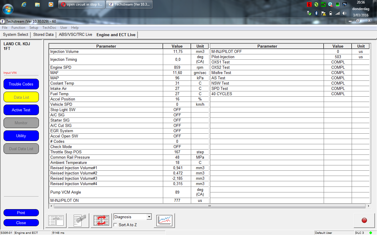

But when a did a live data i saw that injector 3 had a very different volume.
Is value in the standart's? And is it normal that 1 of the 4 give's a totaly diffent result.

+/- 3 is within specification.
