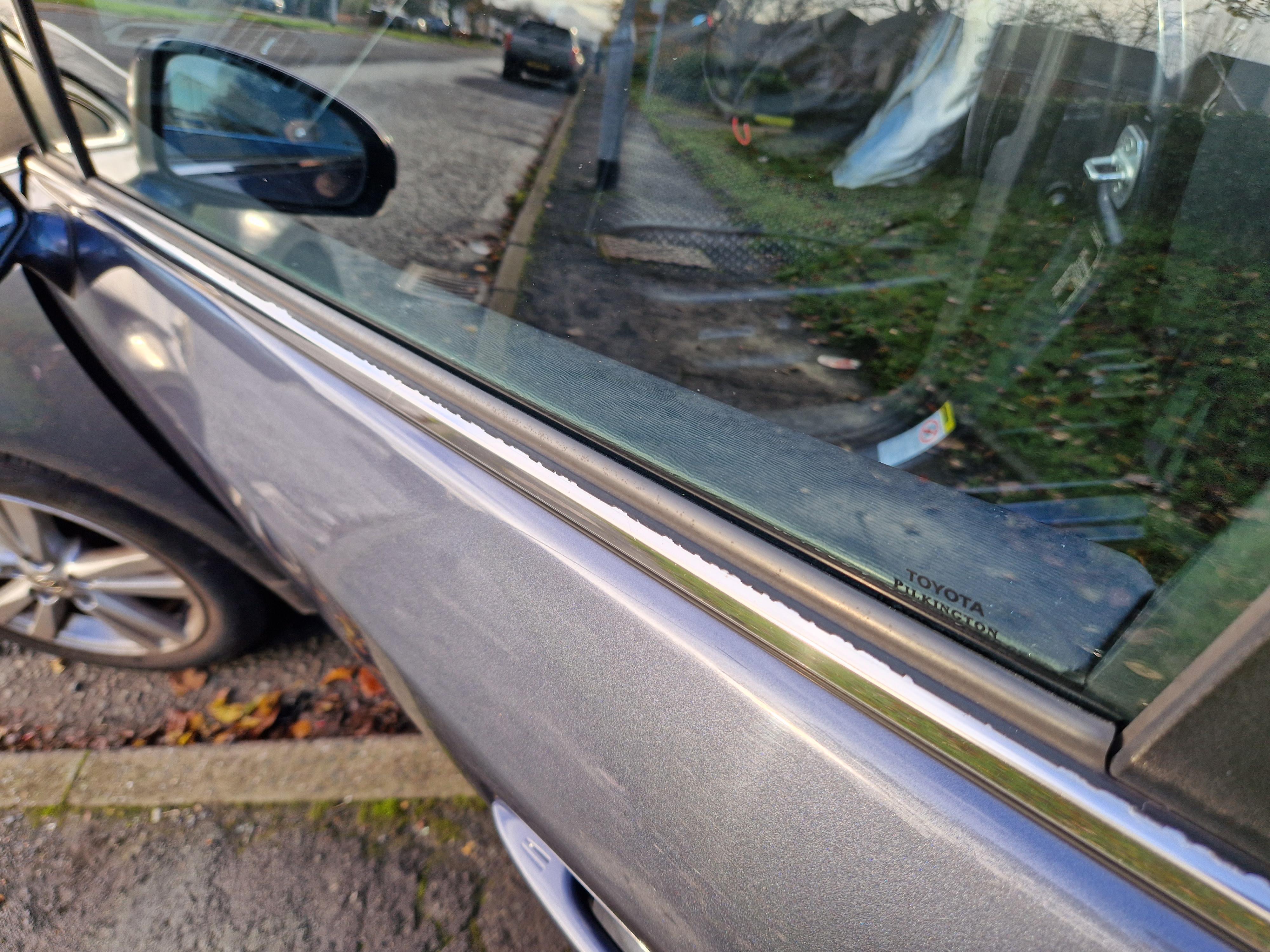

Could water get in past the external window seals? Mine are are quite brittle and frayed. Anyone else's like these? Or do the doors drain to the outside, so that water shouldn't get in?

Plus one for the cracked/brittle/frayed window seals as well....our cars must be twins!
Hmmm...
Are the windows seals supposed to press against the windows on the inside or the outside or both? Mines seem to touch more on the inside and in patches on the outside.
