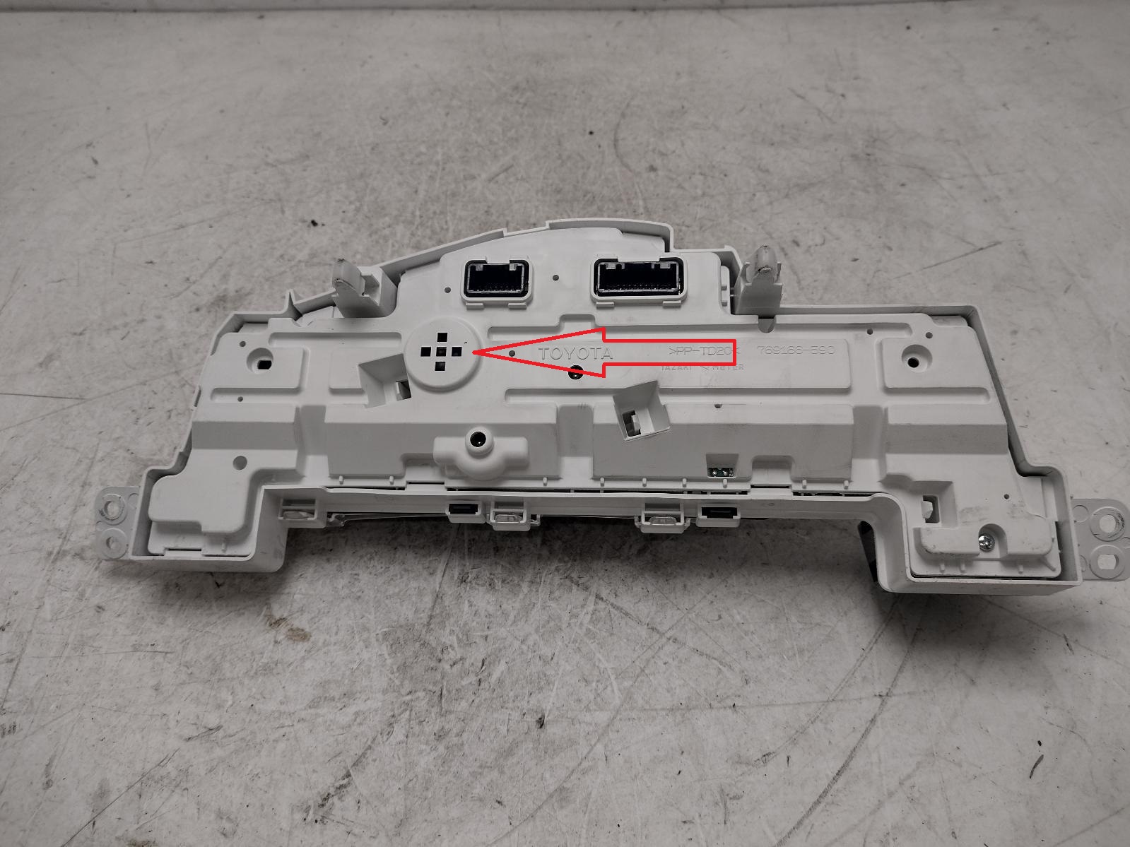

I'm not an iQ owner, but, just in case you didn't already know, the indicator ticking sound is likely to come from a speaker on the back of the speedo cluster (possible location arrowed in picture of iQ cluster), so, unless I've missed something here, any extra sound would have to come from an add-on unit that you'd have to custom-fit to the indicator wiring.

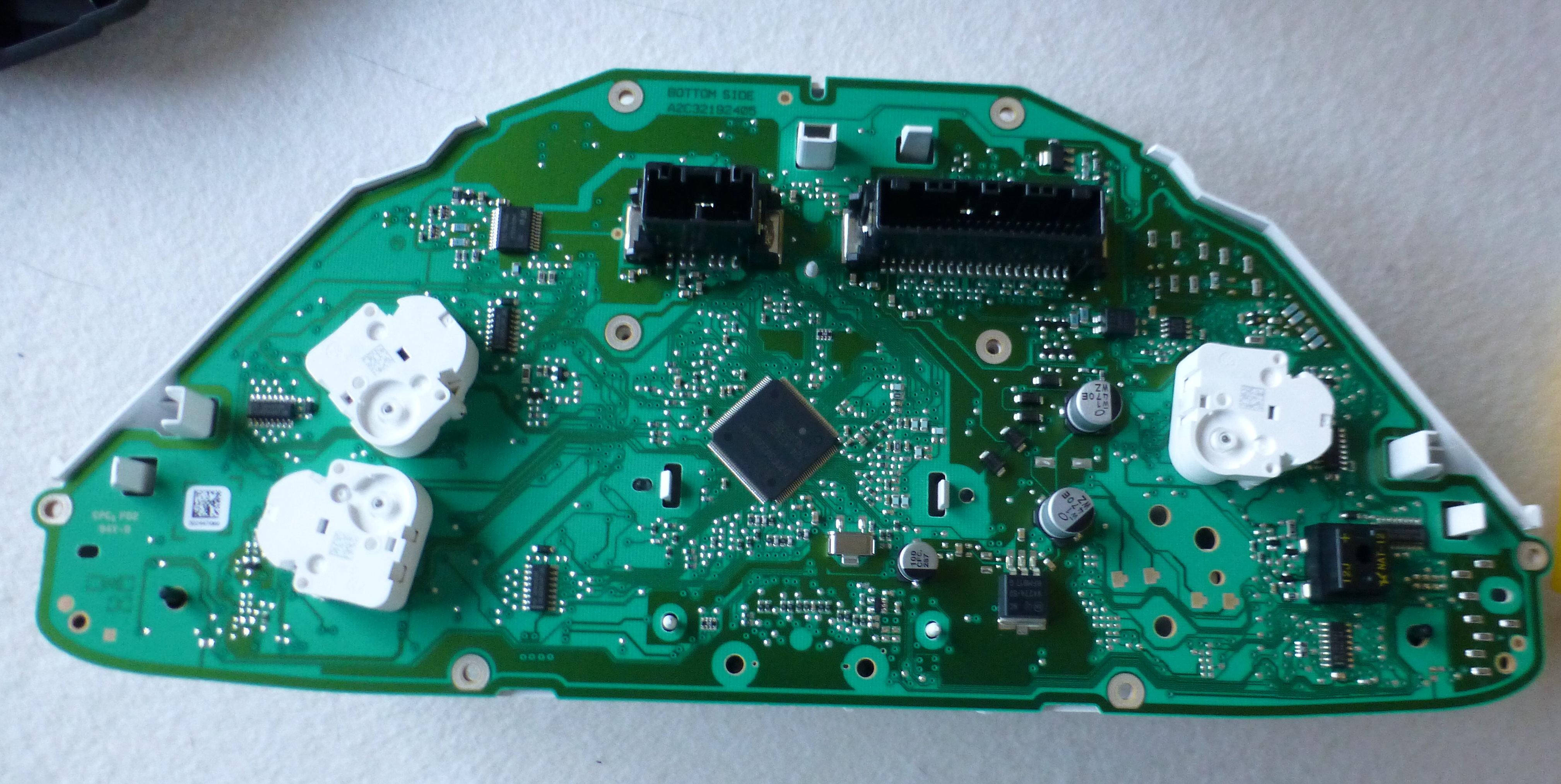

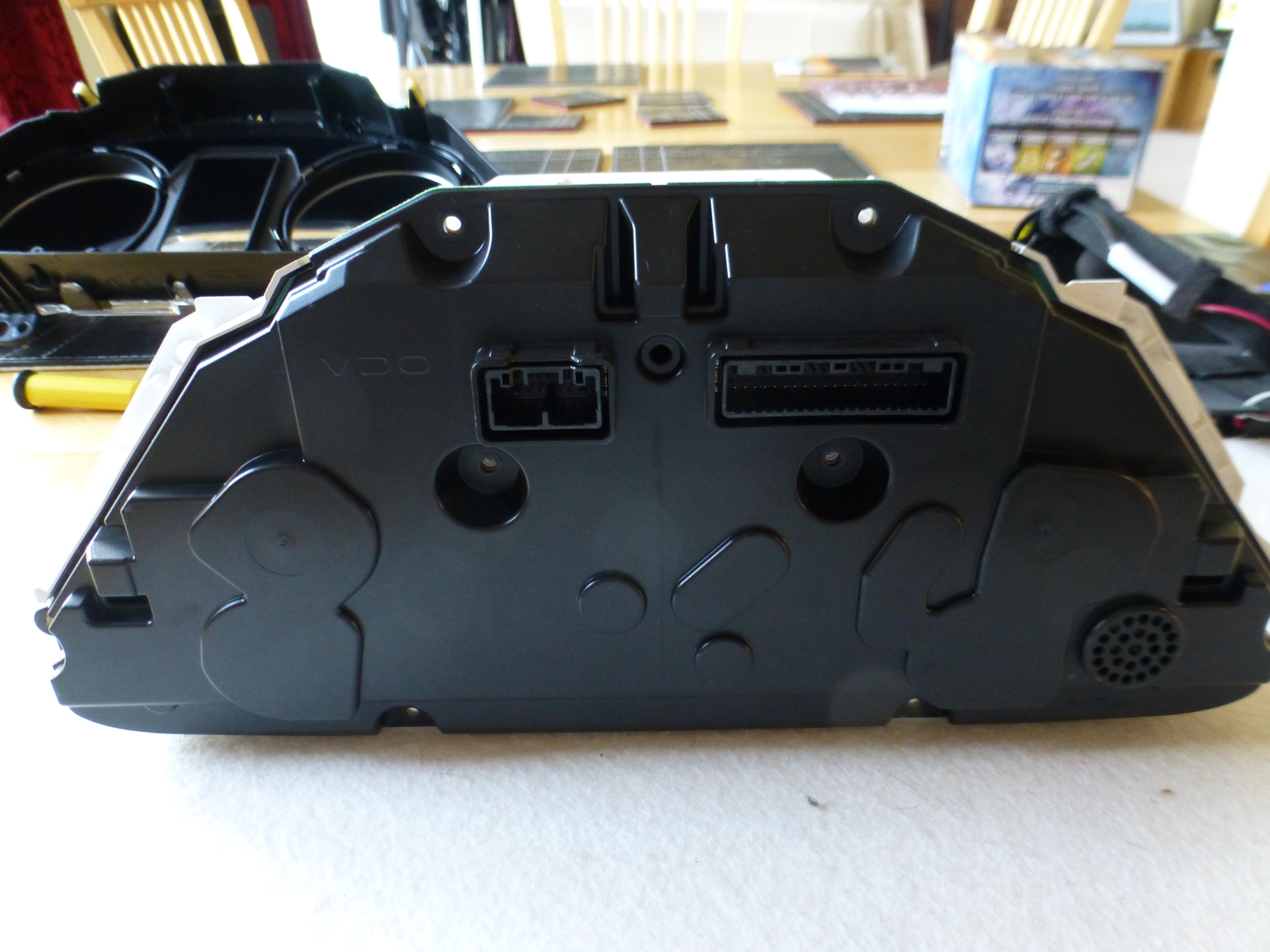

This sounds involved, but here are pictures of the speaker from an Auris dash, as an example, to give an idea of what's what.
Firstly, the back of the binnacle, circular speaker grille is bottom right on this one.
Rear cover removed (philips screws). This is easy on this car.

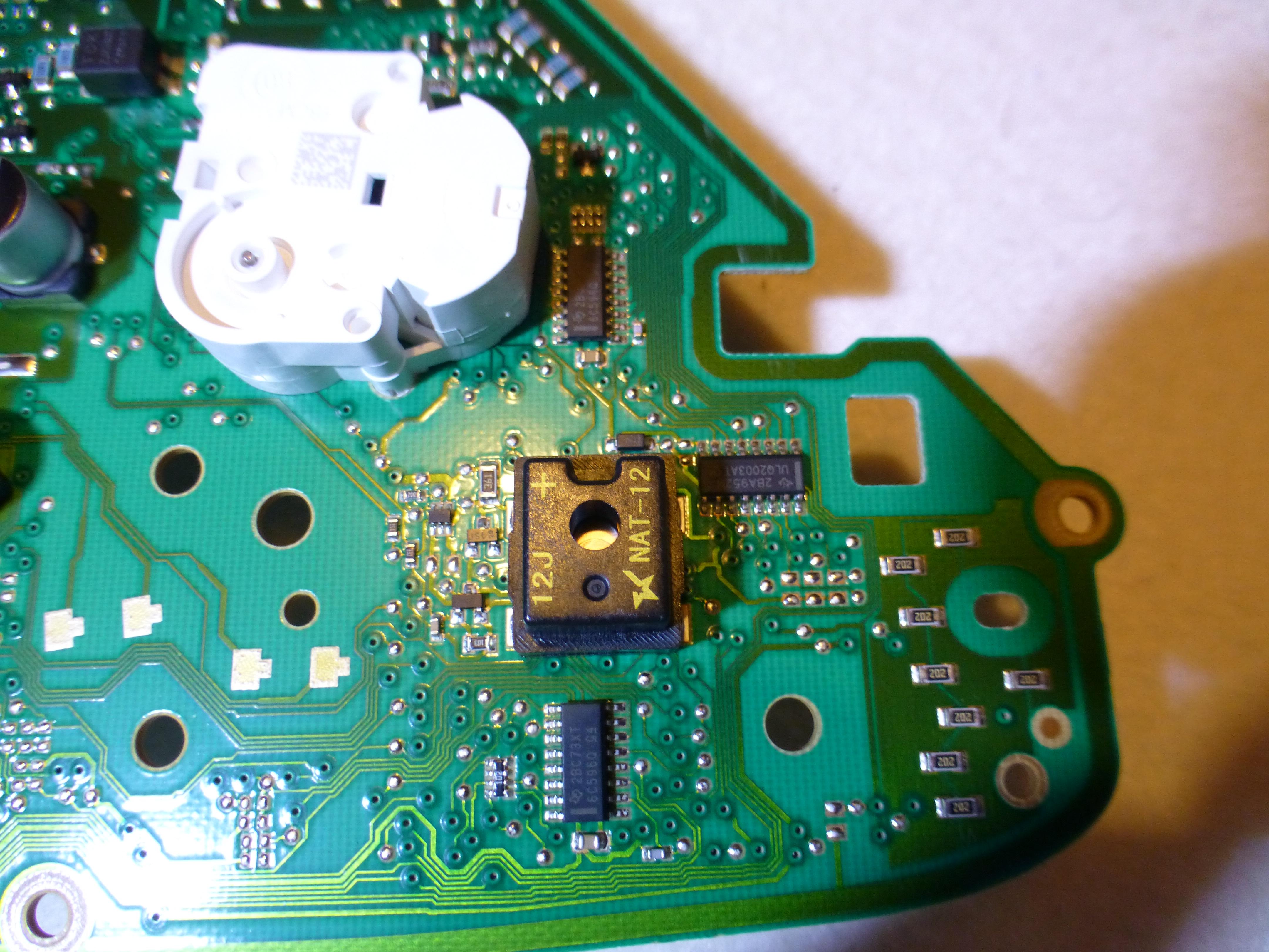

The speaker, close up. Looks to have four solder attachment points, but I think two are just for a secure attachment to the pcb.

I should add, I've not tried the above: I was looking in this Auris speedo to investigate a flickering LED problem.

Its possible the four connections are simple parallel sets of two, in other words there is continuity from side to side (or top to bottom). That's easy to check with a meter. Four anchor points makes sense as you say for mechanical stability.
Hard to make out in a picture but it looks like it might just be a Piezo buzzer of some kind (which clicks if you just apply a voltage in an on/off fashion)
They are used in zillions of things from toys upward and come 'loose' or in a housing. They are not polarity sensitive either.
If it is a Piezo then there is nothing to stop you wiring another directly across the existing one.
