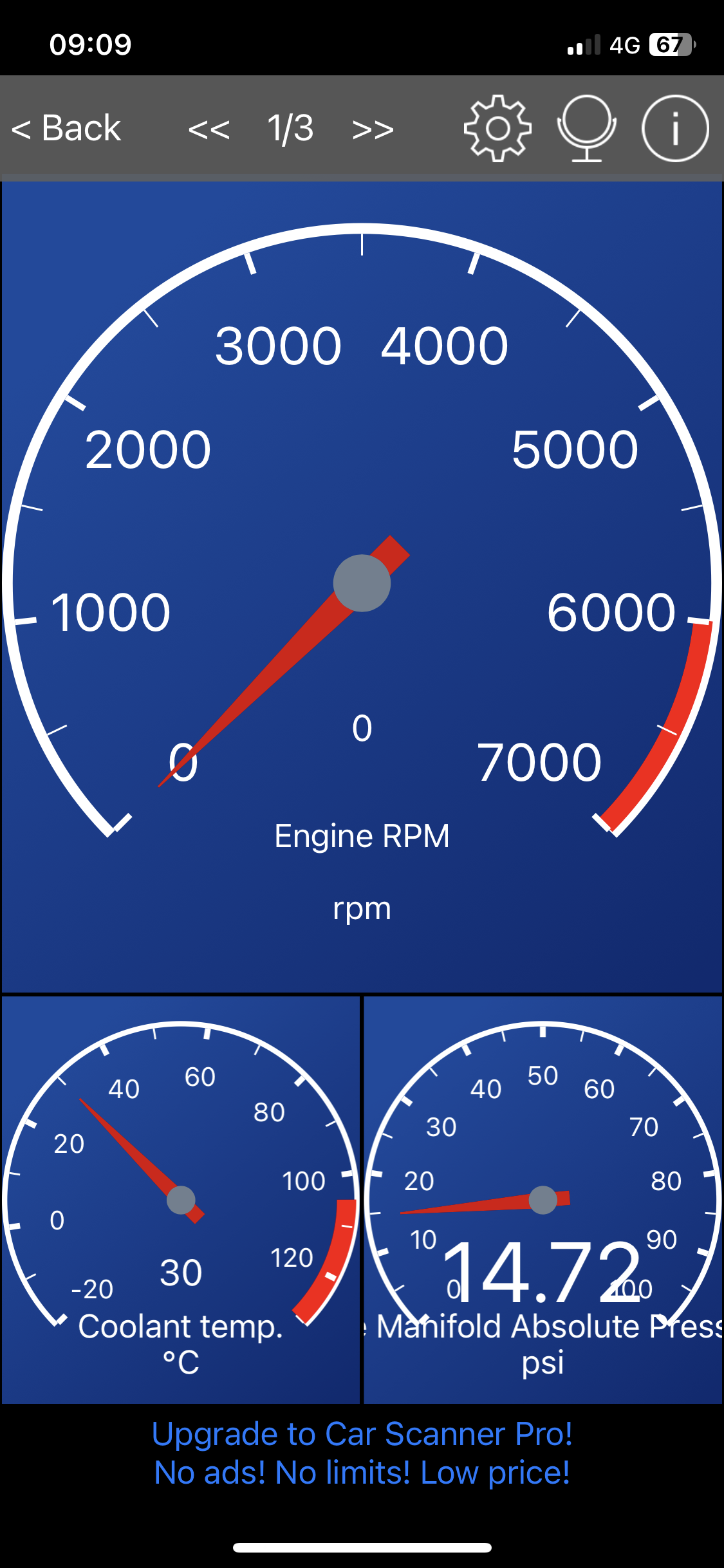

You can use Veepeak BLE OBD2 scan tool or Carly plus other makes via bluetooth to your phone.
Coolant temp. lower left via Car Scanner its a free download but you can upgrade to the pro version if you want six clocks.
You can change the RPM to temp if you prefer.
