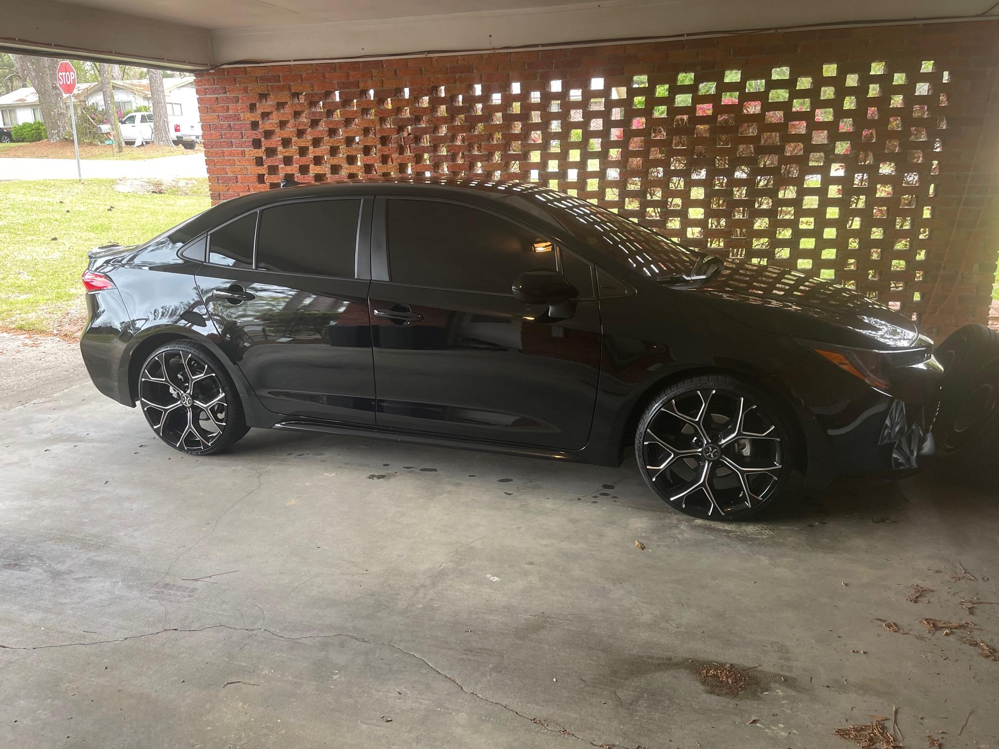

Ok, so I'm new to this forum. I have a 2024 Corolla LE and just recently had 20" wheels installed along with 245/35r20 TOYO's. I am still getting vibrating in the seats and floorboard even after rechecking the balancing 6 times and road force testing. Anyone else had this issue? Maybe I need hub rings even though the wheels are lug centric?

Those wheels are pretty cool, but wow, could not drive in the UK with those, they would be destroyed within a week.
