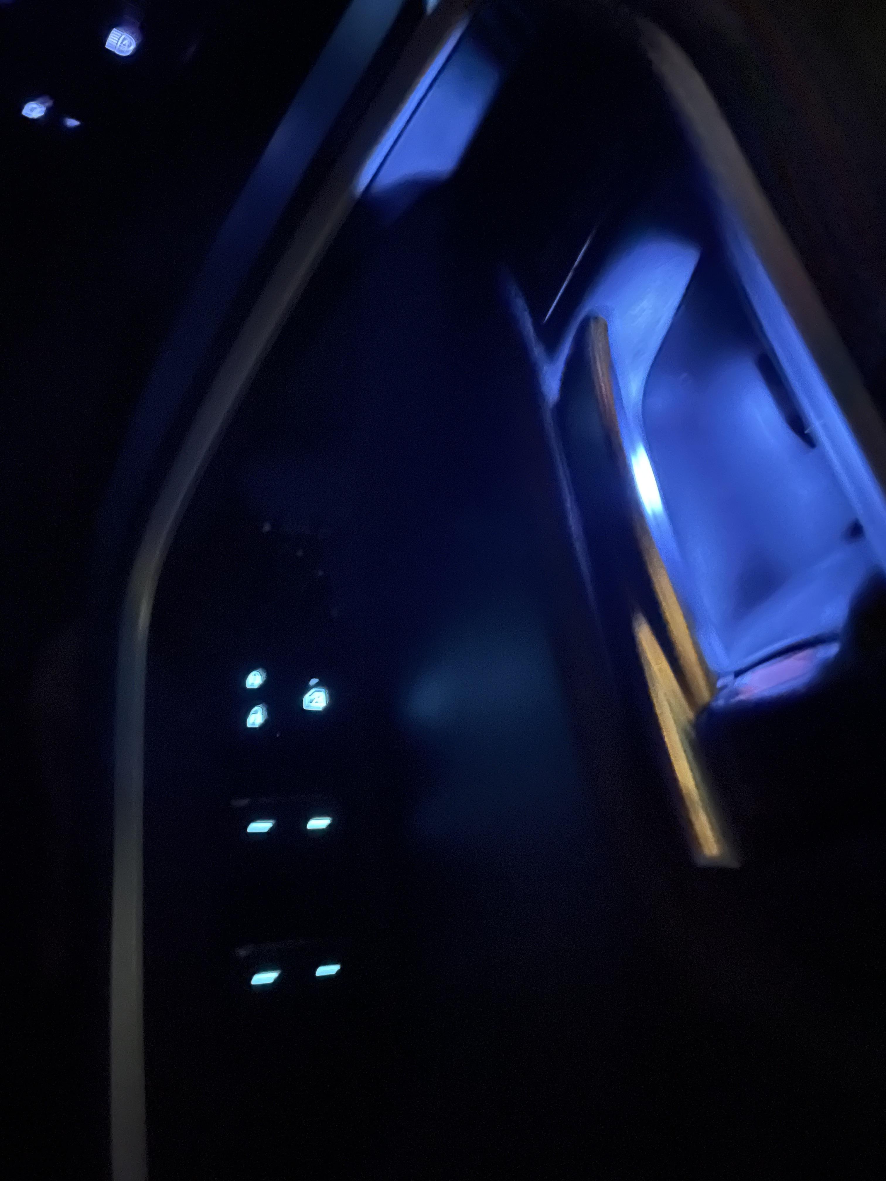

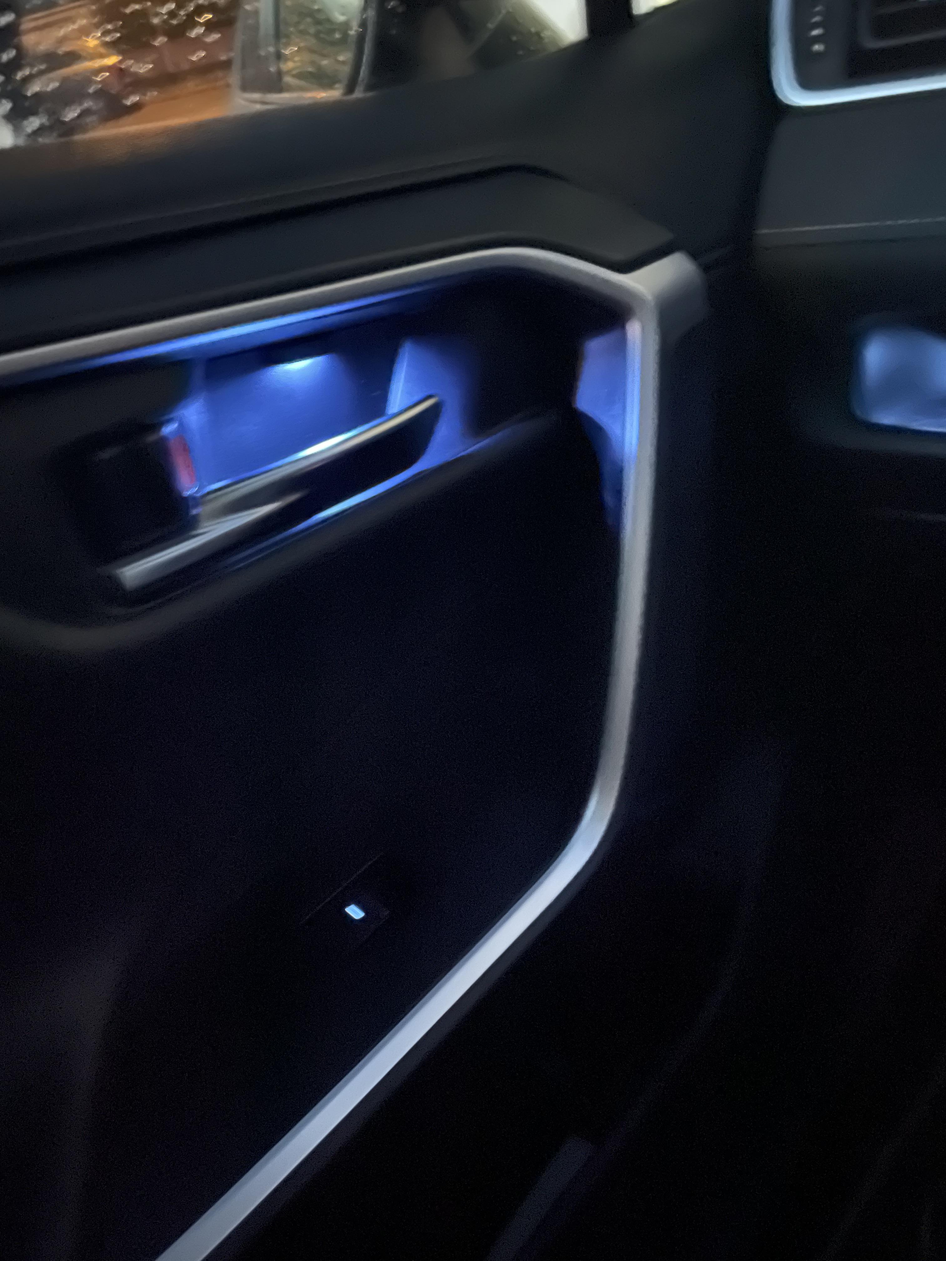

Received the RHD lighted swich kit from Cartrimhome yesterday and took about 30 minutes to fit to all doors. Great product - looks OEM and all worked perfectly. I already fitted the lighted door handle bowl kit and the wiring harnesses from that all worked with the new lighted switch kit. Really pleased with the look now.1602290841_IMG_5042driverdoorlightup.thumb.jpg.b18e2c265db9feed1598060826b9fcfd.jpg
Awesome, they look really good, can't wait to get mine.
