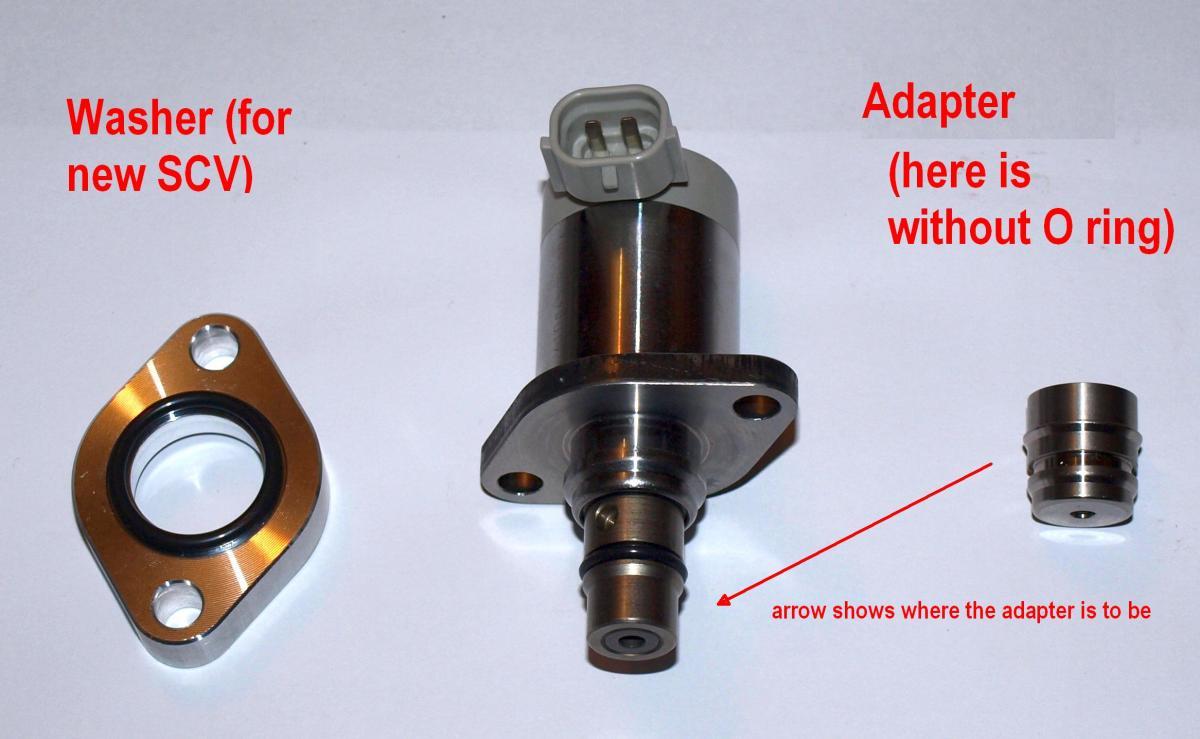

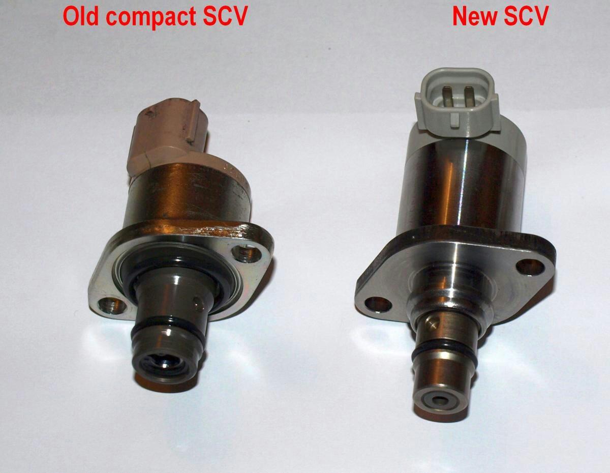

Cleaned it couple of times by applying electrical pulses (10 pulses/sec) in carburetor cleaner liquid , changed O-rings, cleaned EGR two times, Intake manifold, but after a while problems came back and I thing I need to replace the SCV and reflash the engine ECU.
 According to EG-0132T-1110-EN and older posts from this topic I have to buy a new part 04226-26020  which whould look like the "New SCV" with 90°, Adapter and washer, right?
But when I look for this part  04226-26020  on any other car parts retailer, I get an exactly "Old Compact SCV" and the "New SCV" has next ordering code:  04226-0L020  which seems to be a part only for ADT250 (2.0 D4D) engines.
Please, can anybody make it clear for me? Am I missing some piece of information?
Is the New SCV suitable also for 2.2 D4D ?
