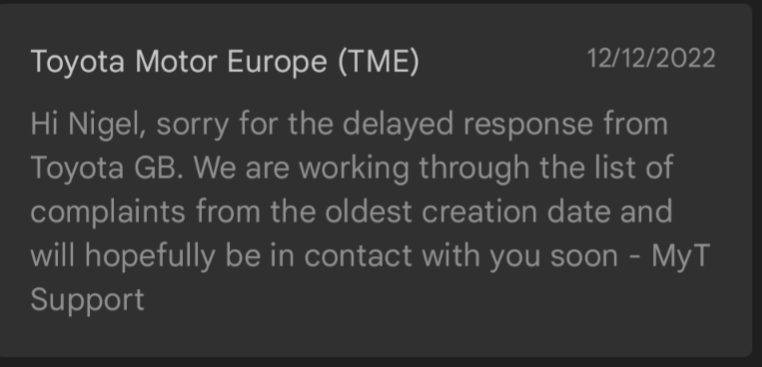

I've still not had a response from my contact in the app, or Toyota GB. I got this generic response from putting a review in Google Play....
Seems like they have a looong list
