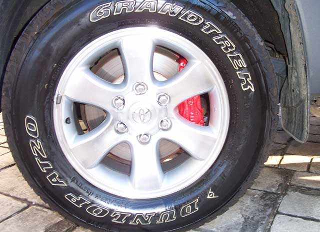

Ah soz miss understood, yeah the front calipers would look mighty in red, but the car has rear drums, unlike the G6R, so I'm looking at a rear disc conversion. Just wondered if I could up the disc size first :thumbsup:
