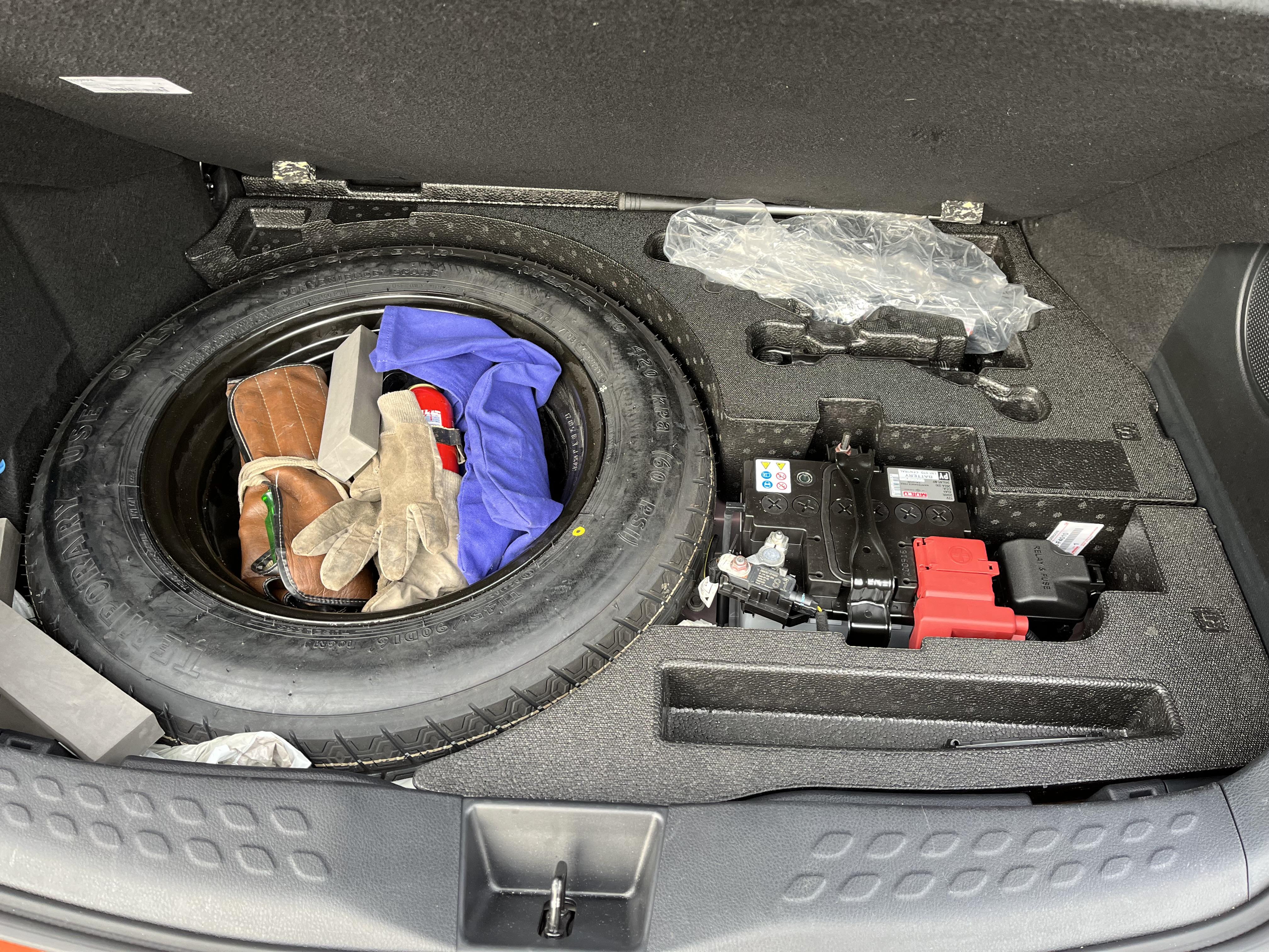

Hi all.:driving:
I have been reading this tread with interest as am new to the Toyota forum and even newer to the C-HR.
I decided to take the plunge and get a space saver wheel it was a no brainer not to me as had several puncture which a can of c**p would never fix.
Brought from Toyota direct very good place ( I do not work for them and only recommend if I find they are good )
Brought wheel and tyre,  tyre clamp to hold wheel which was short and a Avensis jack handle also the C-HR jack.
Also the spare wheel floor support that goes round wheel / Battery.
I did not want wheel brace or replacement back panel thing that the tailgate shuts onto nor the foam under wheel.
I have fitted all now and turned wheel upside down as it allows me to put my tools in the space and cut the tyre clamp down it was to short to use the correct way to start with so did me a favour in a way.
Picture enclosed I brought the minimum I needed and it worked out cheaper in the end.
Happy bunny now.😀
