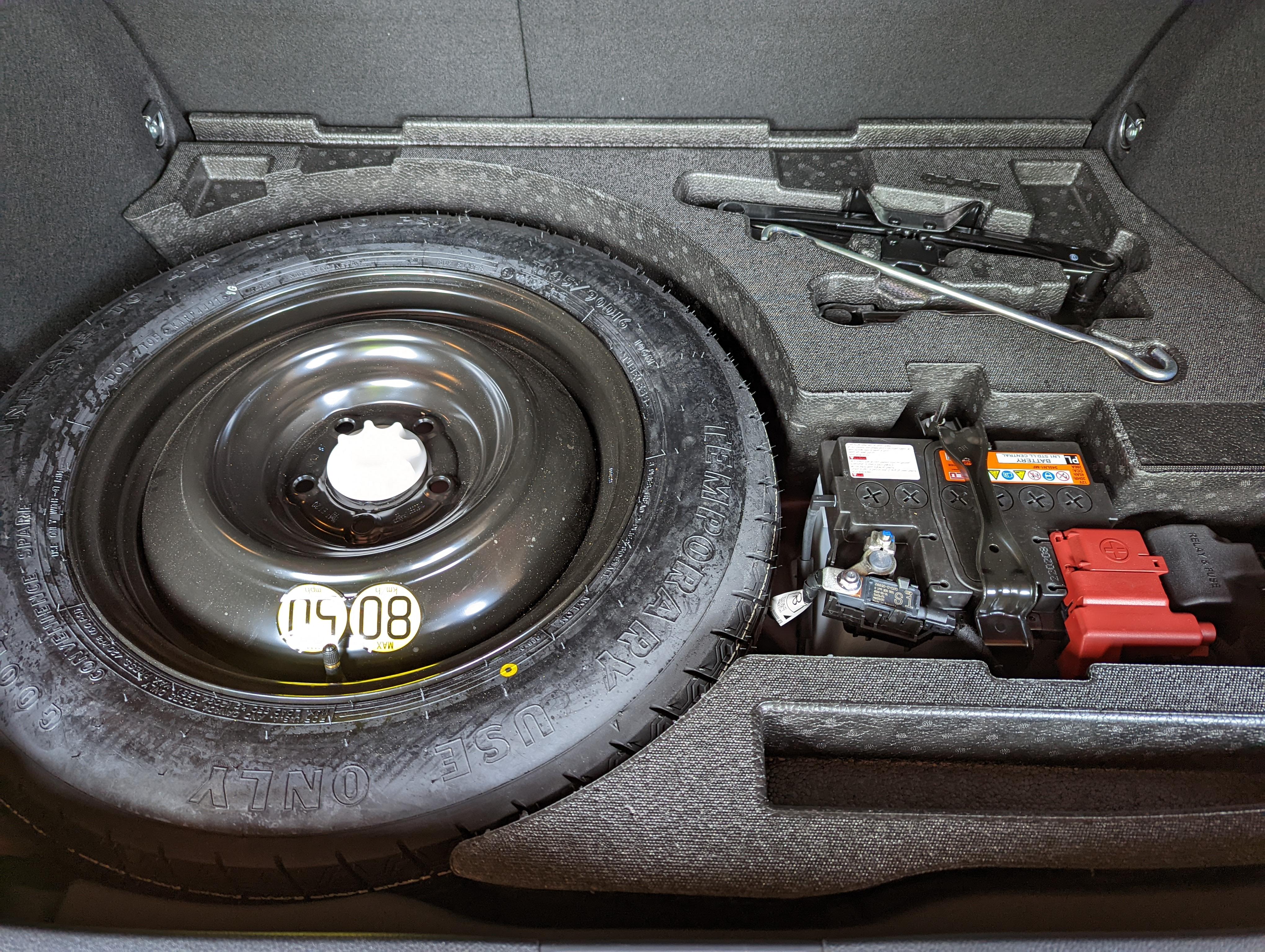

Well I've had a productive hour, Toyota dealer called me to say the spare wheel parts where all finally in so I popped down there to collect them, then went home & fitted it.
Lee, what size wheel and tyre is it? And do you have the part numbers please?

It's a T145/90 D16 - it's written on the sidewall in the picture posted!  😉

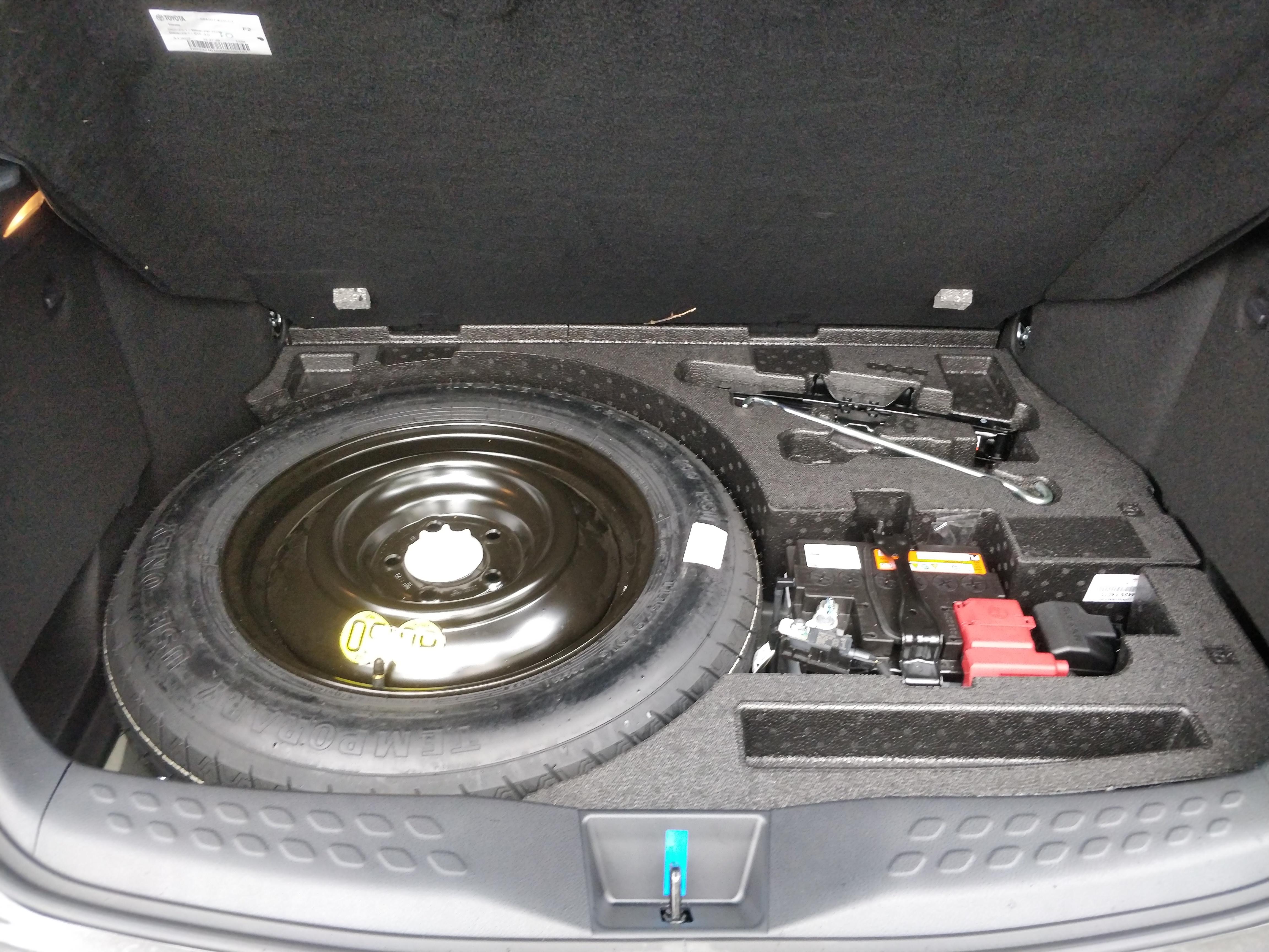

Hi all,
I have eventually managed to procure and fit the spare-wheel kit. My DIY capabilities are nil, so thanks to everyone, especially @alan333, @forkingabout, @Devon Aygo, @Chrisg99
I have left the blue sticker as a sign of thanks to @alan333 who showed the difference between the 2 trims in a picture, aptly demonstrating via the blue tape, explaining the purpose and also mentioned the size of the socket to buy!
With so many conflicting parts numbers quoted by different dealers who seemed less knowledgeable than most members in this thread, I bought all the items that Alan, Lee, and Devon Aygo mentioned in this thread. Bought them via eBay - got a 15% discount via eBay as well. Also asked Toyota eBay store about the increase in jack price, and they let me have one for £12.99 (not sure why it has skyrocketed to £69).

8 hours ago, Spo2 said:
Hi all,
With so many conflicting parts numbers quoted by different dealers who seemed less knowledgeable than most members in this thread, I bought all the items that Alan, Lee, and Devon Aygo mentioned in this thread. Bought them via Ebay - got a 15% discount via Ebay as well. Also asked Toyota Ebay store about the increase in jack price, and they let me have one for £12.99 (not sure why it has skyrocketed to £69).

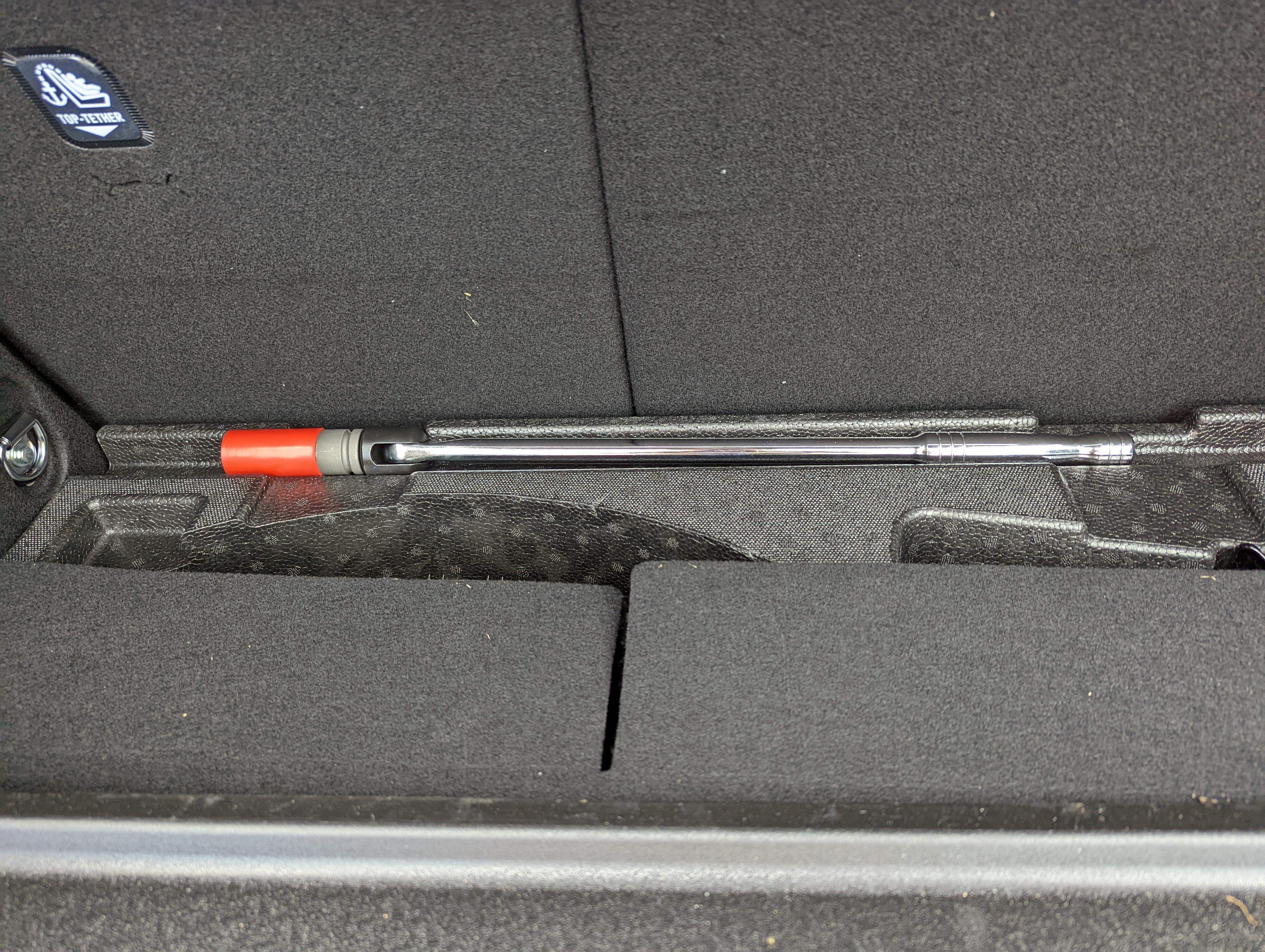

I found the slot in the polystyrene is perfect to store a breaker bar & wheel socket, I hate using manufacturer supplied wheel braces.
That’s where mine lives too!
