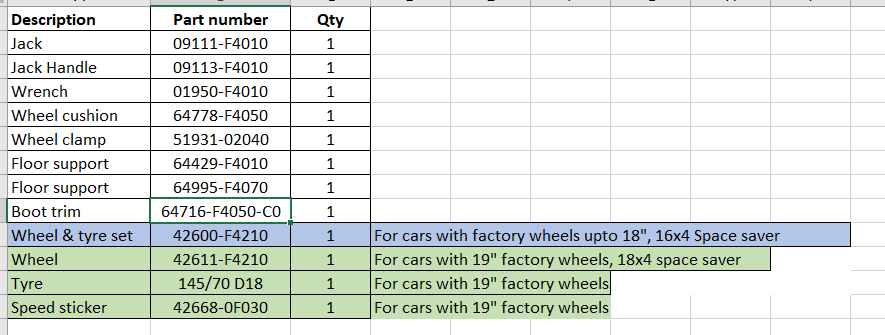

On 1/17/2022 at 10:55 PM, Devon Aygo said:
It can be done it just needs a bit of work to I.D. the parts without using your vehicle details in the part catalogue which is contrary to the teachings of a parts person, as Toyotas parts catalogue works on a one car one part basis where when your cars details are input the catalogue only shows the correct part as supplied from factory and excludes any "incorrect" parts. As for boot space the 2.0 has a 12v battery under the boot floor in the boot, the spare will fit in next to the battery so no boot space above the boot floor is lost in a 1.8 however there is no 12v battery so the boot floor is much lower, fitting as spare in a 1.8 involves lifting the boot floor up to match the 2.0, you need:
42611-F4210 18X4 Space saver wheel £86.35
145/70 D18 Space saver tyre £ TBC Make sure you get a D18 Space saver tyre not a R18 conventional tyre
09111-F4011 Jack £7.25
09113-F4010 Jack handle £1.05
09150-F4010 Wrench £5.18
51931-02040 Wheel retainer £13.35
64778-F4050 Foam insert for floor £5.65
64429-F4010 Foam insert Floor support 1 £22.91
64995-F4070 Foam insert Floor support 2 £11.30
64716-F4050-C0 Trunk trim £7.53
42668-0F030 Speed limit sticker £2.82
Kit above is only for C-HR 2.0 Hybrid with 19" factory wheels

On 3/1/2022 at 10:39 AM, alan333 said:
Hi,
We've just bought a 2021 C-HR 2.0 Excel with the factory 18" dark chrome alloys (and no spare wheel).  I note you say the above is only for the 19" wheels model - any chance you could help me out with what I'd need for ours please?
Thanks 🙂
With 18" wheels you do not need the Green items
Again the list above is for 2.0 Hybrid C-HR only
Thanks very much for that 🙂.  Haven't collected the car yet so have asked the salesman to quote for the kit.  In the meantime I checked eBay for a wheel & tyre.  No listings with part number 42600-F4210, but there are a couple of 16 inch with part number 42600-F4211.  Any idea if they would fit, or what the difference is?  The only 2.0 on the compatibility drop down menu on eBay says 1987cc 109Kw 148HP 3ZR-FAE and says petrol SUV (where the 1.8s say full hybrid SUV).
Thanks for your help, it's appreciated 🙂
I missed a call from the salesman but he left a message saying the kit, supply only, is £328 retail.  I’d like to think I could get a discount on it but it seems expensive.  Adding up the parts from the list above is about £74, so that’s about £250 for the wheel & tyre.
Thoughts?

42600-F4211 is a supersession of F4210 so will be fine, the eBay listing is showing the conventional non hybrid 2.0 available in other markets.
Thanks very much again for your help Lee.  I bought the 9 parts you listed (but with the 16 inch spare now being a updated part number of 42600-F4211), all in for £258 odds inc vat.  All fitted and looking great.
