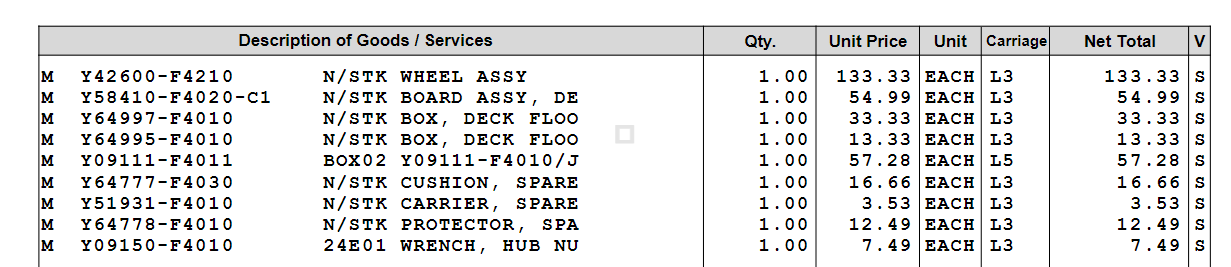

To make thing more confusing, my local Toyota dealer came up with those in the attached pic. Can somebody confirm that the Design trim uses the same parts as all other trims of 2-litre C-HR?

If you look at the list Stoneacre sent me, you will notice that some of your part numbers appear under the different models. Really confusing.

It seems they follow the same manual. Toyota on eBay recommended me the same and then I had to return all. I think I am going to ask just to provide the items with the part number that I mention.

I don’t think the floor/boot layout will be different from a MY2021 to a MY2022, nor do I think it would be any different from spec to spec.
You’ll have to take a punt one way or the other tho… do you choose to go with the dealer's parts list, and if the parts don’t fit they can take them back?  Or do you choose parts that have been shown to fit a 2.0, and risk that the boot setup is the same as ours? (btw we have two 2.0 2021 C-HR's, one with JBL [and therefore a subwoofer in the boot] and one without).
It's your call.

Alan, thanks. Definitely not going by what the dealer proposed. Those were the ones recommended by Toyota eBay store- they did not fit and I had to return them. I am going to specifically ask for the part numbers that you have mentioned. Those that you have mentioned, they do fit your C-HR without the JBL? Right? If they do, then they should fit my Design vehicle too which is without JBL. Also would prefer to buy from a local dealer as I can go and return. Returning whole of the order to Toyota eBay was a bit hard!

Yes the parts fit both cars.  (I only mentioned the JBL because it's the only reason I can think of which might cause the boot to be different).
